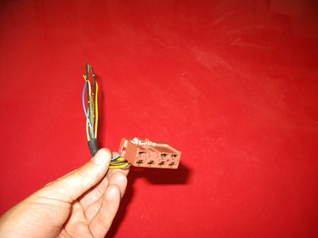

This is optional but to keep the wiring stock and make this process easily reversible, I went to the junkyard and cut a main relay harness. I then de-pinned the black wire to use for my kill switch so I could tuck my original black wire away.

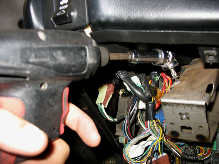

This is your main relay and is exactly the same for all 94-01 Integras and 92-95 Civics and Del Sols. You can remove the 10mm bolt and unplug the harness using a flat blade screwdriver.

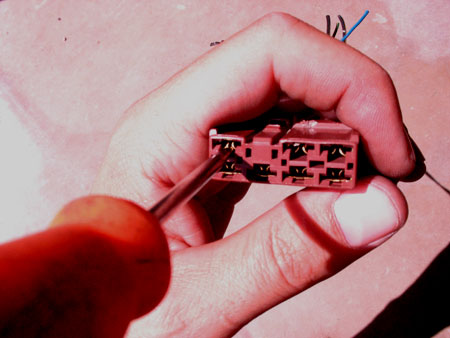

Push the clips in on each side.

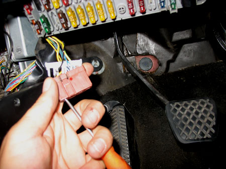

Pry the white clip up but don't completely remove it. You just need to free the black wire.

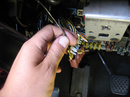

There's a little tab inside that you'll need to flatten down with a straight pick. Press on it while pulling on the wire.
