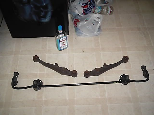

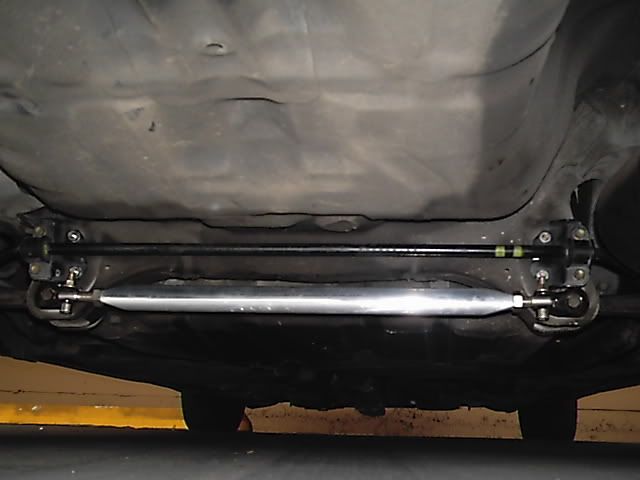

#174856 i put one on my ej1, should be the same for a hatch
they say you should use a subframe brace for anything heavier than 14mm.
LS is 13mm.
what you need:
civic lca vs integra lca:

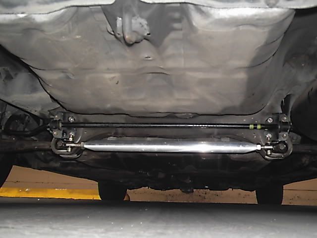

finished:
By suspendedHatch
#175086 If you change from LS to GSR, just make sure you get the bar and the end links. There are two types of end links and some inconsistency between which style each bar uses.
