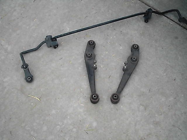

#101531 well i found 2 rear sways off a integra ls got one for me and one for hatchie....anyhow I am wondering what lower control arm (rear) to use with this bar i heard the integra will stress the suspension but not too sure on that and i am not really in the position to get aftermarket ones did a civic ex or si come with a rear sway i have 1 in my local yard i can snag the lowers tomarrow if need be but would like to know either way anyhow.

#101534 The EX 4dr came with a rear sway bar and the control arms from those have the holes for a sway bar

#101689 i used 3rd gen integra rear control arms and sway bar

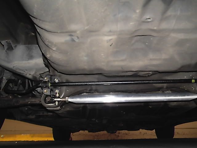

bigger than 19mm sway bars have been known to tear the subframe so you need to us a subframe brace (ASR) if you use a 22mm.
