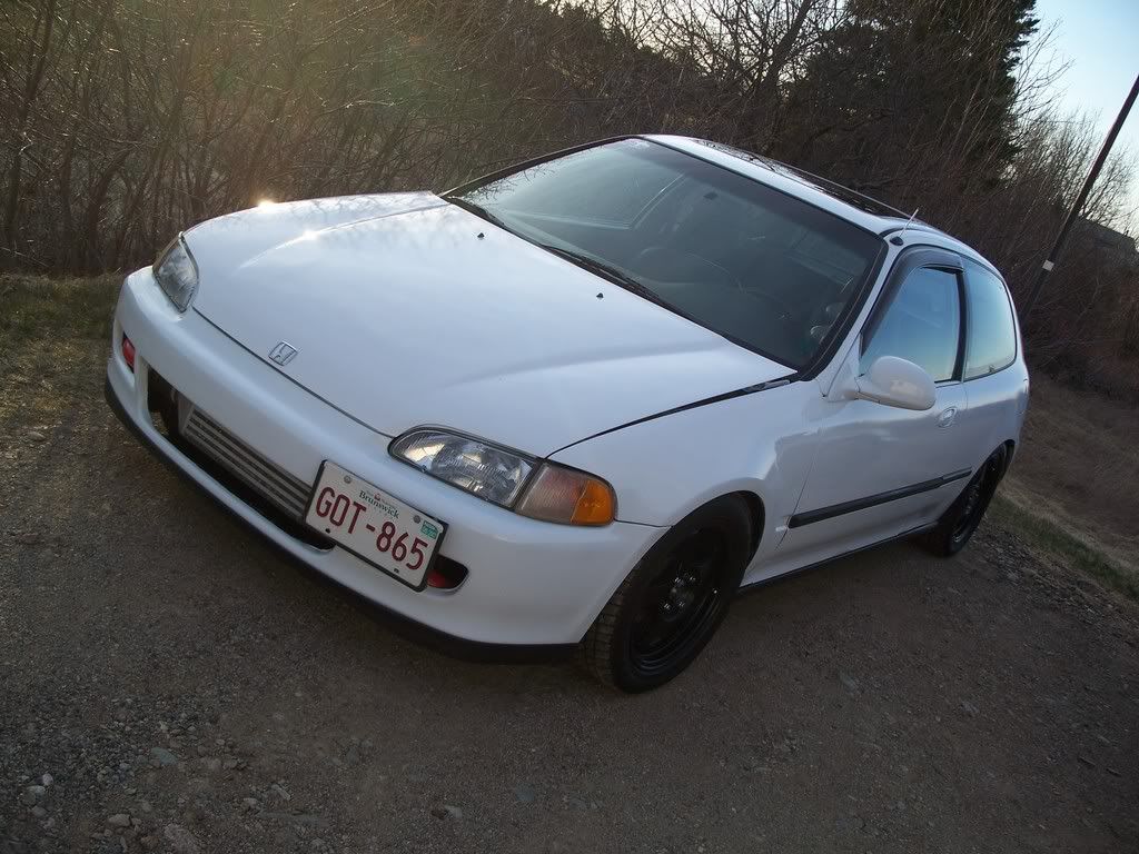

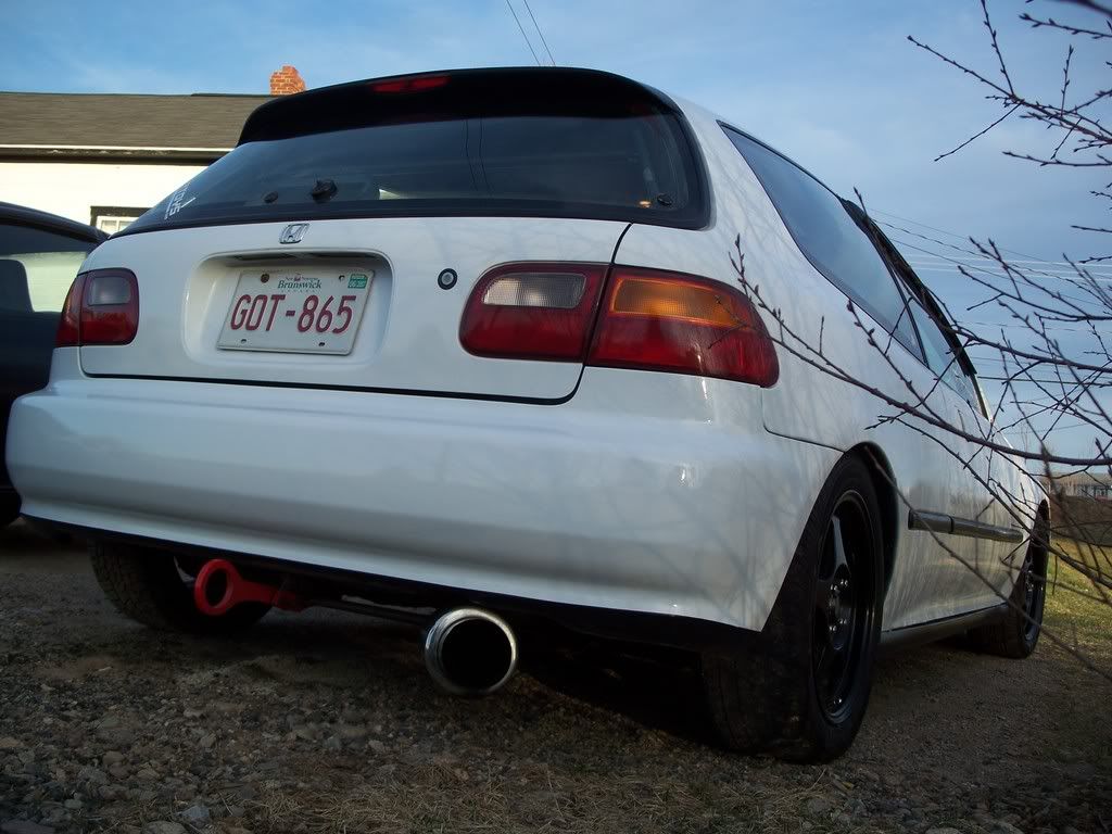

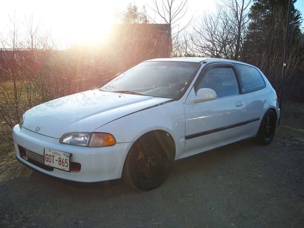

#6528 got bored and took some pics
#6529 one word, HOT!
Nice one buddy, exhaust looks huge!
