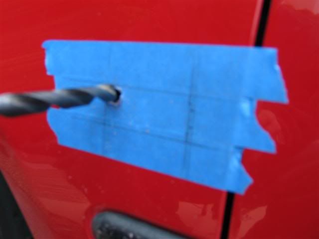

first layout the template that can be found on many forums.make sure you have it level and not crooked

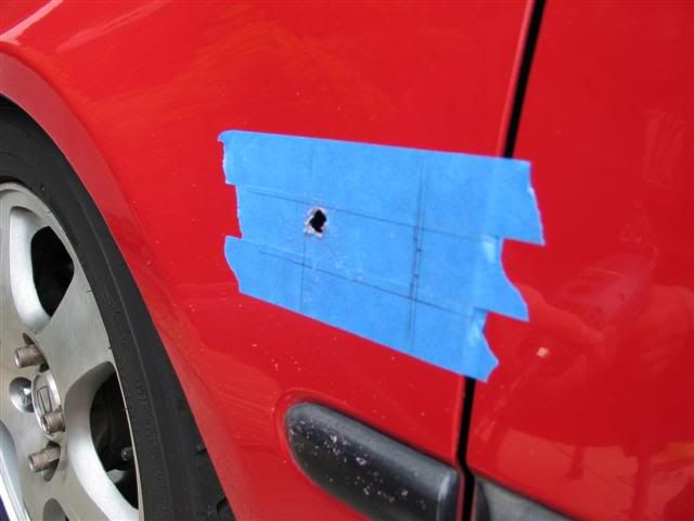

next you will need to cut it out of the fender. i used this simple tool to do so.i went threw maybe 4-5 cut off discs during the whole thing.

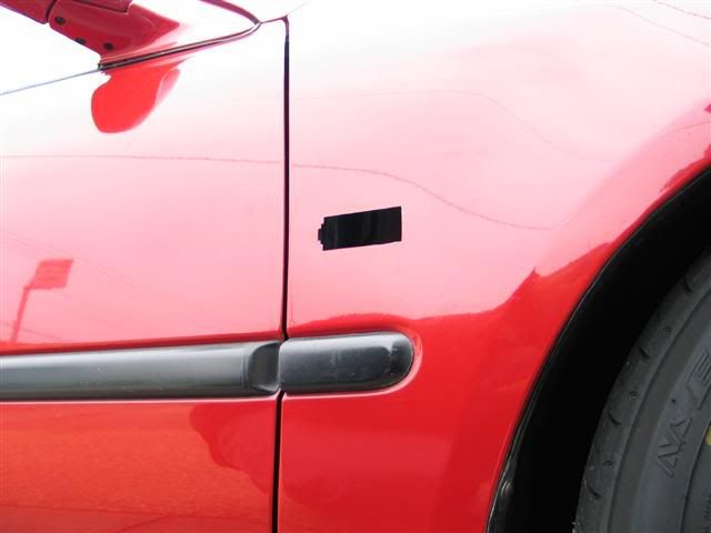

next you have it cutout so it should look something like this
now once its cut out you need to make it a little bigger in some spots the template is not perfect. i gradually opened the hole where needed till it fit.

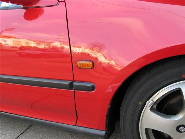

this is what it should look like after when installled
