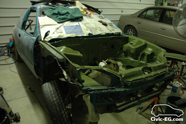

I had my motor out and my car needed a paint job, so I decided to put the time into a wire tuck and shave my engine bay.
A wire tuck is just cleaning up all the clutter in your engine bay.
Shaving your engine bay involves welding in all the open holes (there are alot more showing after a wire tuck) and then smoothing everything out to make it look seamless.
First thing to decide is how far you want to go. You can hide some wires, or go all out and hide everything! I went all out cause I was bored.
I'm almost done with this project, so this thread will grow as I finish everything up...
First remove everything in your engine bay.
If you are going the shaved route, you must weld in every hole that you won't need anymore.
I used a 115v MIG. You'll want to grind off the paint before you weld. Then grind down your weld flush with the area around it. Cover your glass so the sparks do not pit it. Be carefull welding near your fuel lines as well.

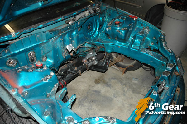

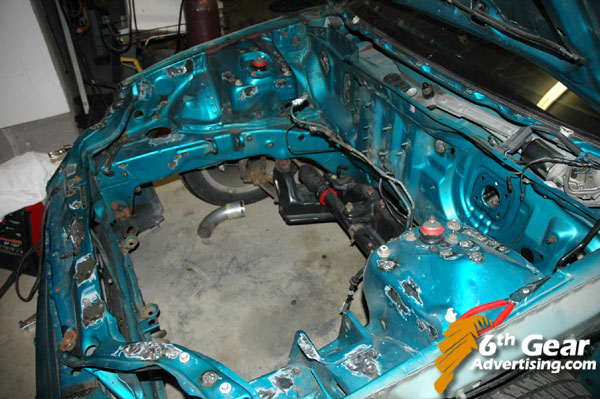

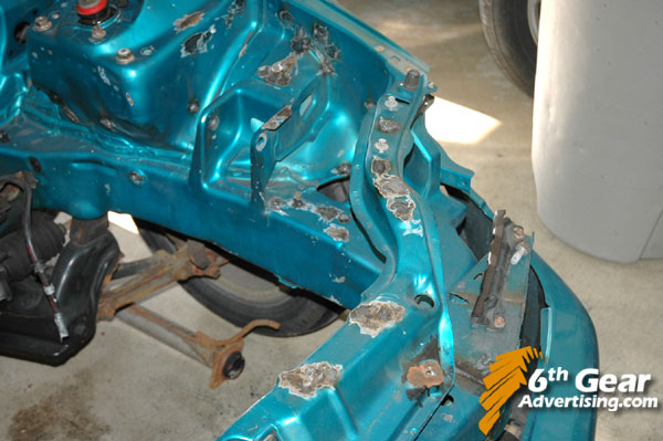

All the welding & grinding takes forever...
for the bigger holes where the battery & fuse box were, you'll have to cut a patch out of sheet metal & weld it in.

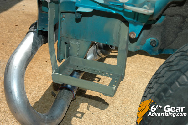

Here's my new "light weight" battery & tray I made
Tray installed (where washer fluid tank once was). The tray was a little heavy so I drilled those holes in it to make it a little lighter.
