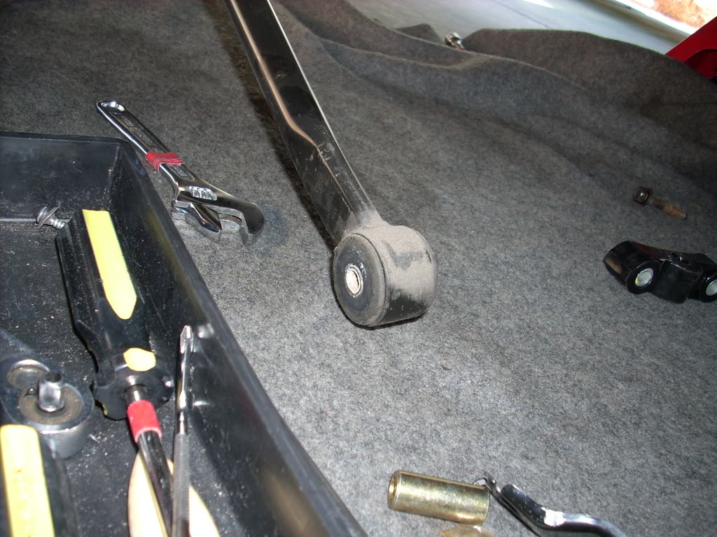

I started with the rear armlike bushing first. Remove the two bolts and slide the bushing off of its arm. The bracket, bolts, and the little spacers inside the old bushing need to be reused.
Old and New. See those spacers I was talking about. They slide right out with a flat tip.
Reinstall in the reverse order. I used lube that came with my master kit, I dont know if it will do anything but hey why not.
Your working on the outter arm only dont forget. Just remove the bolt and it will drop out.
I used a saw to remove the old one.
You can see the two pieces used, there is also an spacer that is supplied that you put through the center. No reusing the old crap here.
They slide right in, perfect fit. No press needed.
Again I lubed them around the outside, inside and inbetween (two parts) . Again who knows if it will make a difference but they supplied the grease, why not
Rebolt and your done
