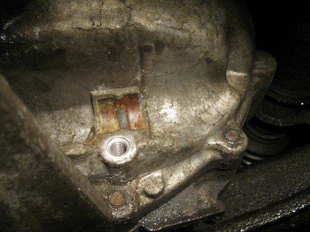

Here we can see the bare transmission shift shaft. I put a smear of grease before I put the cable back on.

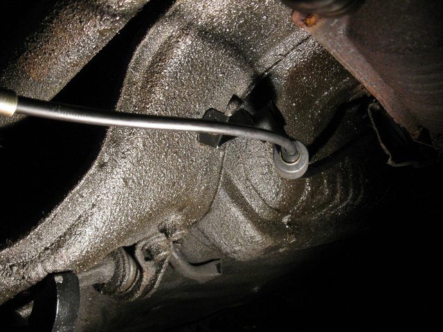

Here is the nice new cable installed and the holes lined up.
The transmission has a specially shaped pocket to accept the shift cable, so place it there.

The manual says not to bend the cable, but the cable cannot be installed without it snaking around like this:
I'm assuming they meant don't fold it in half.

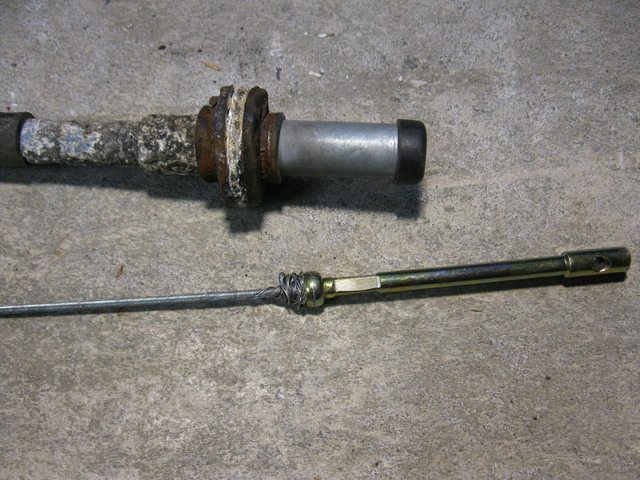

I performed a 'cable autopsy' after since I was curious as to what happened. The actual cable is just a thin wire covered in three or four layers of sheaths so it doesn't buckle. There was no rust at all inside the cable, so the sheath seems to have worn out simply due to age and fatigue. Once it broke, that led to the hard shifting as it clogged up the tube and then it bunched up near the end which made it hard to get into park. Finally, it bound so tightly that when I tried to shift, the wire snapped like you can see.

I got a new shift cable from a supplier here. The 92-95 cables are really hard to come by and nobody has them in stock. No matter, because the 96-00 cable is exactly the same! Here is the only difference I could see between the old cable (right) and the new (left):
Everything else is identical.
