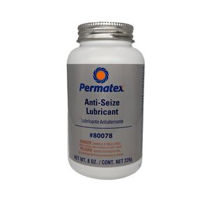

torque everything properly
and this stuff is your friend
