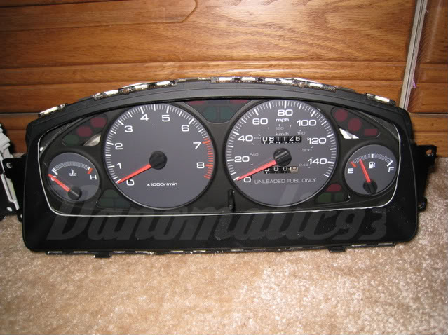

This is a detailed DIY for installing a 94-01 Integra Cluster into a 92-95 Civic. You are more that welcome to use this as a guideline as there are many ways of displaying the cluster.

94-01 Integra Cluster with Pigtails (I used a 94-97 Cluster)

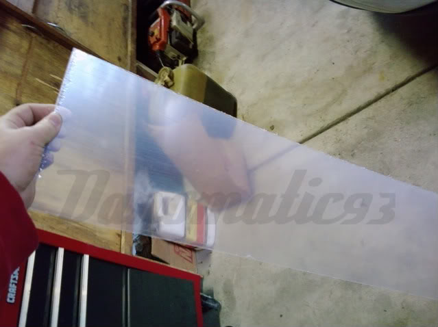

Acrylic (Plexiglas)

Civic Cluster Bezel Preparation:
Let’s start by getting the Civic Cluster Bezel ready. I wanted the have a clean stock feel with these gauges, so I wanted to use a stock bezel (well, really just the frame of it.).
1. Remove the Bezel from the donor Cluster. 5 tabs, use ‘em.

Acrylic (Plexiglas)
