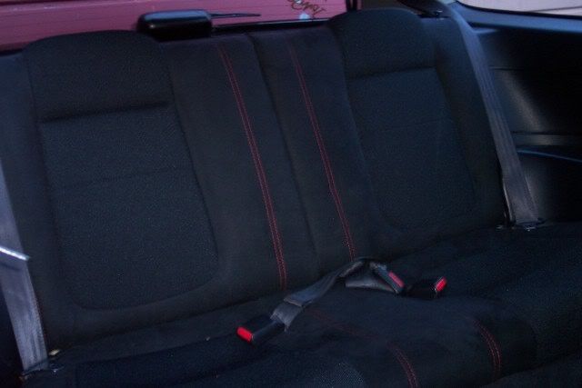

#40528 Ive got them in mine, no gaps
The upright part slots straight in, the bottom part i seperated the fabric from the foam part on both benches and swapped the ITR fabric onto my civic foam
The material is quite stretched but looks a lot better than standard anyway, and there no gaps at all
Sometime i might take the material off and get a new panel sewn in so that it fits the foam better, but i rarely have people in the back and it looks fine as is, ill get some photos if you want?
#40548 They will fit. it just takes some work.. they will leave gaps on either side about an inch or so.
Here are some pics of my GSR rear seats in my hatch. They are just like the ITR seats, just not as cool looking.

Mine are out of a 94 GSR hince the cloth. But any 94-01 integra. 2 door. You just have to bend the metal tabs that fit into the slots to make it sit back up against the rear upright seat backs.

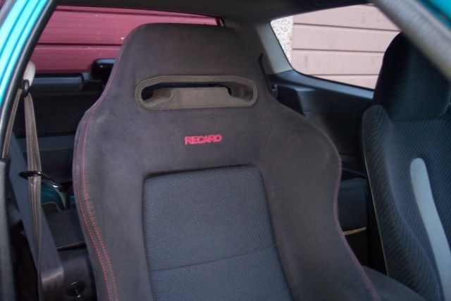

#41382 yep, thats the way they have been now for about a year. Those wont change. The front seats will though. One day I will get JDM DC2 Recaros.

Greasedmonkey & Graham, both of your cars are sick, thanks for the pics, its crazy that you both have sweet rear seats and teal eg's i like i like a lot
