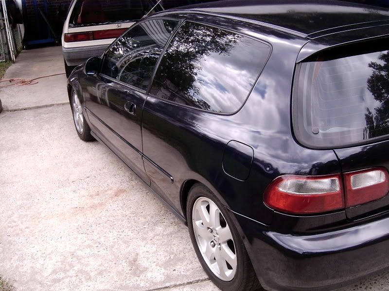

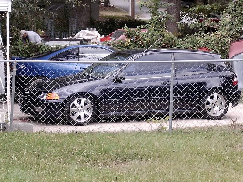

By Jonpr360
#564 Image
Interior:
GSR leather seats
jvc CD player
Alpine amp
Alpine 12" woofer
Exterior:
si wheels (that will be polished soon, thanks to this site)
falken tires
amber corners
jdm style headlights (with city lights)
jdm yellow fog lights
half clear half red tails
Suspension:
skunk 2 pro series full coilovers
skunk 2 front and back camber kits
skunk 2 front and back strut tower bars
skunk 2 rear lower tie bar
Motor:
nothing, thats why there arent any pics of it! lol
well let me know what you guys think..holla! [/img]
#567 thats one clean EG 8) Tell me more about those headlights... Did you take them apart and paint the inside black? Or did you buy them like that?
And how dark is that window tint? There's no way you could avoid getting a ticket for that tint in Ohio lol.

#570 that thing is freesshhh!!!! prolly one of the cleanest hatches in this site.
#571 What's going on with the EF in the garage? I see 1 racing seat.... your track car?

#590 cleeeaaaaaan!!!
where did you get your headlights at?

#597 where in the world did you get those rear ones from? All i can find are the altezza ones. :(

#602 Thanks for all the compliments...
the headlights, i actually bought them like that from a friend...ill find out where he got em..
thats actually my buddy's car...its track/street car...its fully gutted and has a fully built b18...he took out a 05 350z turbo on friday night...wish i had a camera...
i dont know if the pic is making it darker, but its actually 25 in the back and 32 in the front, so its legal here in GA...and they are a little purple..gotta redo them..

#863 find out bout those headlights i want them to. ur car is realll clean wish my paint was that good. u need a front lip and it would look that much better. keep up the good work
#870 I've heard of people taking their headlights apart and painting part of the inside chrome trim to get that exact look. I've taken 96+ headlights apart and painted the inside black, but never EG lights. Probably the same concept though... Get the lights warm with oven or heat gun and the adhesive that holds the front on gets soft. Then you can remove the front and get to the inside to take the piece out, pask it off, and paint.
By Ex-Cvic
#1503 Nice EG. looks clean! As for the headlights its a DIY type of this as posted above , i did it to my car , just took them off put them in the oven to bake @ 350 degress for 5 mins NO MORE than That to be on the safe side, as soon as you take them out be careful they will be HOTT you will need mittens and maybe a flathead screw driver , you just pull the glass from the plastic and let it cool on its own, I made the mistake of putting the glass in water and it broke into two. and to paint it just mask the center of the headlight area and paint around it , ive seen people paint the whole thing lol i suggest to use krylon fusion its works great , after the paint is done, with a heat gun or hair dryer activate the glue that is left on the joined areas till warm and put them together again and put the little clips back on the headlights and put some clear sealent all around the headlight to avoid water getting in...and thats it..
PS. ive noticed that the ligh shines brighter by taking off the small metal piece that goes around the lighbulb inside......

#1556 I like those stock rims dude

eg_madness wrote:I like those stock rims dude
which honda come this rims from??
