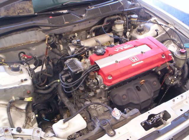

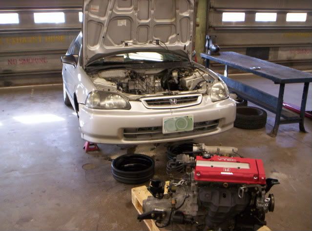

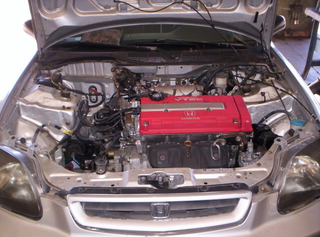

#148988 more pics of the type r swap me and a buddy did. 8)
with the poopy intake i gave him till he gets an ITR airbox :lol:
:thumb:
still need to hook a couple things up whilst he waits for his WS2 exhaust

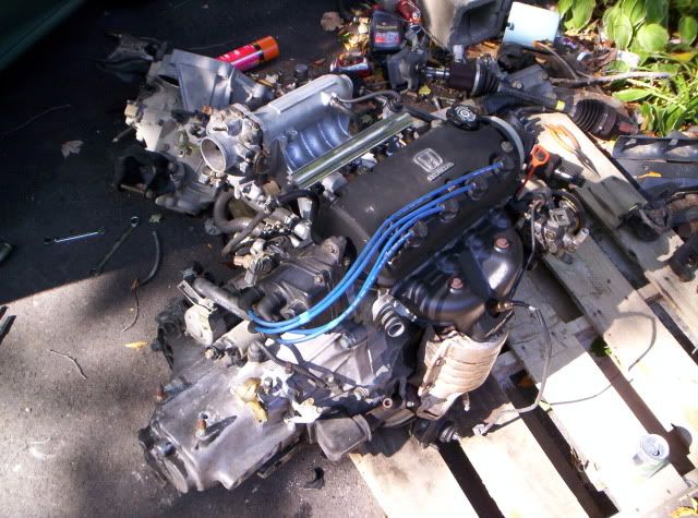

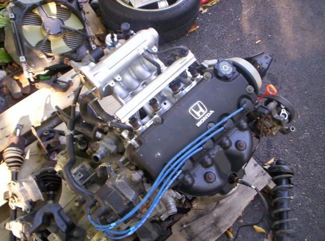

#149038 UPDATE:

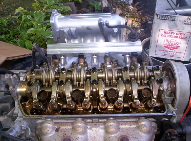

Worked on the d16 a little today. Put on my OBD1 dizzy, put on a newer valve cover, and painted my heat shield black
the freshness of 82k

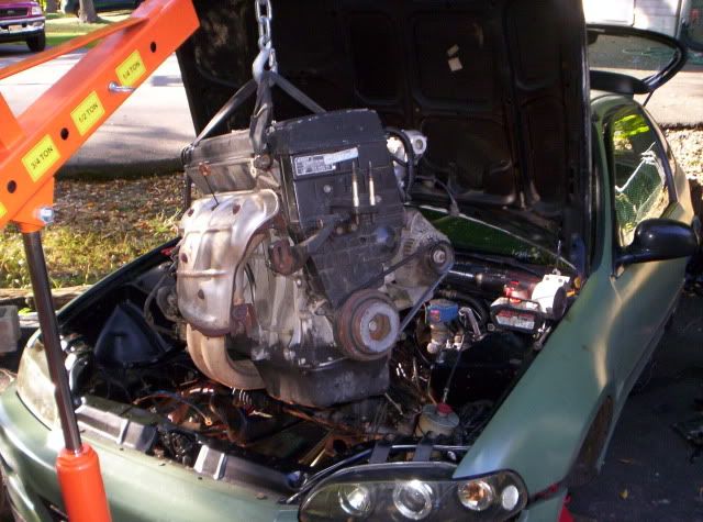

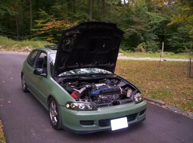

#150213 :woot: :woot: :woot:

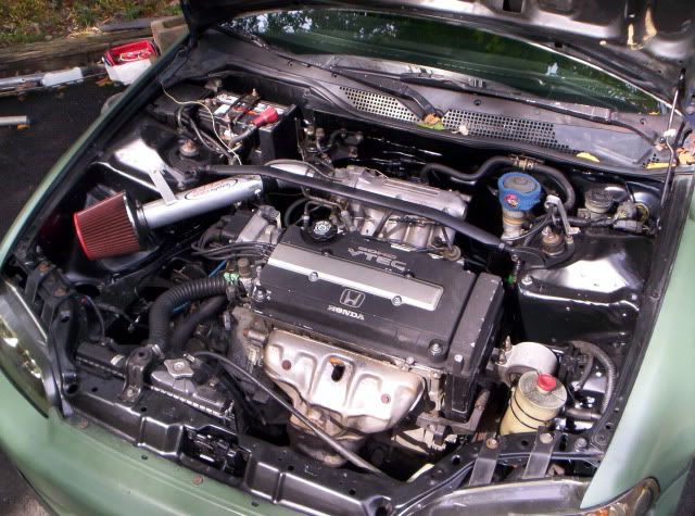

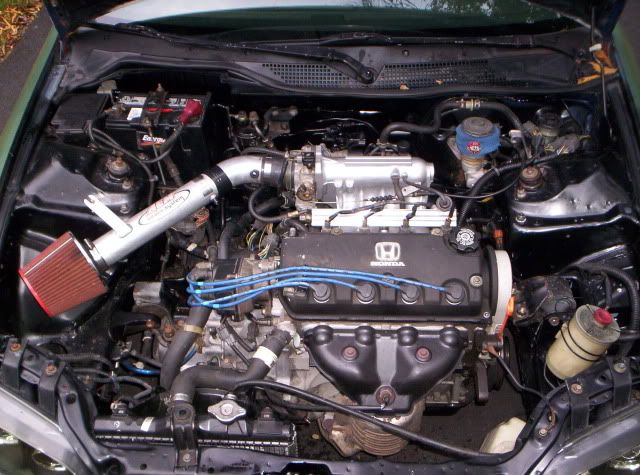

Just finished my D16y7 swap and it runs awesome!
No longer at 3500Rpm at 65 anymore with the B16.
Im just below 2500 with my EX tranny :thumb:
Hello highway cruising 8)
Im probably gonna hate it in a month or so cause its SOOOO damn slow, even compared to the stock B16, which isnt THAT fast, its quick.
So, heres the complete build of the motor im running now.
D16y7 block and head 82k miles
D16z6 intake manifold
D16z6 Throttle body
D16z6 water tube in the back, it has an extra port i needed
D16z6 Si/EX trans
D16b7 Distributor
:woot:
I'll get some pictorz of the swap a little later on :D

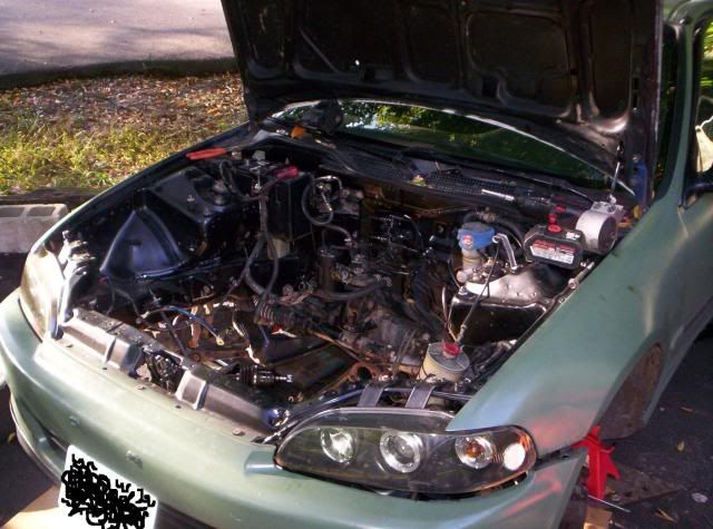

#150329 MORE PICS!!!
the ghettos of my lame ass hometown :lol:
thats it for now. Should have some updates for tomorrow. looking to get some shit done 8)
