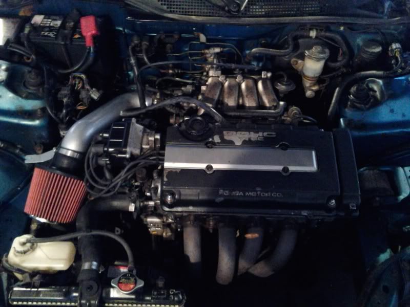

#297402 Oh yea i forgot clapped this on as well and took off that FIDANZA sticker from the spark plug cover..

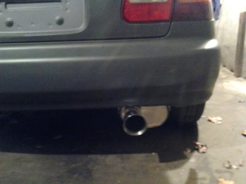

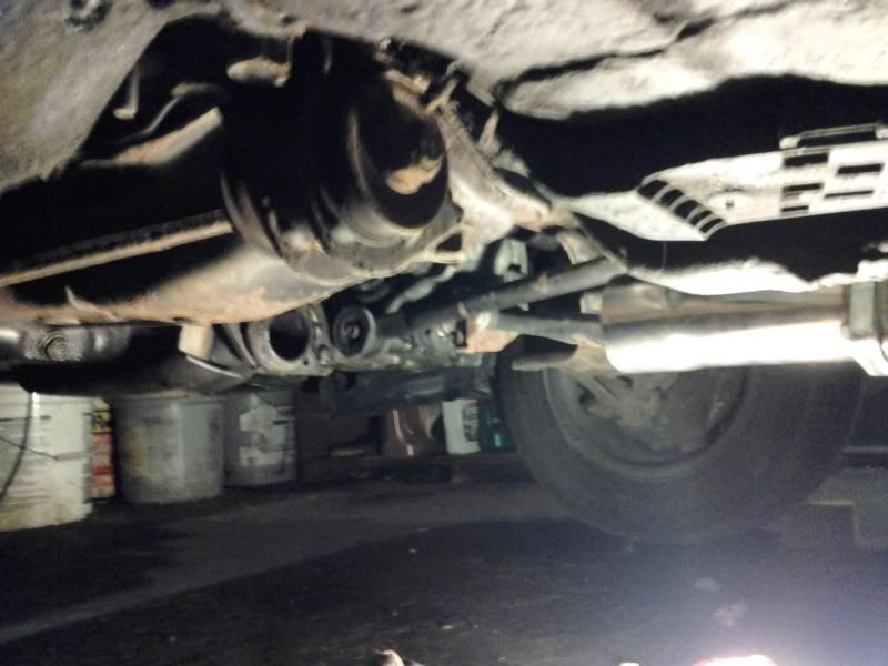

Exhasut went on last night. Only thing missing is the test pipe section.. I have one of thos adjustable 3 piece ones that is 2.5" but of course it didnt fit on the header collector cause the 4-1 one that's on there now is a 2.25" Lol. So i guess now it needs a Header upgrade with a 2.5" collector to use my 3pc test pipe.
:lol:

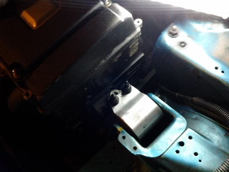

Also since they were there i decided to Fit the Innovative mounts i had on the Single Jinngle. Same fit.
:thumb:

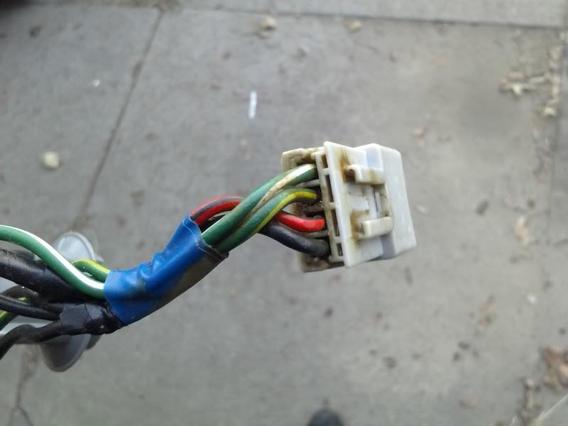

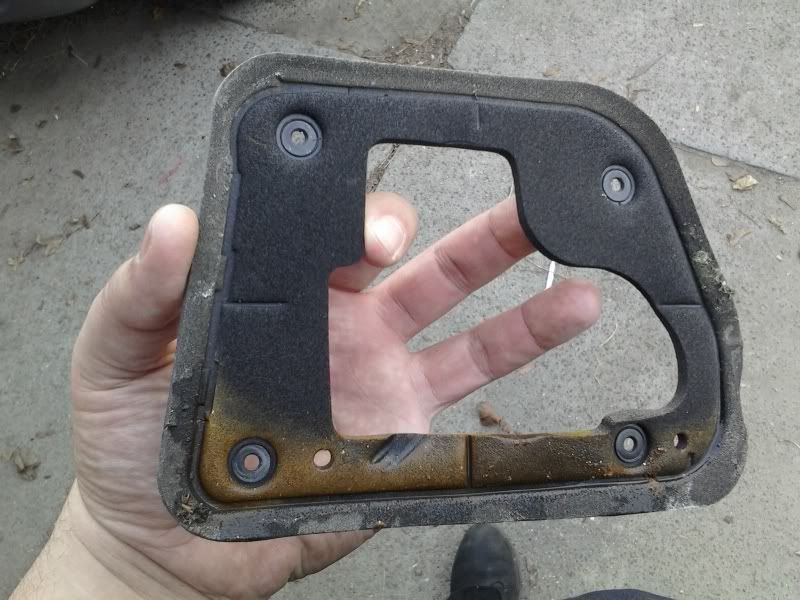

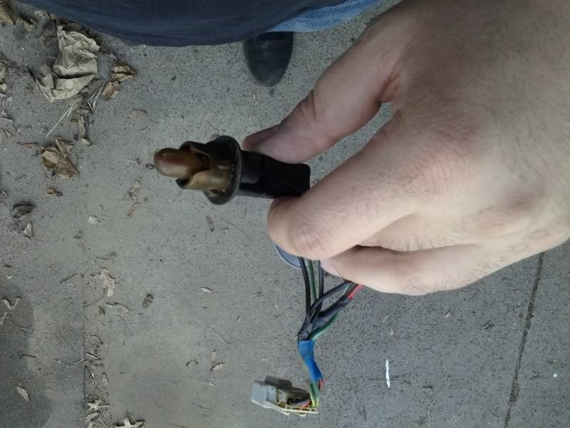

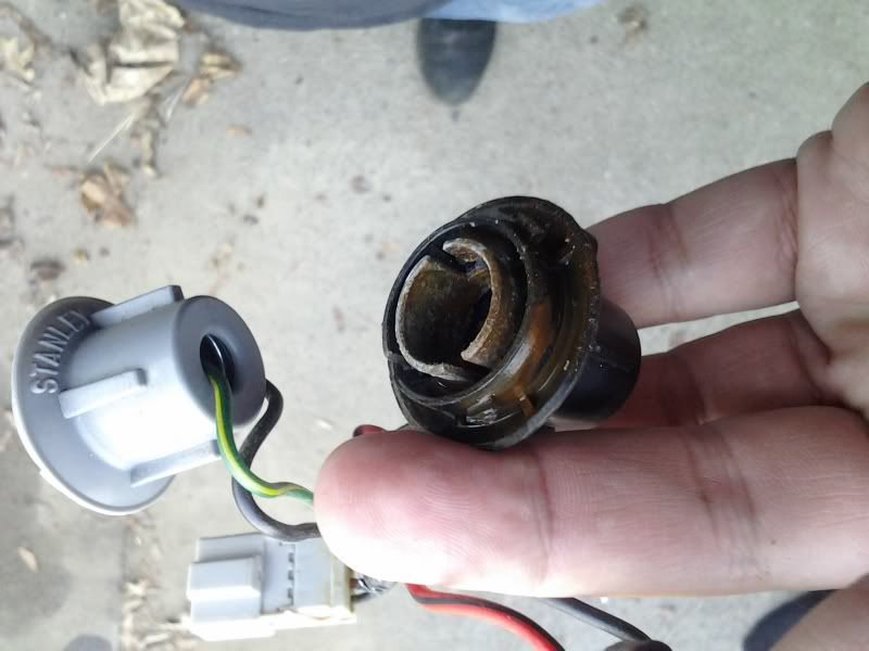

#297857 So the hatch was having a tailight issue. I would hit the brakes and LEFt turn signal would turn on lightly but noticeable. figured it was a wrong bulb somewhere. replaced all bulbs and it still did it. replaced with new and the proper ones.
so upon looking further into the issue i found that my passenger tail light had a fish tank in it. half full of water and the plugs were corroded. that cause the malfuntion. replaced the harness sockets and all good now. !
this is what it looked like. also installed the new tail lights seal gasket.
Squashed there for 20 years. lol..

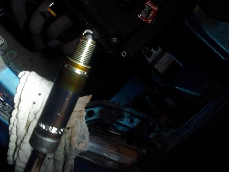

Changed my plugs and this is what i found as well. i was pissed but hey something more to take care of valve cover gasket kit.. and plug tube seals..
they were beyond drenched!
