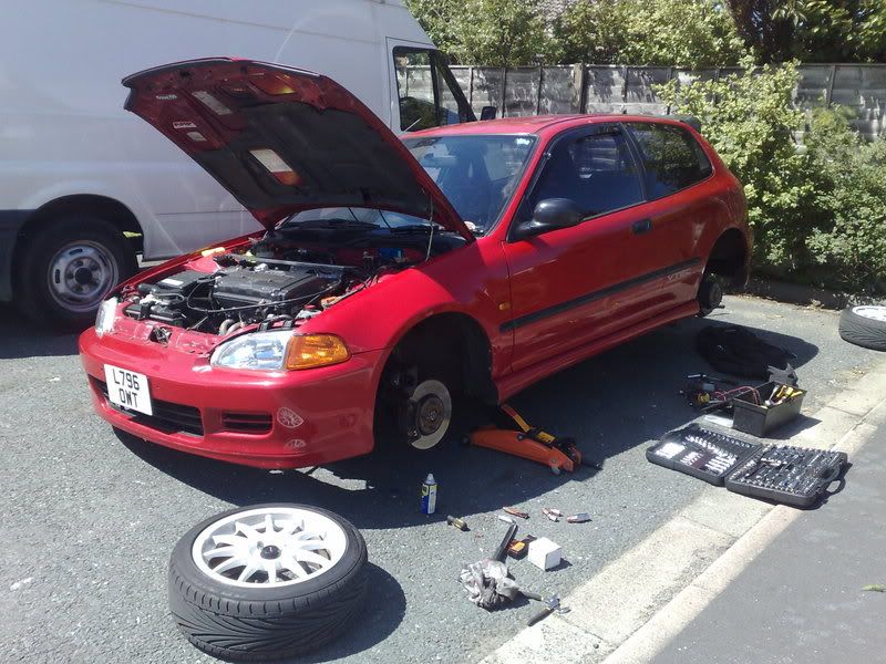

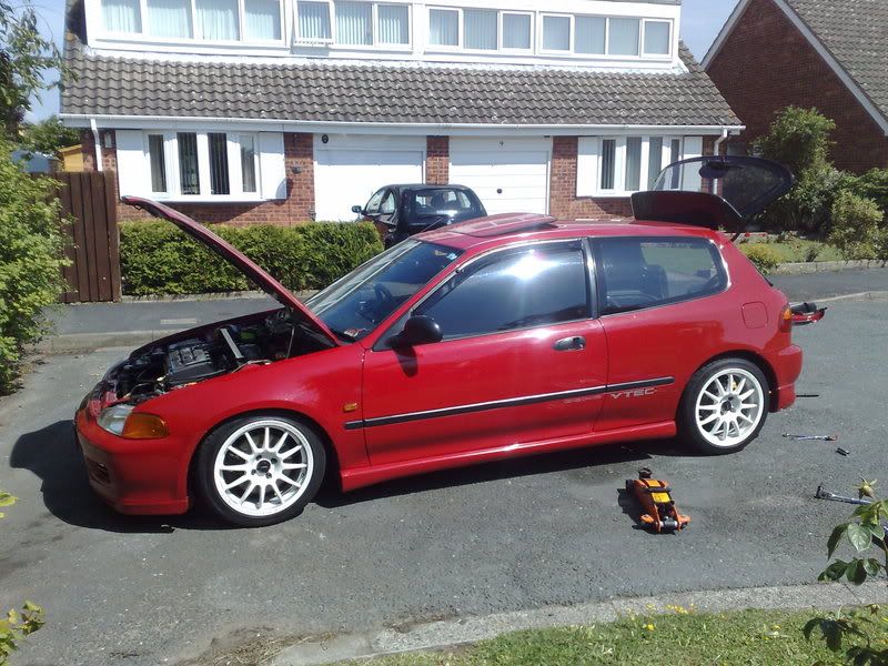

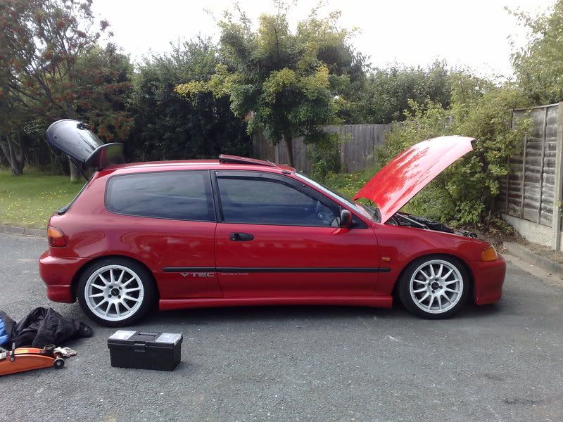

#63453 More progress today :roll:

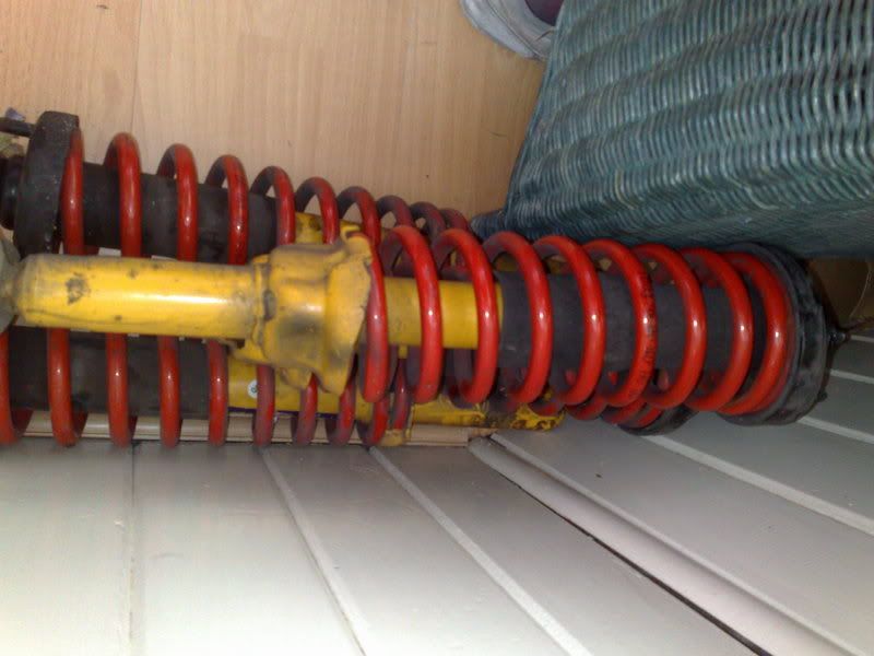

The front of the car was very very low, so not having camber adjusters, the tyres where wearing out too quickly, i considered getting some camber adjusters but i had problems with ground clearance on the standard teg manifold and couldnt jack it up without lifting the front end :shock:
Also, the rear was feeling alittle soft on high speed cornering so i decided to fit some uprated shocks all round and raise the front a tad.
So to start with a pic of the car as it was (ride height wise)

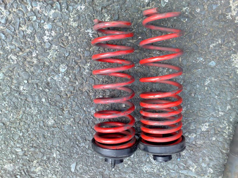

Then i fitted the rear shocks with the 40mm springs....and it was far too high.
Difference in springs

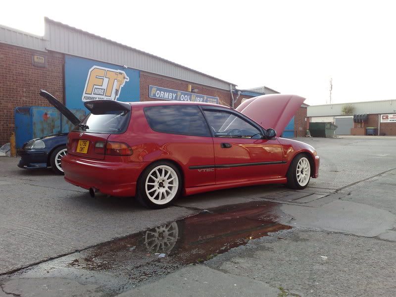

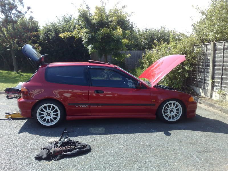

I then fitted the 50mm springs to the shocks at the rear, and raised the front to 40mm to
get the stance i was after, it handles mile better and i still have to fit the 22mm itr rear arb :wink:
Pics of the new stance
I'm also planning a trip to the ring reasonably soon, and a new manifold, and possibly a splitter so the ground clearance is needed anyway :wink:
