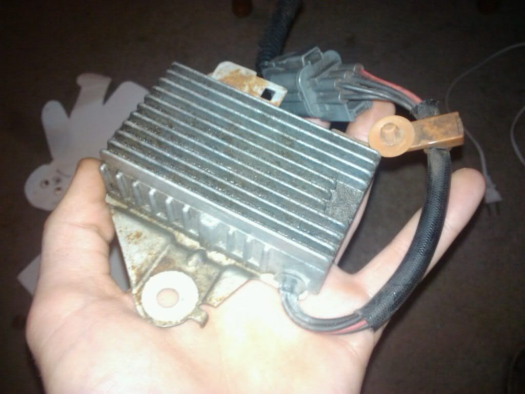

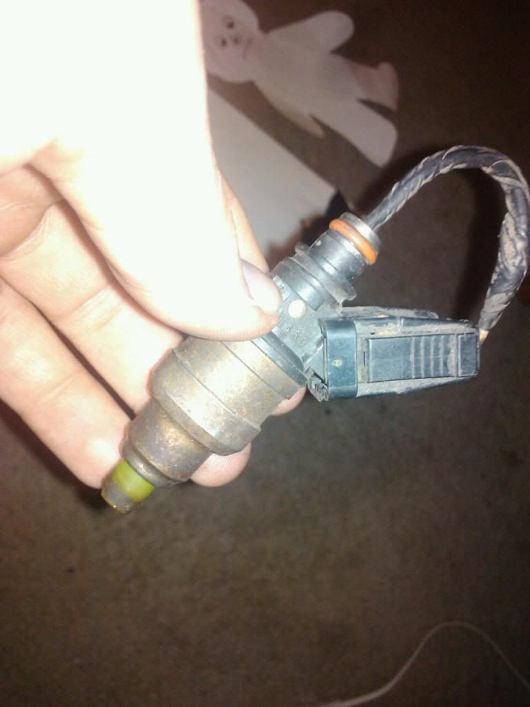

like in the pics i got the 45cc injectors and relay box just need to really go threw tour threads and study them for proper install ( teal ),another thing as for fuel lines what would you recommended?. :? :?

The walbro in your link is a good pump. It will be able to deliver when you decide to turn up the boost (and you will eventually) :thumb:
for fuel management, use a P28 ecu chipped with tuning software. Software chices are Hondata, eCtune, CROME, Neptune... There's a lot out there. Best thing is to talk to the tuner who will be tuning your car and see what software they are comfortable using. Hondata S300 is probably most common among tuners and one of the most friendly to use but it's $599. CROME basic is free but I know tuners who won't touch it because the software kid of sucks.
Stay away from old school FMU's. They are cheap but they are old technology and not reliable. Also stay away from VAFC's and SAFC's - also older technology, better than a FMU but still not as reliable as a chipped ECU and proper tuning. :thumb:
I think I paid $50 to get a turbo balanced.
THere's a write-up or two in the DIY list for installing Resistor box when running the DSM 450cc's.
Your stock fuel lines will be fine for your setup.

#283825 what relay box are you talking about?
i would stay away from resistor boxes and injectors that need them..
my reasoning when i was looking for injectors and it didnt click until one of the guys at the shop told me. running a resistor box and injectors that need them have a great chance on frying your ecu. with that in mind i spent 650 for my S300 and 68mm throttle body. thats 600 bucks i dont wanna spend again. lol
