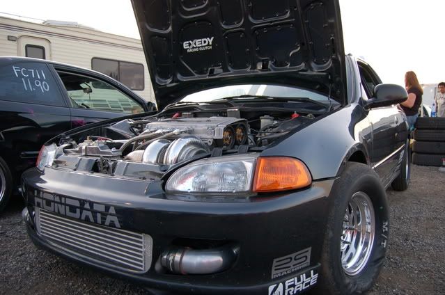

If i was running sfwd and running boost pressure 25-40+ I would not even joke around with a small wastegate. plus the 44 is just a tad more price wise, room to upgrade. Fastest SFWD in north america runs two 44s. he happens to live in utah he ran a 9.36@159mph if he trusts fullrace i trust full race.
