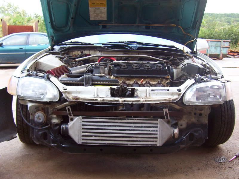

#18618 it is the front bumper support. May have to do with US safety standards, like our side imact bars in the doors. Nice work finding an IC that fit with it, I had to cut half of mine out :x
I've never seen a civic without it. Then there is a piece of styrofoam that goes over the front of it between the bumper.
Nice job on the install!!!!

#18622 Found you an old, bad pic of my car, with the bumper off.
Sorry for hijacking the topic :lol:
#18692 i took mine right off for the install of my innercooler, i think it was held on with 6 14mm bolts.
By stefan
#18750 How do/did you keep the bumper in place under the headlights, without studs?

:? i donno ... i didnt think it was going anywhere!
By sihatch9508
#18773 mmm paper thin front ends.. that cant be safe at all
#18775 yeah, a head on hit and you guys are screwed :(
Stefan, maybe the last owner removed it. I find it hard to believe that a civic in any country would come with nothing at all up front. :shock:
By sihatch9508
#18789 a friend of mine said that hes pretty sure all the overseas EGs came without the bumper support so idk :? doesnt seem very safe at all.

#18869 All EDM EG's came without a bumper support.
All models, so coup?, hatch and 4dr.
I don't know about the lesser EK models, but since a guy on CCH asked for one, I suppose there is one on the EK.
About a head on collision; we are driving Civics.
That means we're screwed anyway, unless it's at very low speeds ;)
