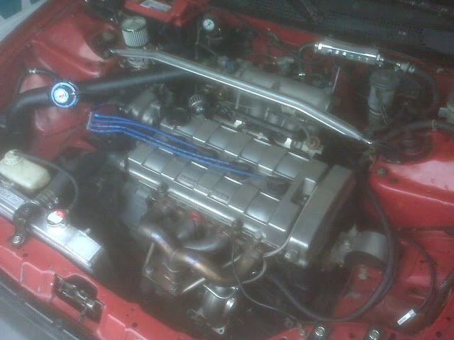

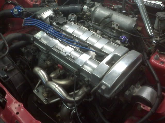

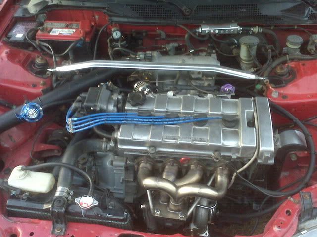

got it up and running. :woot:
its currently running a eCtune basemap for the 440's and fuel pump with boost cut at 5 psi.
gonna try and get it on a dyno in the next few weeks if the weather holds up and doesn't get too cold. if not, more time to mess with little stuff till spring.

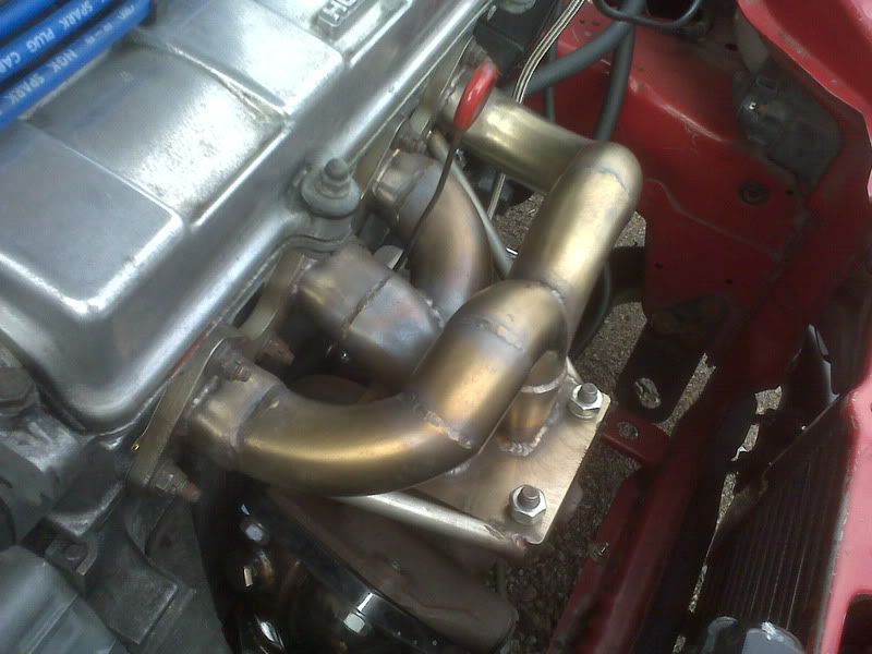

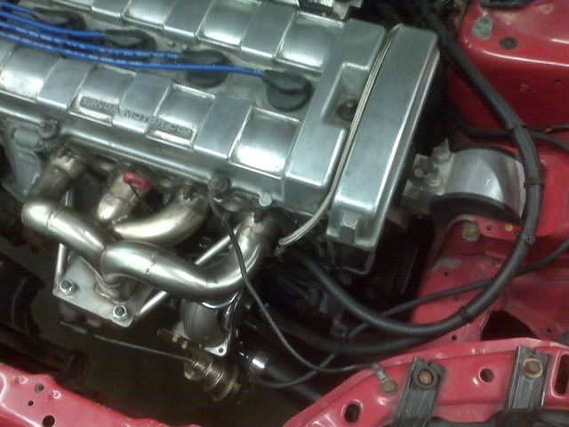

the header i have was made at a shop in dayton called Quik Rev. they seem to do good work and also have a in-house dyno. maybe something to look into...

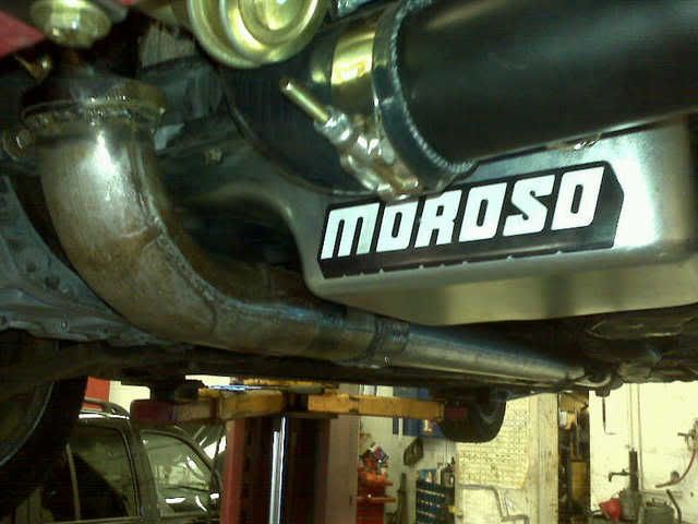

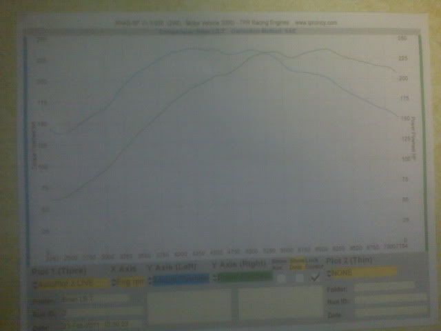

#241178 DYNO RESULTS!
the setup..
-B18b1
-Evo 8 TD05H 16g
-Forge Motorsport internal wastegate
-ProSport MBC
-Precision 440cc injectors
-Walbro 255 fuel pump
-Hondata 4 bar map
-custom twin scroll B Series to Evo header
-3" Downpipe to 3" straight pipe to Apexi World Sport
-TPR catch can kit
-Moroso street/strip oil pan
-Blox oil adapter/sandwich plate
-Greddy rs BOV
-Godspeed FMIC
-Treadstone vacuum block
-Neukin radiator w/ slimfan.com
made 236whp / 238wtq on 11 psi
full boost @ 3600 rpms / max torque @ 4250 rpms :twisted:
