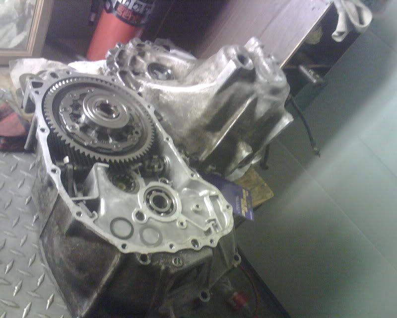

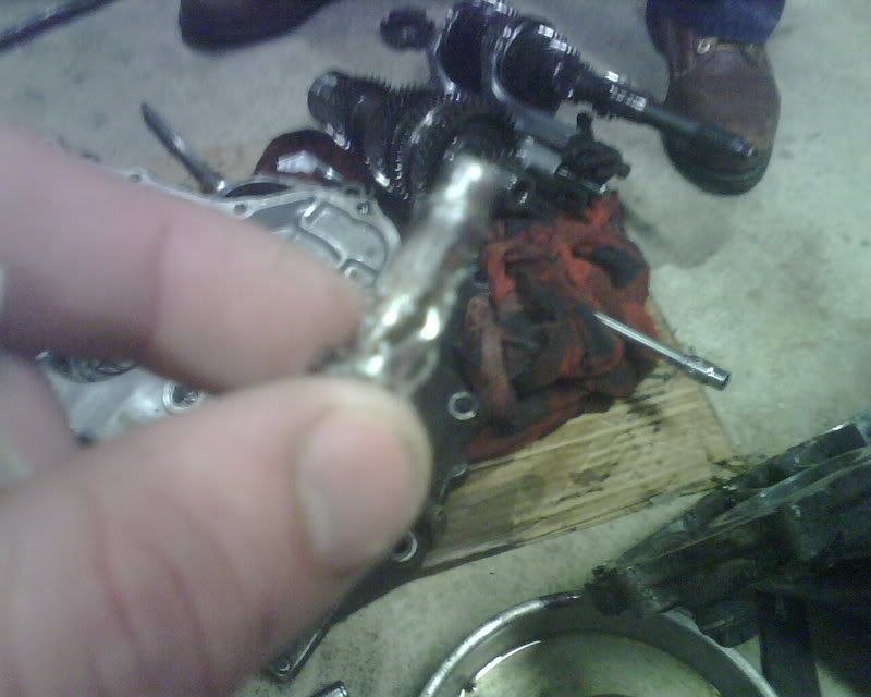

#87334 During the Winter "Storm" we had in Washington in Late December/early Jan where we had tons of snow that we normally don't. I decided to go out and play in the snow. During that I broke something in the Shift Mechanism. I only have first gear. I cant shift into anything else. The shift linkage is good, I broke something inside the transmission. :x

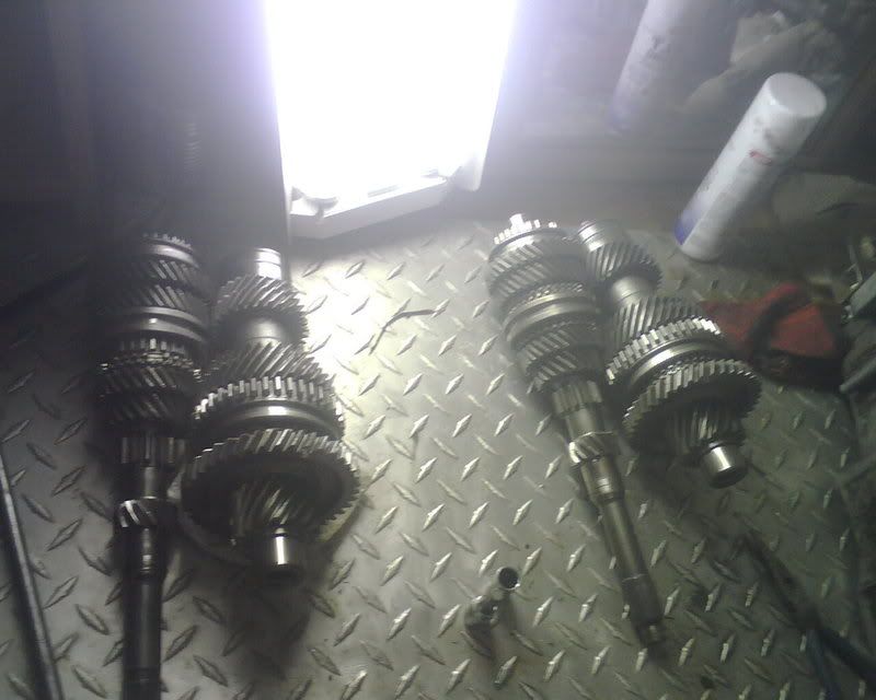

I decided It was time to Rebuild the transmissions I have sitting my Garage for a while. One had a Bad 1st and 2nd. the other had a bad 3rd and 4th. So I swapped the approate gears. and made one good transmission.
Empty Base:

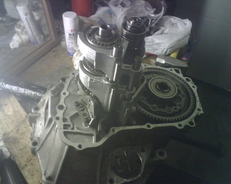

Input shaft and Counter Shaft:
Good Shafts installed:
This is what I believe I broke in my other transmission:
This is basically what the shifter moves and pushed up and pulls down on levers to shift gears. Pretty sure this is whats broken on the other transmission.
I will be putting the other half back on and seal up this transmission, then swap it into my Coupe. I will then crack open the seal on my broken transmission to see what broke. Should be interesting.

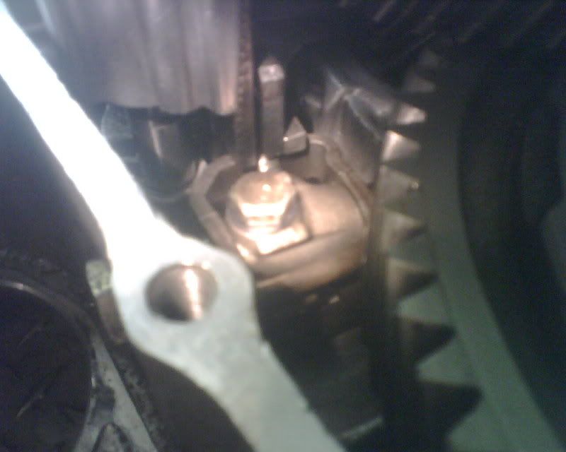

This is what is left of the bolt that broke.
I just put my transmission all back together. However its now leaking oil and
it is causing my clutch to slip when shifting at high RPM's. :thumbdown:

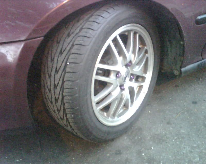

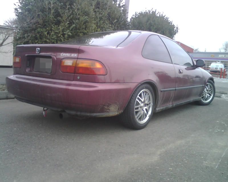

#95167 After fixing my Transmission and before finding out I have rod knock and then parking my car I put my Ls webs wrapped with Toyo Proxie4's back on and took some pics. The car was still dirty from driving in the shitty winter roads and being worked on, you can still see greasy hand prints on the fender. I was going to wash it up and do a full photoshoot then got Rod knock, that kinda pushed those plans back.
Used this one for my Signature.
Purple Lugnuts for the Purple Kush yo!
I will probably take pics when I fix my rod knock.

#95393 haha, i love the purple lugnuts and the purple carabiner hangin from the loop on the rear :hehe:
how bad is the rod knock? un-driveable?
and i havent bothered washing the rig since the wicked snowstorm we had, so no worries there, and how do you like those proxie's? i don't think they do that well in the rain...

Rodknock is just in beginning stage. Just bad bearings at this point. I will be pulling the pan Wednesday and hopefully fixing the bearings, thus fixing knock. Or so I hope anyways. I have been wanting to get an Engine with a Second Cam. If everything goes according to plan, after I get my tax return I will drop in a B, Then put my fixed z6, or atleast z6 head onto my sedan.
Toyo Proxies 4 are my tires of choice. I have gone through 2 sets on my Webs, and have a set on my 15"x8" Quantum teks on my Integra. I get them siped and they work awesome in the Rain, even better on dry pavement. I love the Traction I get out of them. Highly recommended if your in the market for tires.
