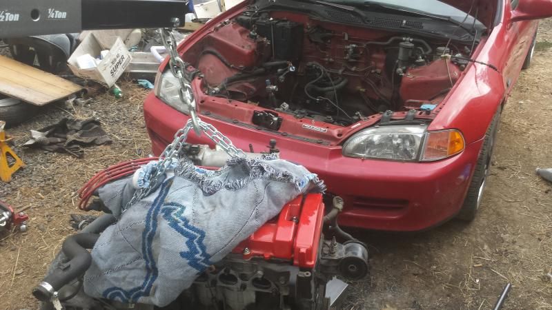

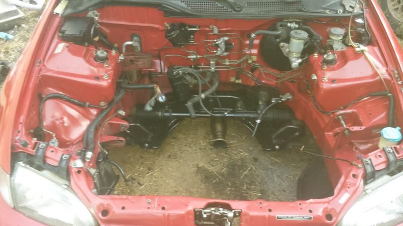

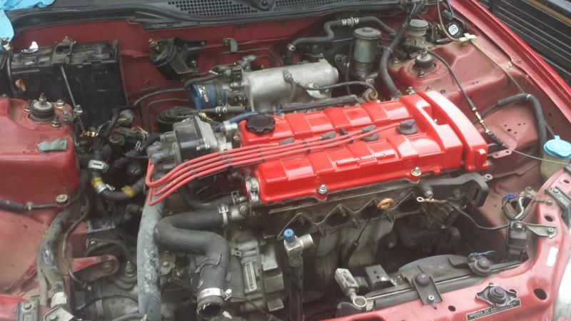

#348761 Goodbye insanely reliable b18b1. Hello to a lot of cleaning lol.
Image Image
By CopyLifted
#348773 Did some cleaning while waiting for the buyer of the swap to show up.

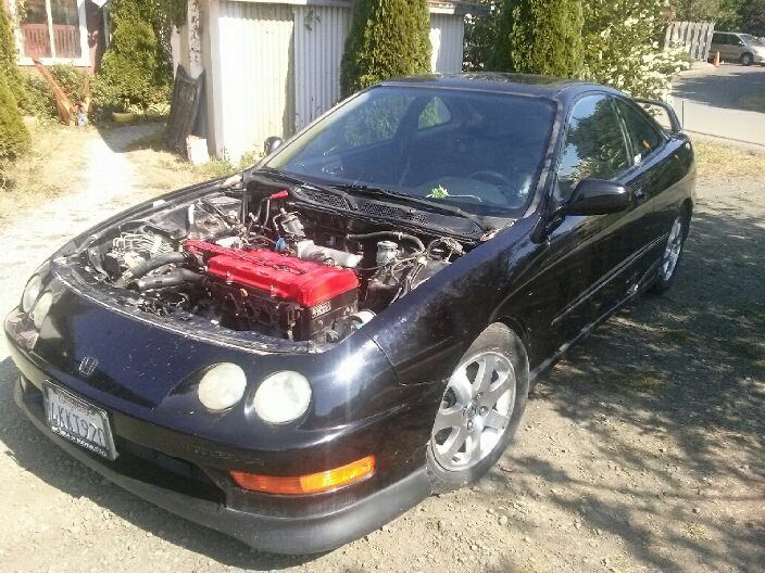

Civic Savior wrote:Awesome. That B series sold quick! Cant wait to see that K in the bay of that EG :twisted:
Yeah it did actually. Here's it's new home:
Tomorrow's goals are to have the passenger mount removed and the k series mounts installed, relocate the radiator to the drivers side and getting the ecu and conversion harness installed/routed.

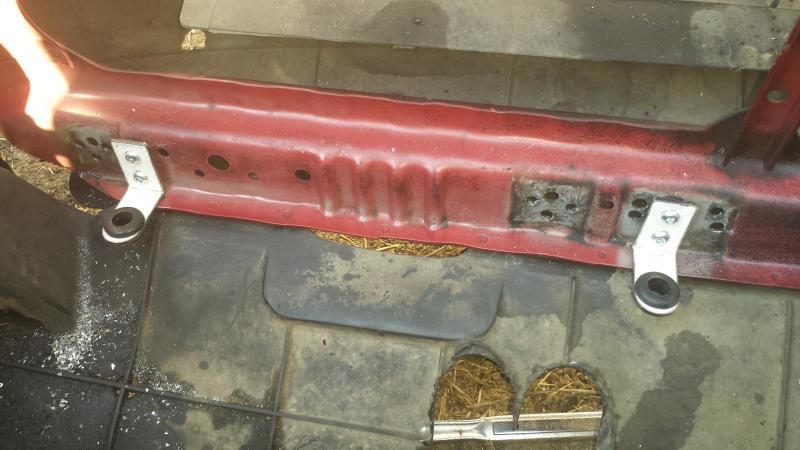

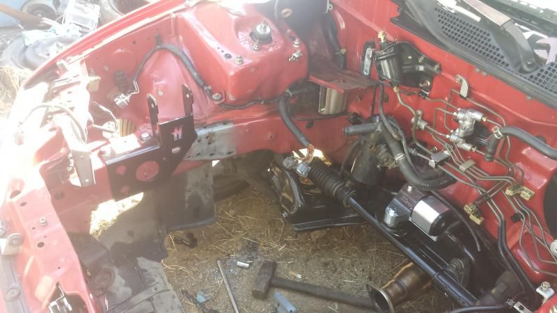

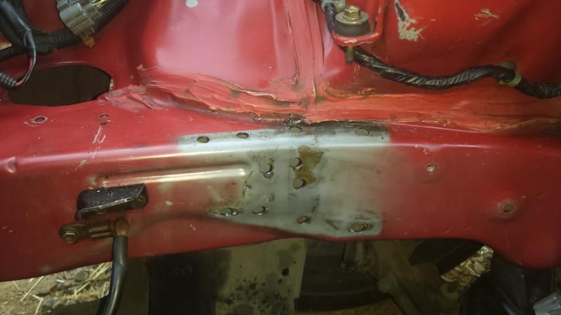

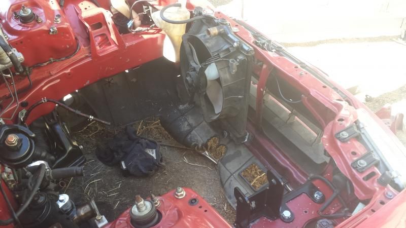

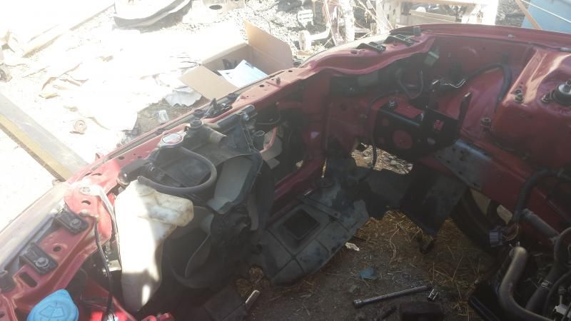

#348797 I got most of my goals accomplished today.
Old frame mount removed, k series mount installed. Rear mount installed too. Old condenser mounts removed, new radiator mounts installed and radiator relocated to the drivers side. Most likely won't leave the overflow bottle there, but atleast it's mounted lol. I'll address where the old mount was before I drop the k20 in. As well as cleaning up the radiator and shroud. I also still need to extend the fan wires. No big there.
I really wanted to get the conversion harness routed/installed today, and I did start on it. But it got so hot, I couldn't take it any more lol. I'll be removing the a/c unit too so I can pass the wiring through easier. I haven't had a/c in the car since I've owned it, so I really don't see the point in keeping it in there. Atleast I understand what I need to do now and where everything plugs in.

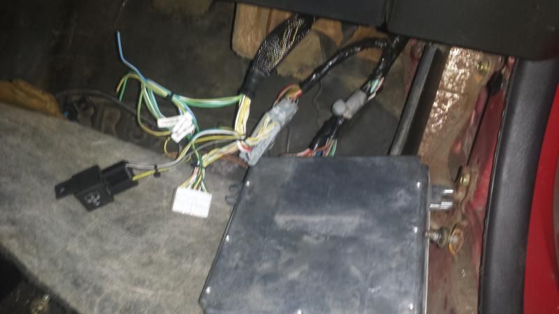

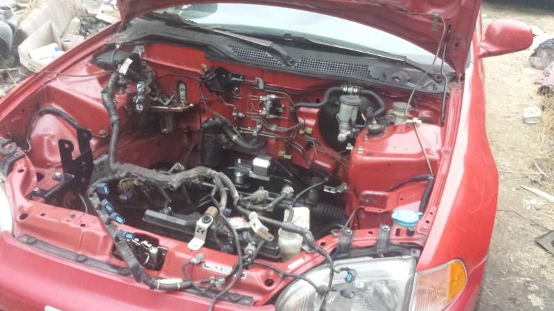

#348822 Engine harness in. Conversion harness in. Plugged in to ecu, but still need to wire in 9 wires or so, including the ecu immobilizer bypass. Not final install obviously lol. Image Image
By CopyLifted
#348834 All ecu wiring done, including the immobilizer bypass. All plugged in and installed. The 2 wires seen there are the coolant temp and fan switch. I'll wire those in when I drop the motor in.
