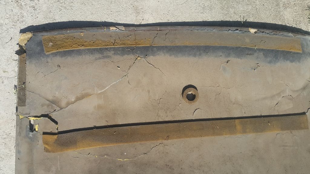

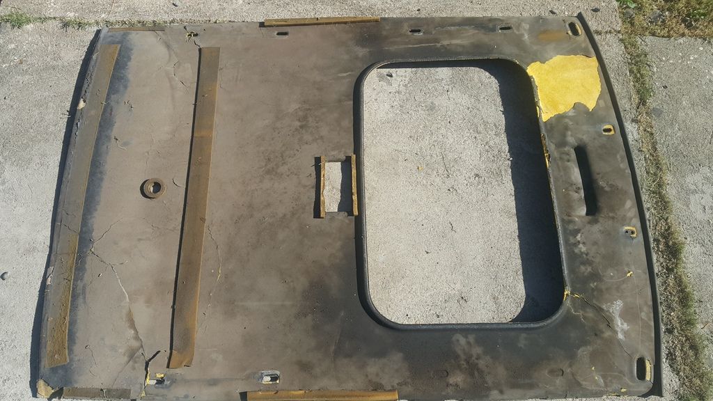

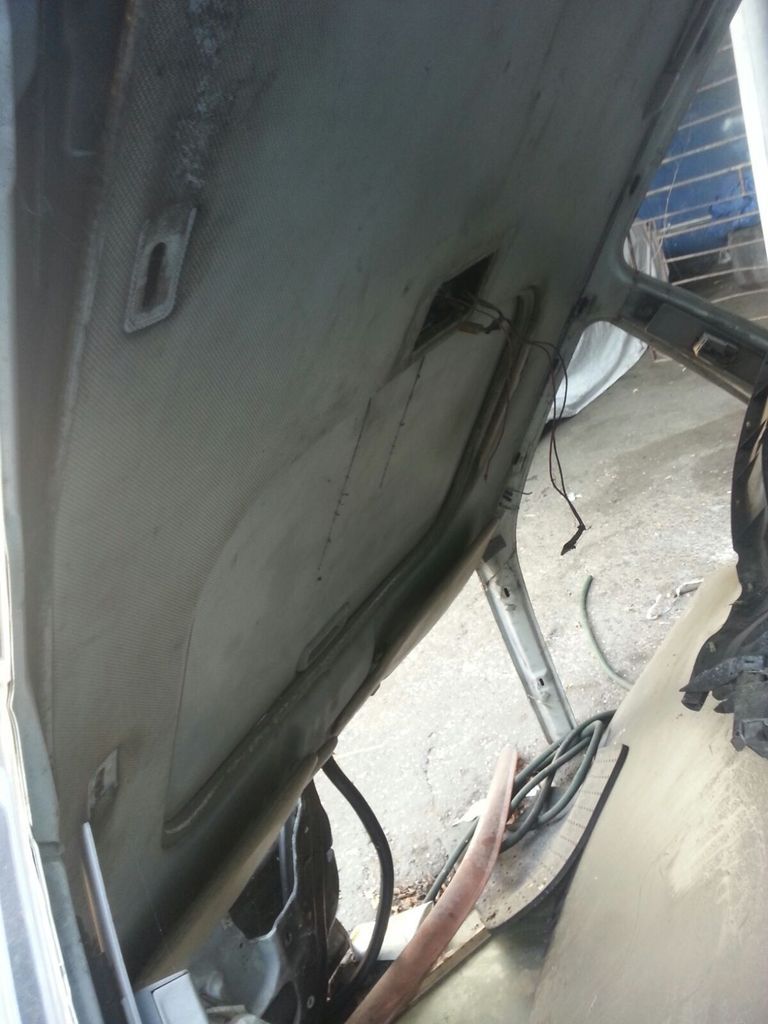

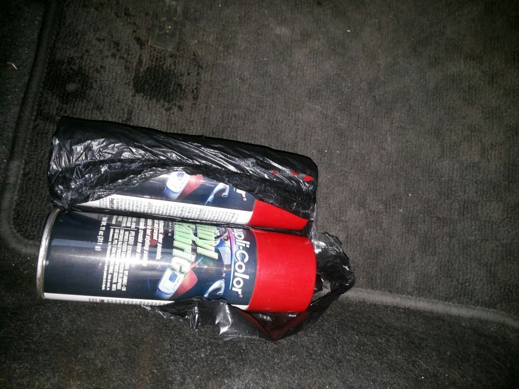

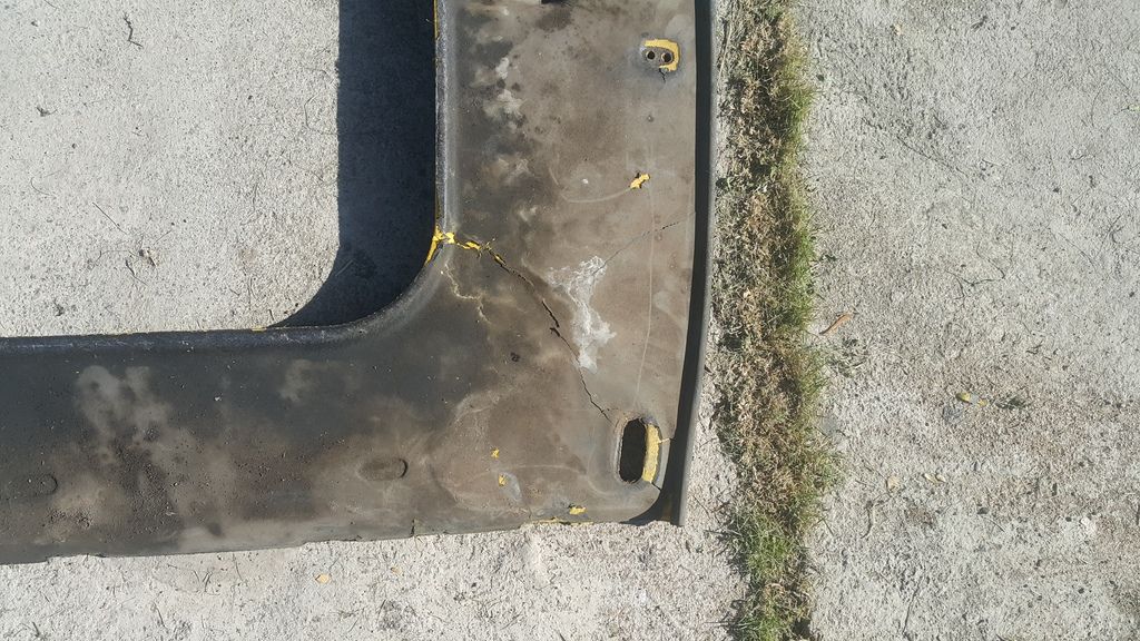

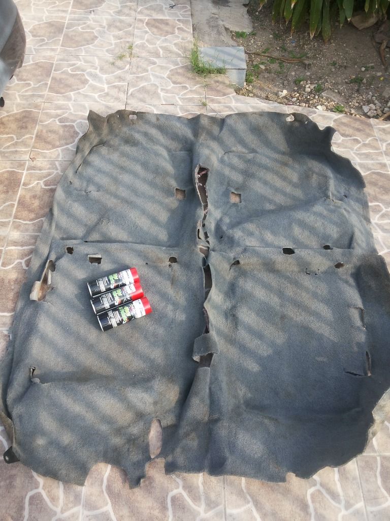

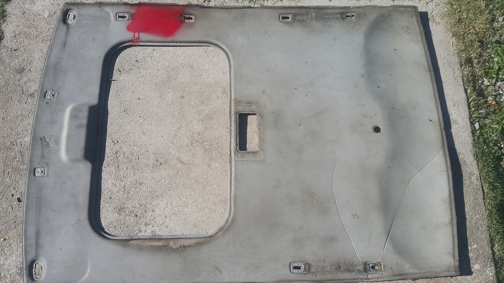

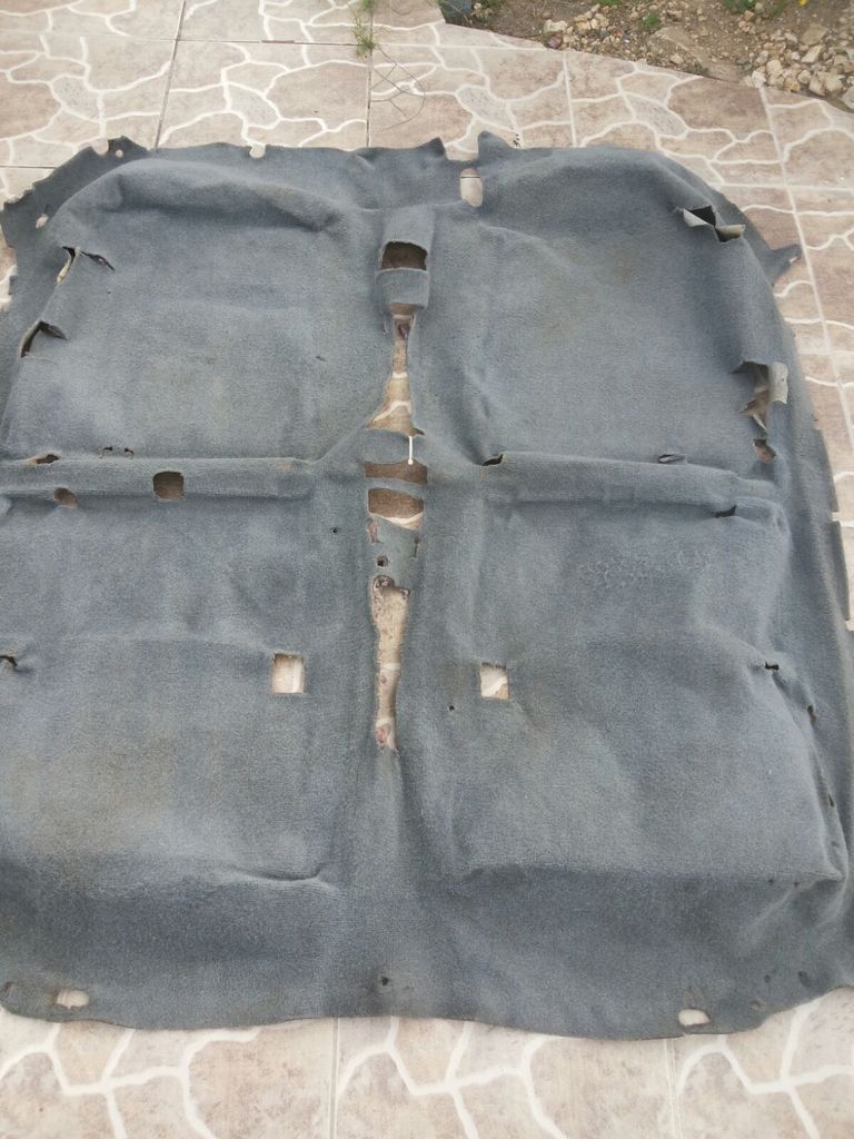

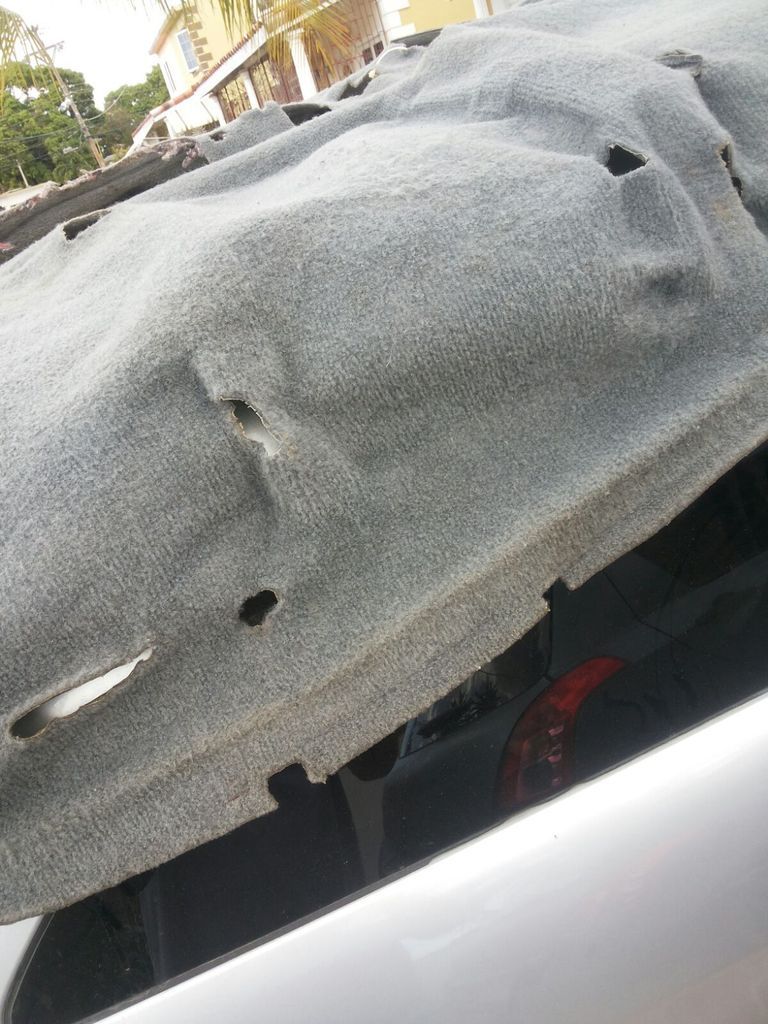

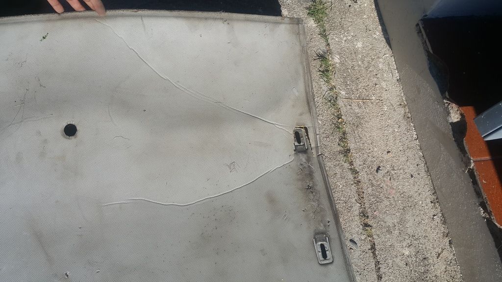

#359137 next... my roof liner has also gone missing. i have now had to try to use the one from the black civic i had purchase to scrap. condition=disgusting :thumbdown:
i have to see what i can do, after fixing and reupholstering i want to paint it red with the duplicolor

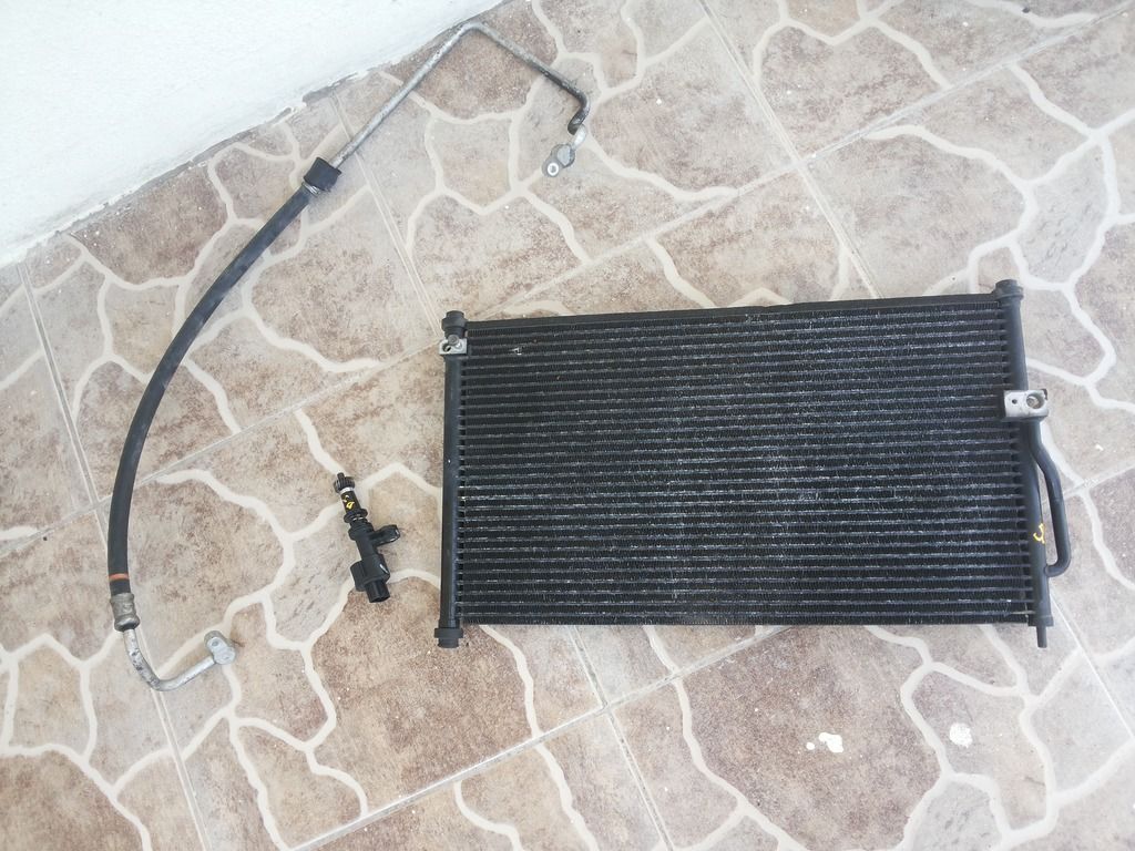

#359151 DC2 integra evaporator core
heard that this is a good upgrade for the AC, along with the CRV compressor i already have. trying to get it as cold and powerful as possible because i will not be tinting the car and remember i am removing my power steering.. dont want to be bursting a sweat when i try to turn :).
in my opinion it also looks better within the engine bay, the fact that it is within the bulk head and not in the bay really. oh yeah, also got a speed sensor

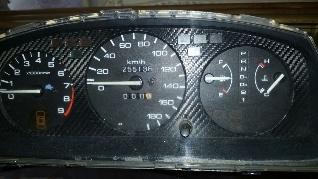

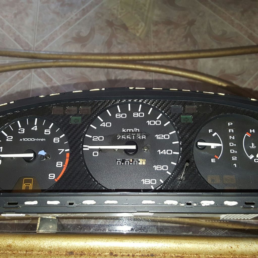

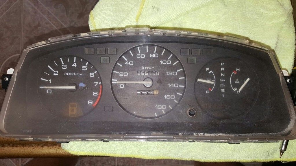

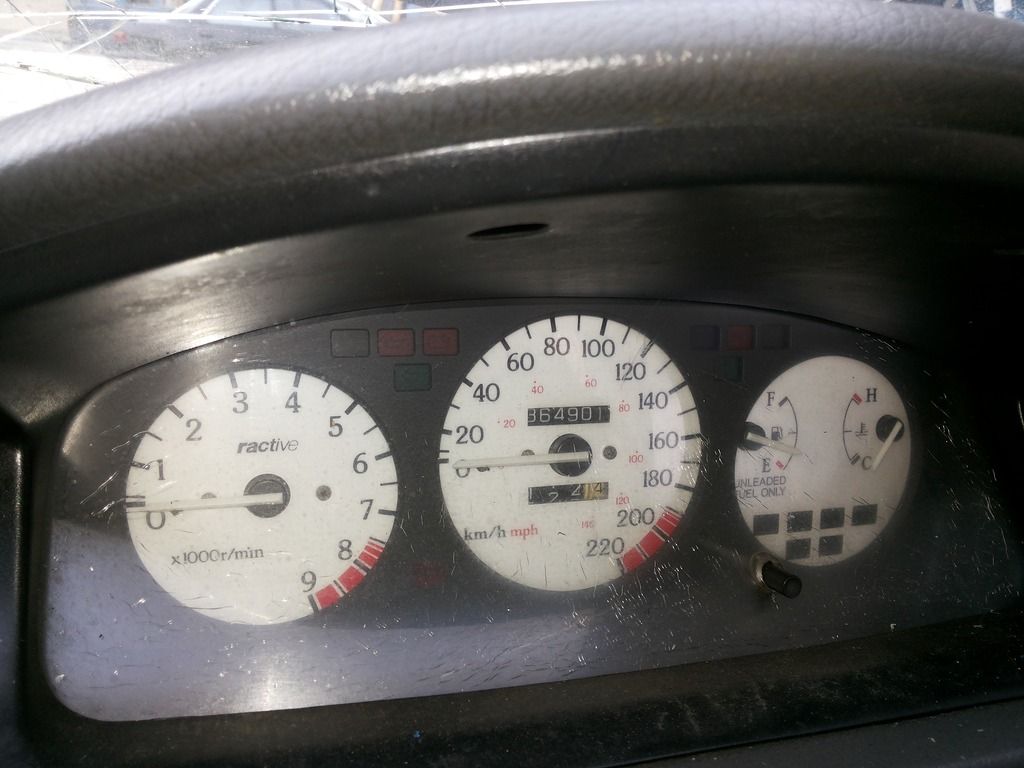

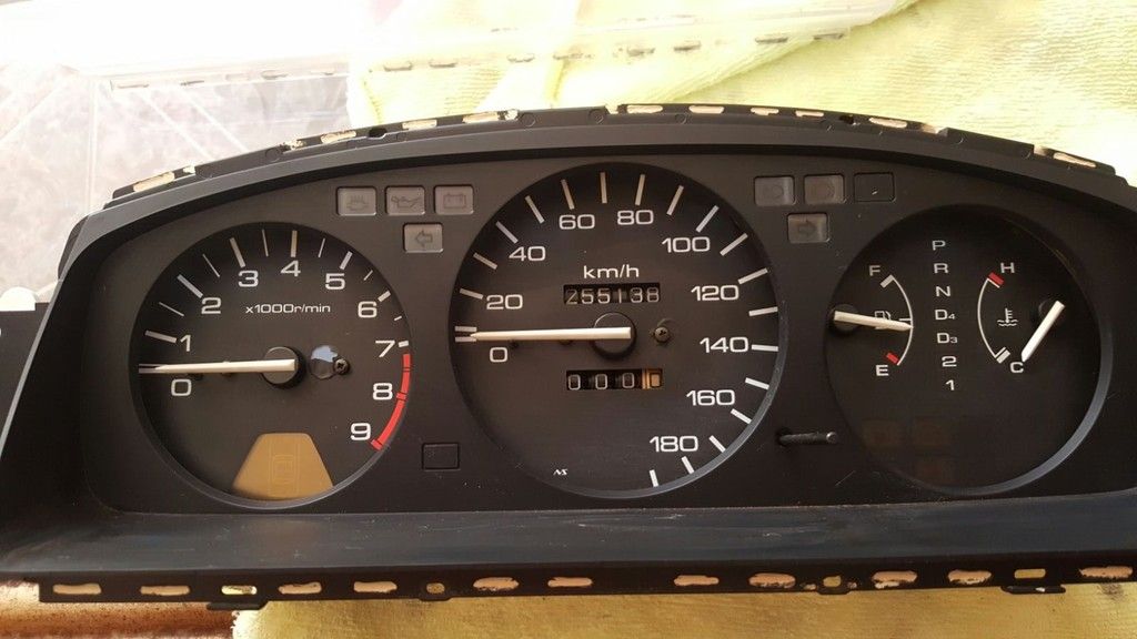

#359152 due to budgetary constraints i wont be able to do the DC2 type R gauge cluster right at this moment. I have a white face ractive which i don't like too much, got it from the scrapped civic.
so for now, i will be using back the original cluster that came with the car, yes the auto one :( . did some CB wrapping on it so it doesn't look too bad
the one i don't really like

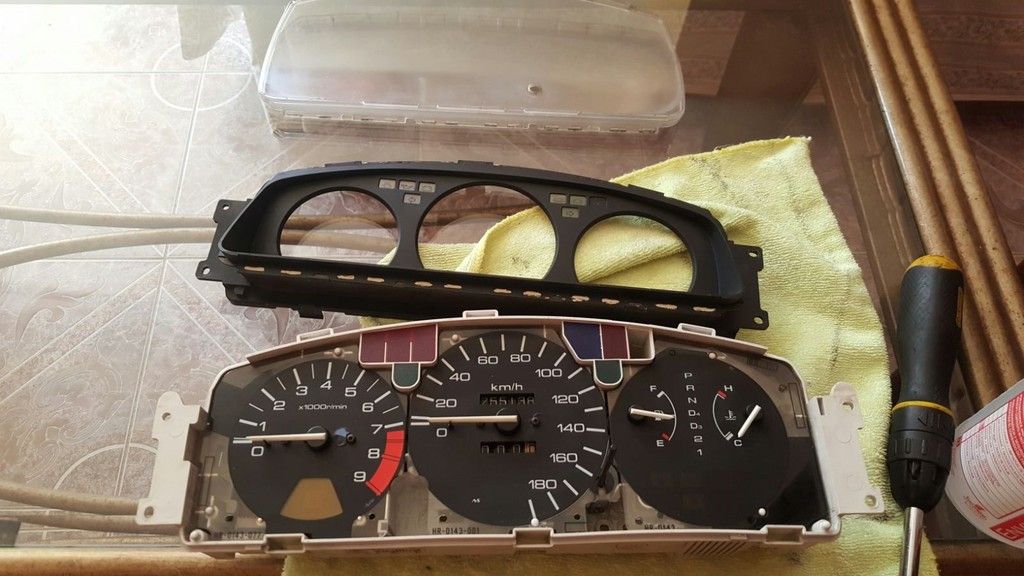

before
pull down
wrapped
after

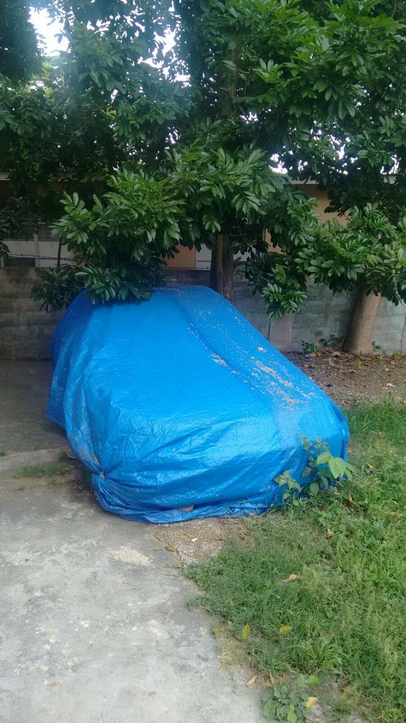

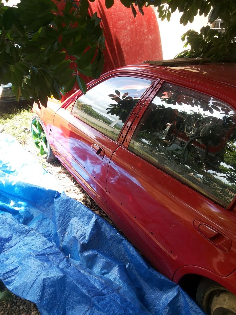

Tuesday
her new home, has been for the past 7 months

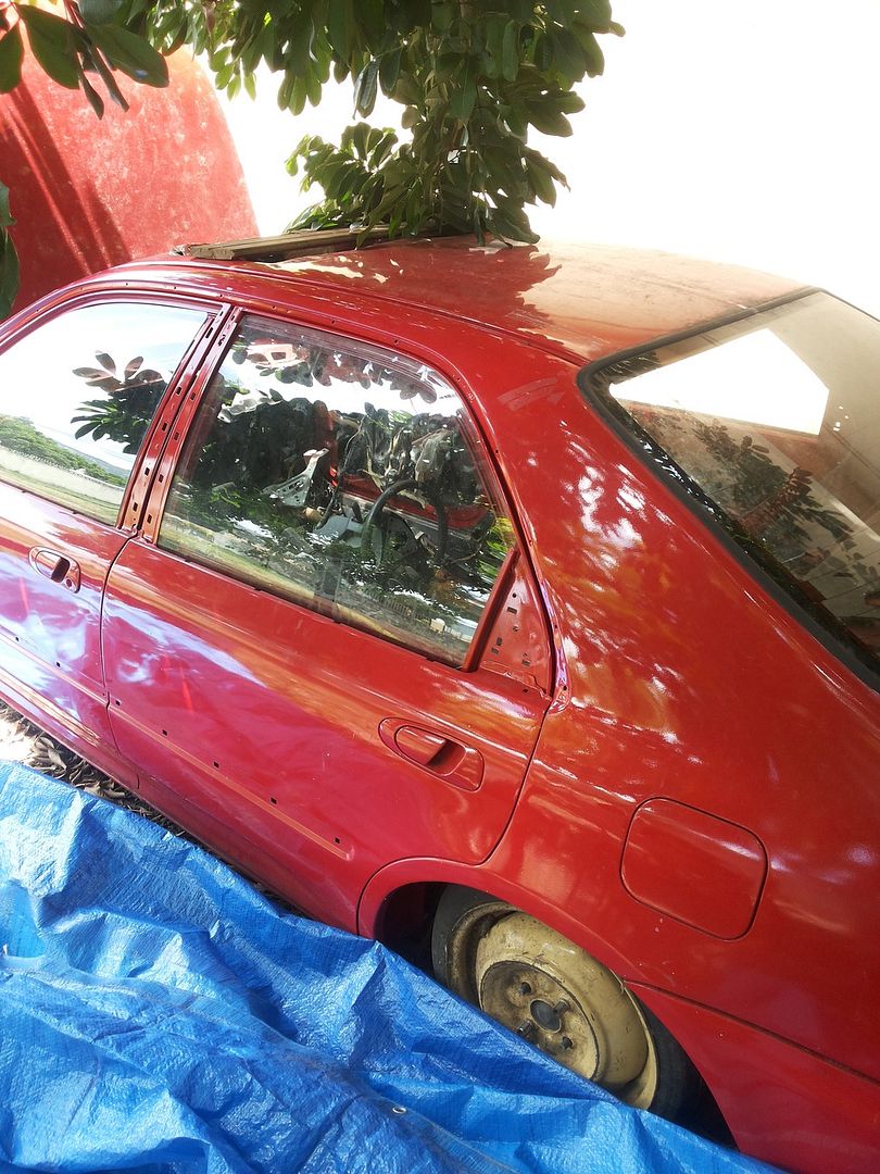

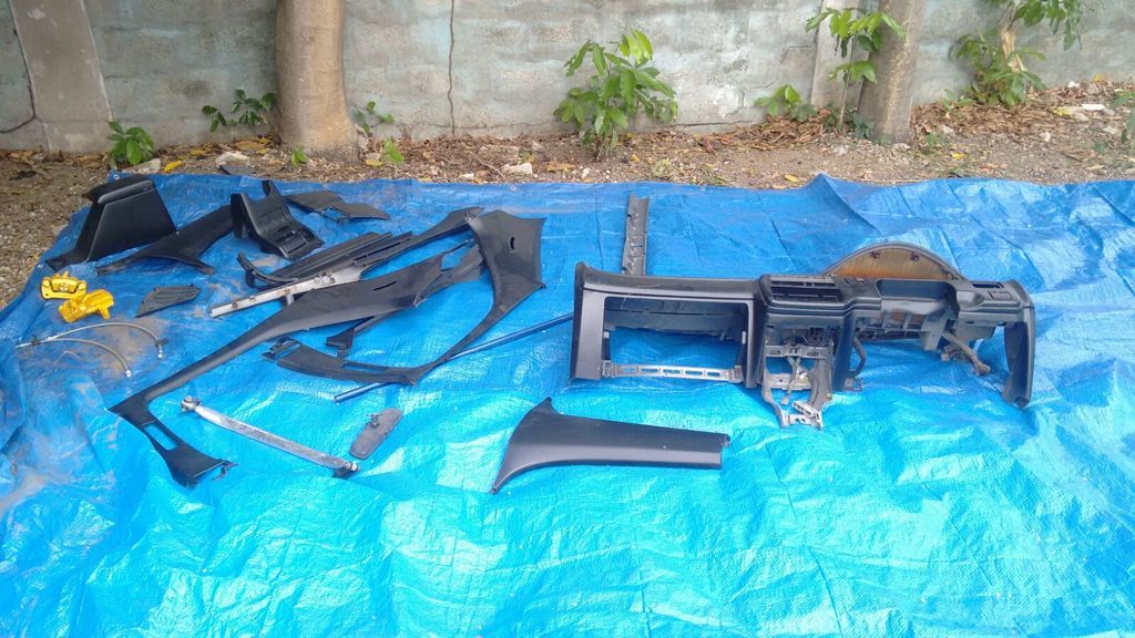

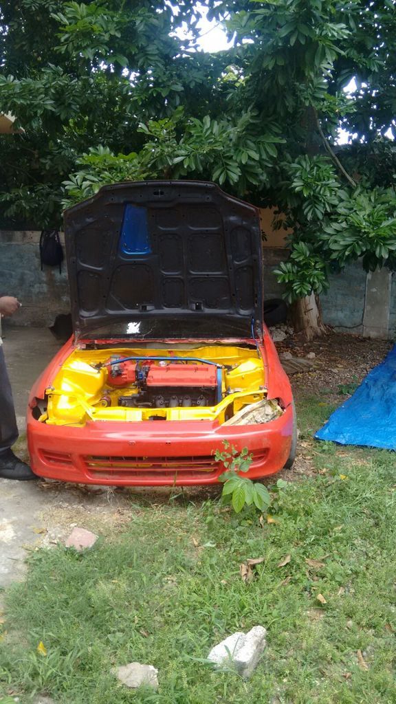

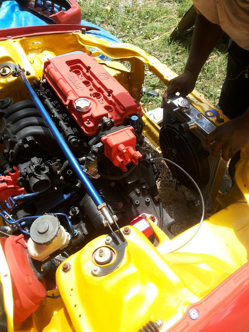

#359222 Tuesday was basically just uncovering the car and unpacking the interior
Thursday
bought some products for the clean up and spraying before installing parts
some close ups

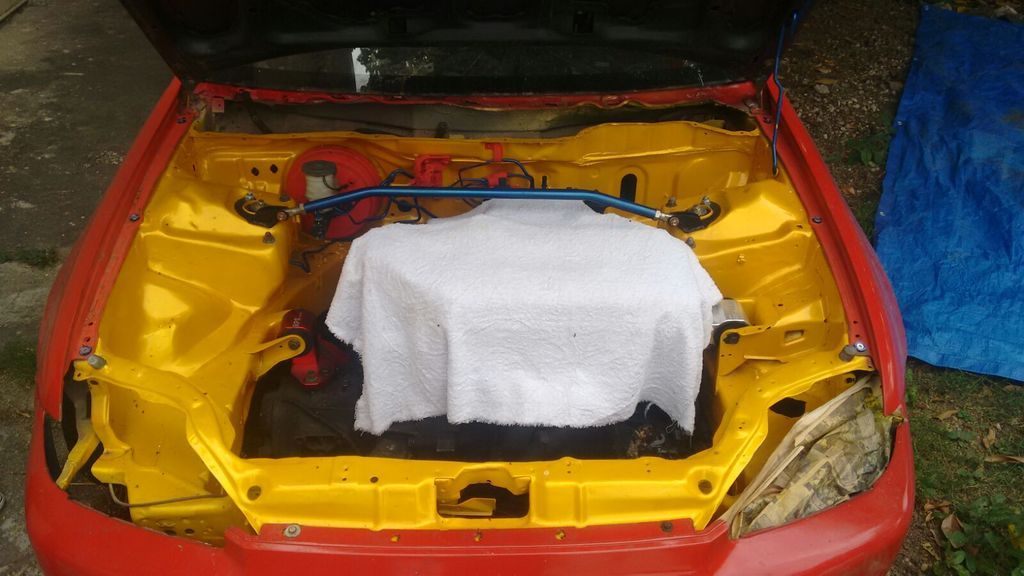

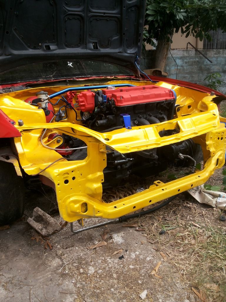

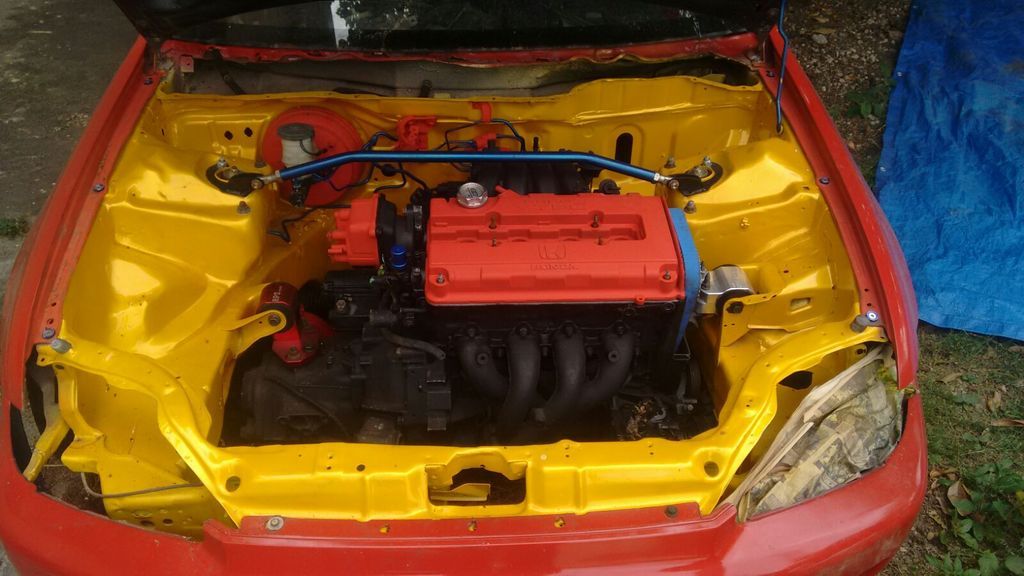

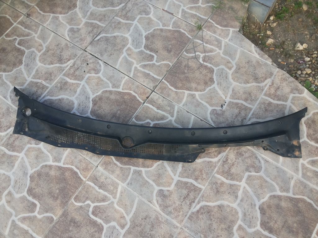

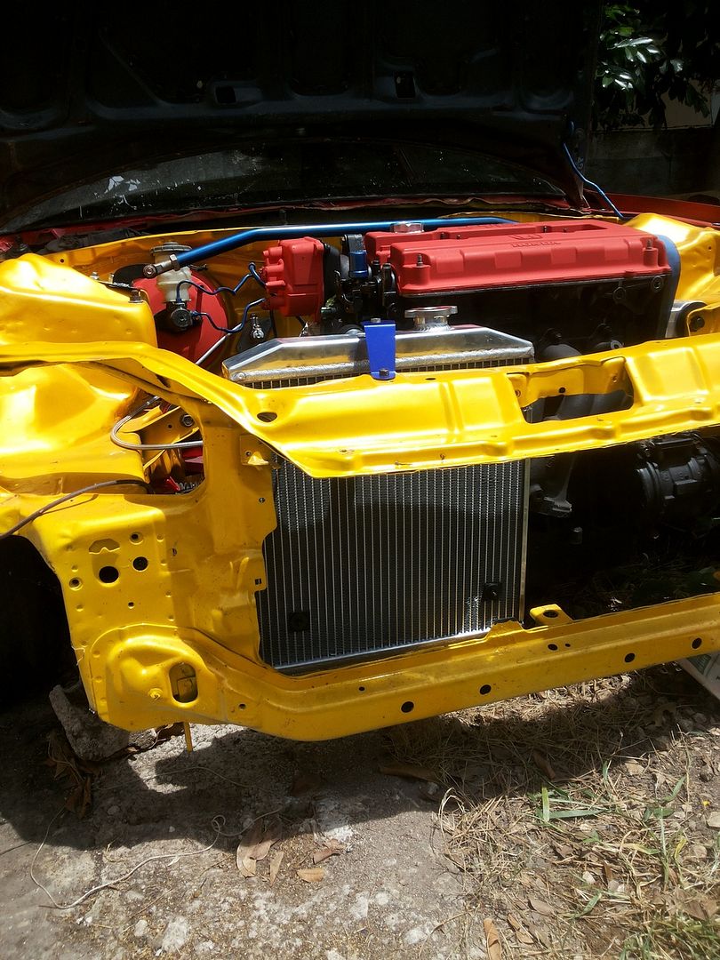

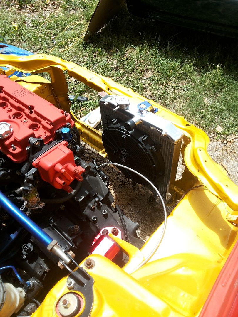

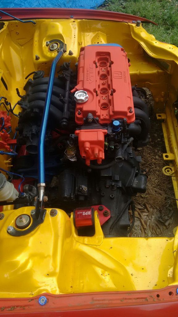

#359224 i had to make some modifications to accommodate the dc2 integra AC core in the bulk head. the original EG AC core looks similar to the half core radiator and usually sits beside it in the bay
i had to remove the center support. a single piece of metal that ran in the center from top to bottom. it supported the bulk head when the bonnet is being closed. i am however using bonnet pins, so no support necessary as i wont be slamming it closed.
I also had to drill 2 holes on the lower part of the bulk head for the integra core to sit within... compare the pic below with the one just above, you will see what i am talking about
