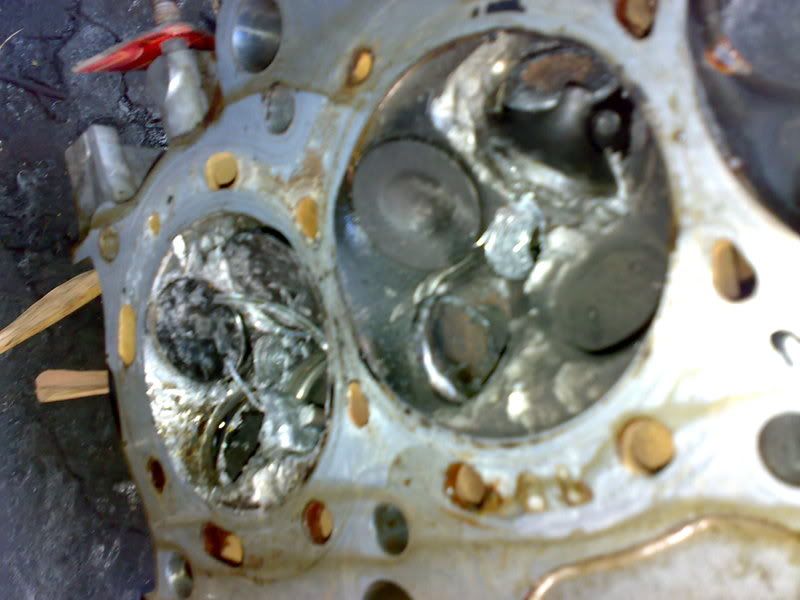

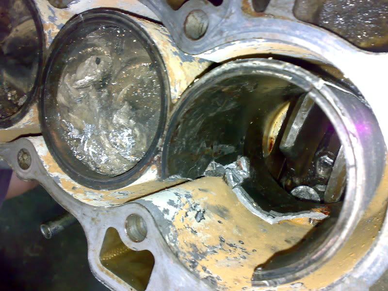

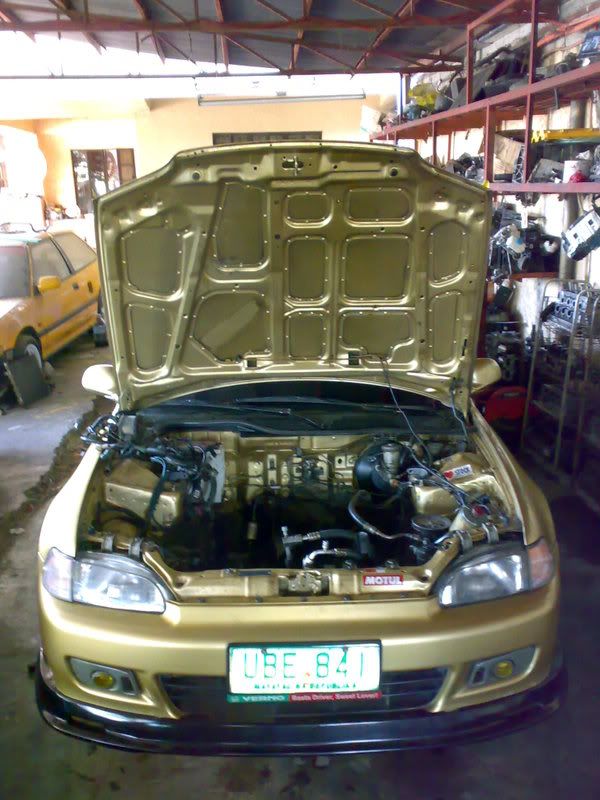

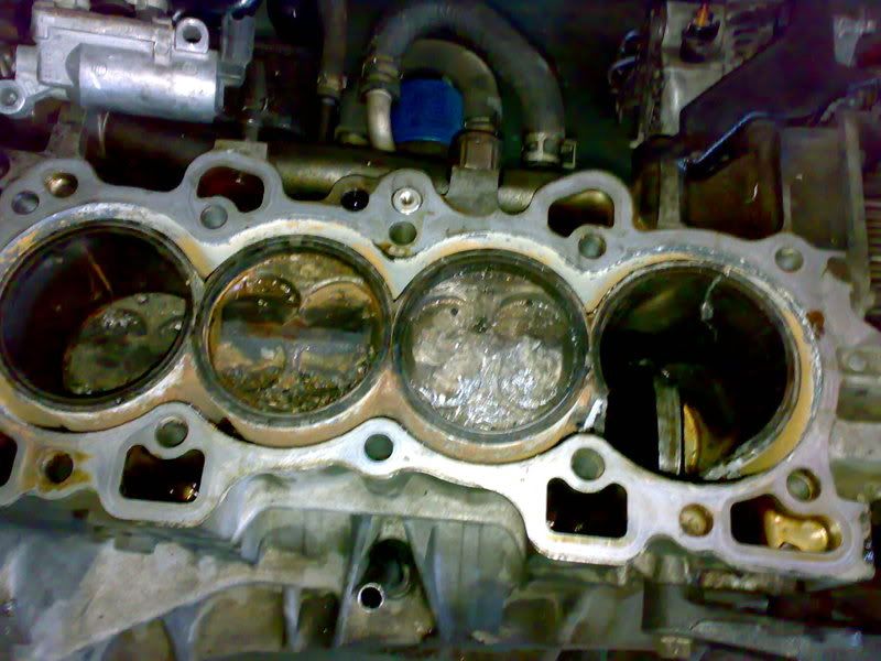

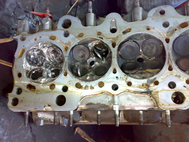

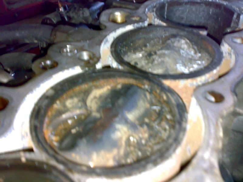

#49740 Ok we just got the motor out of the car.. man i shed some tears seeing the condition of the engine block and head..
here's the head..
where is the no.4 at?
that's all for now.. :(

teal_dx wrote:wow I just threw up almost. destruction pics are cool and all, but your car is so perfect, I never thought I'd be seeing these :(
So what happened?
buddy borrowed my car, tried to run it with a buddy's 4G63 79 lancer
mishift to 2nd gear instead of 4th. bye bye B16A.
i will make him pay for everything.
former setup was CTR pistons, ported head, EG6 cams, ECU tuned on Cromefree, made 175 on Dastek dynamometer.

looks like you drop a few valves and the engine took a shotgun hit.
engine probably went up to 11,000rpm and decided to snap its retainers.

#50084 Well he has alreay paid me. good thing!
The new motor is on the car already.
This time its much zippier than the old one, utilized some of the old parts we salvaged.
I guess this was a blessing in disguise since I never realized I would be able to build the car like this, We're still going to finish it till next week and then its off to the dyno for some tuning.
I shall post results and details of the new motor once we get everything in order.
