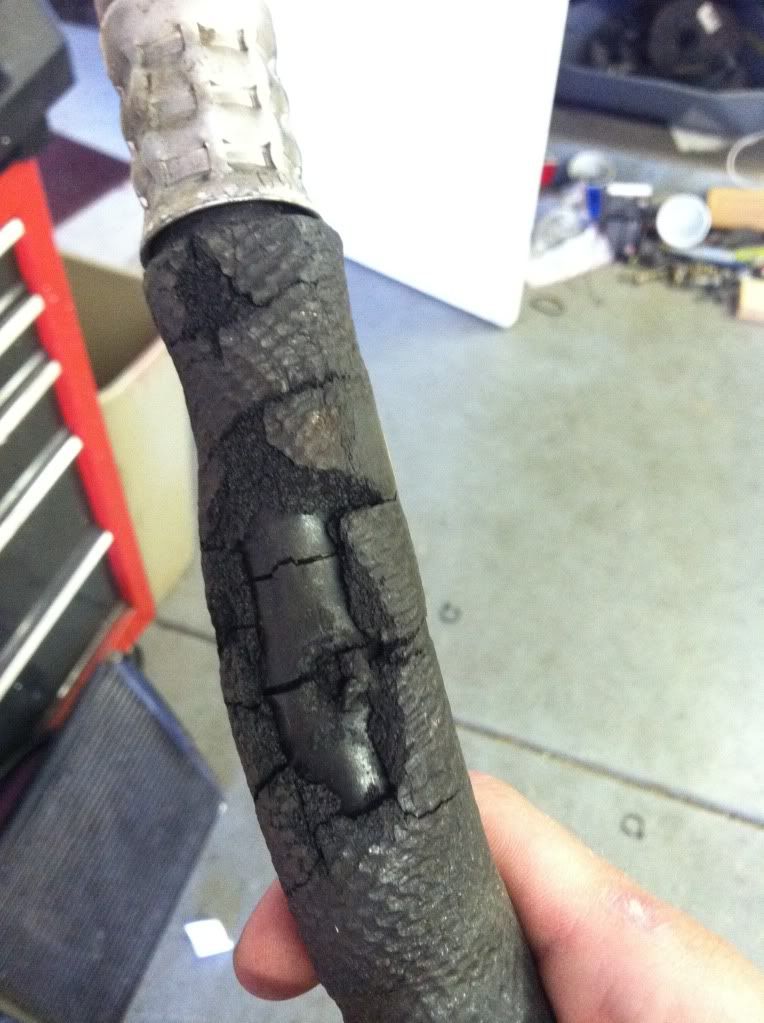

#262333 so after i drove 400+ miles this weekend to go camping i decided to dig through my spare parts and came up with the high and low pressure A/C lines from my old car and got a can of refridgerant...
here is what i did to the old line:

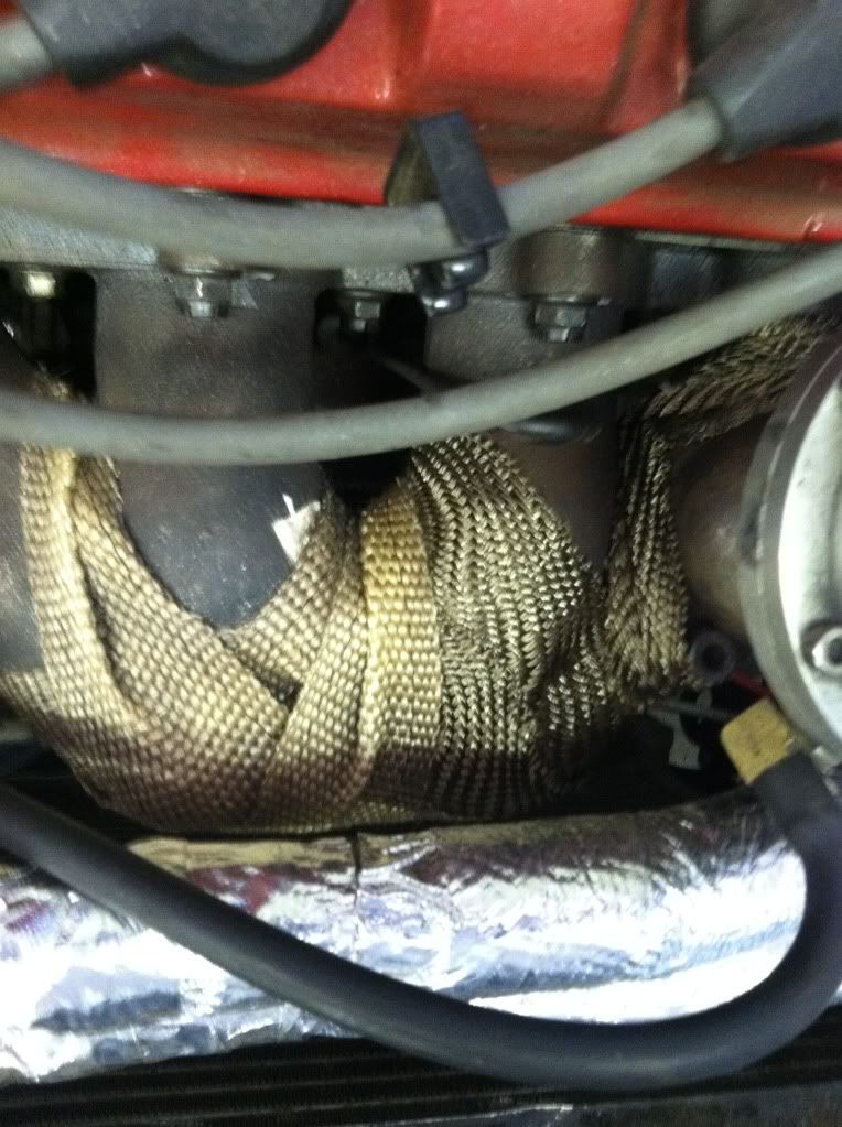

and then i ghetto wrapped my turbo mani:

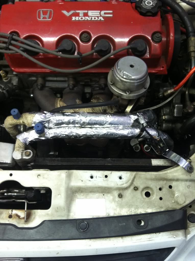

and wrapped the a/c lines in header wrap and reflective tape
so i hope this will help and last for a while, it's getting a littler warm here :)

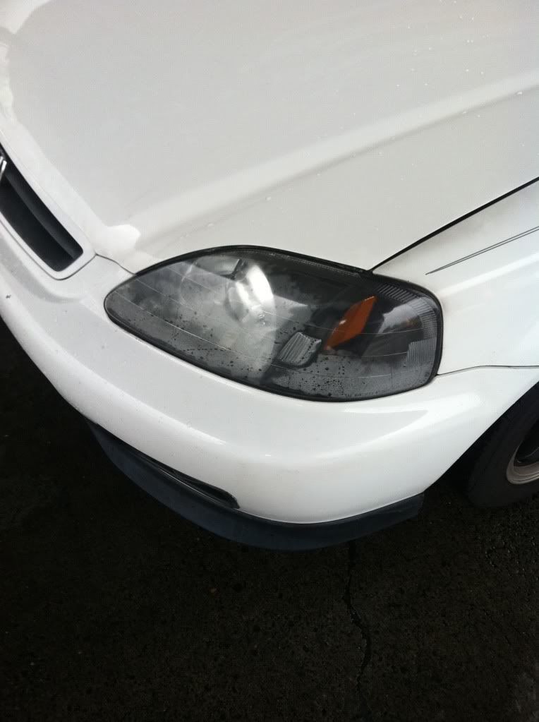

this shit is really bothering me, why does this keep happening?
i have already re-opened it and siliconed the shit out of the seam, is there something in the back of it i can look at?
#262338 turbo +a/c = win!!!!
and as for ur headlight
check where u put ur bulb maybe it doesnt seal there

i'm thinking it might be something with the light socket? i might have to pull it out when i take my bumper off again...

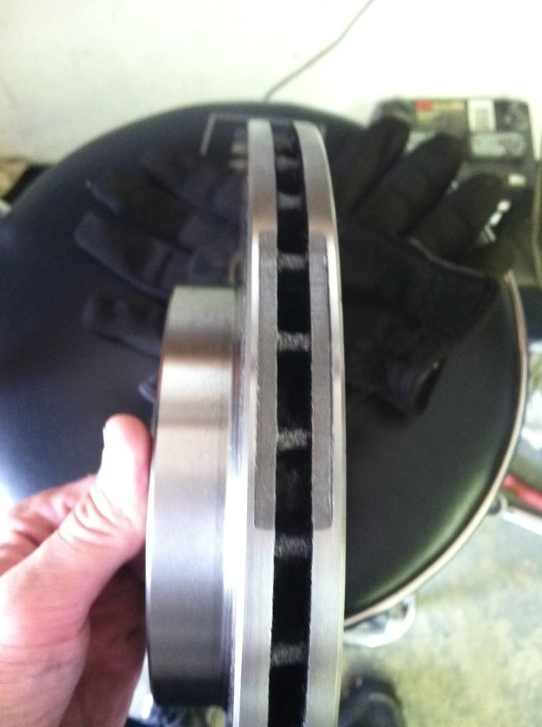

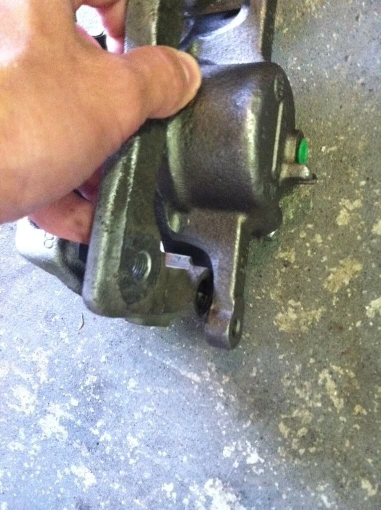

i learned something over the weekend: that EG caliper brackets DO NOT fit on EK front brake calipers. nor are the pads interchangeable. they DO however use the same size rotors...
i ALSO learned that the Low Pressure A/C line i replaced off of my old EG is like 1.5" longer and slightly rotated off the compressor allowing me to clear my turbo manifold with some room to work with
so here is my dilemma: right now i'm driving my hoopty :lol:
i'm currently waiting for o'reilly to order in some brackets.
on a better note, look at the quality of the brembo rotors, they actually balanced them and took out material to make it so:

The headlight mosture most likely is leaking in around where the HID bulb comes into the housing. especially if you sealed everything else up.
