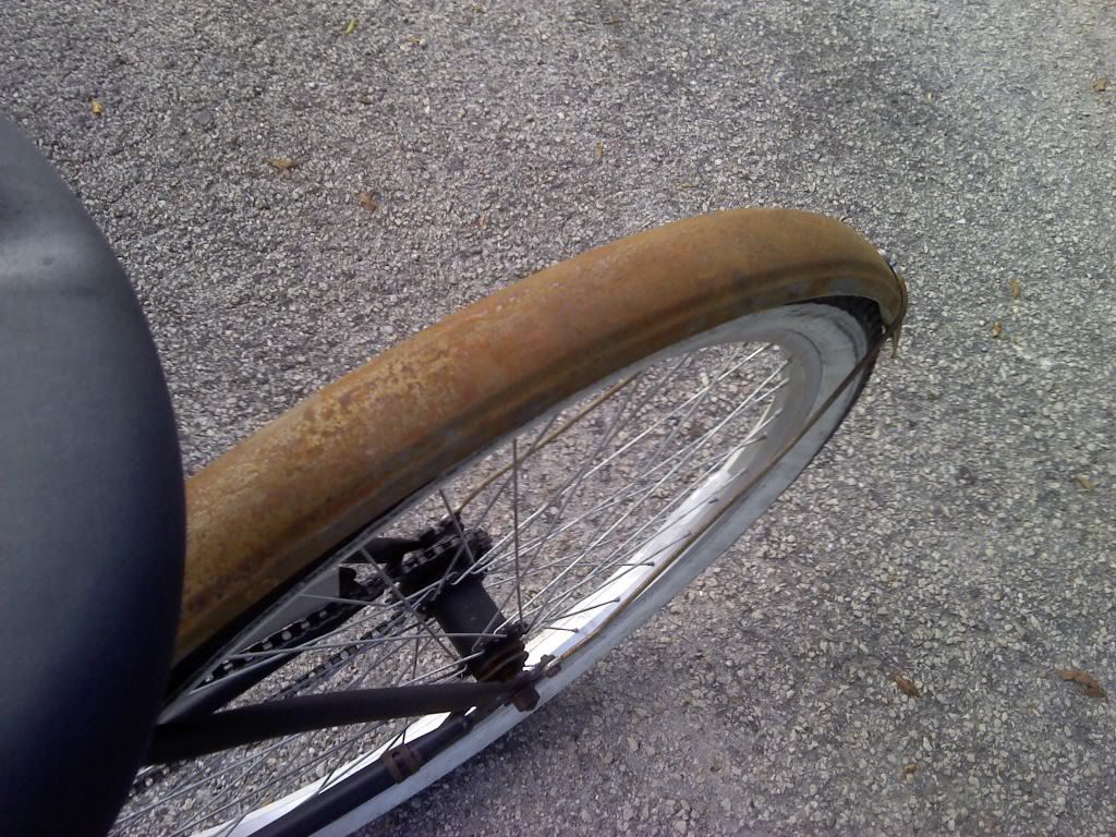

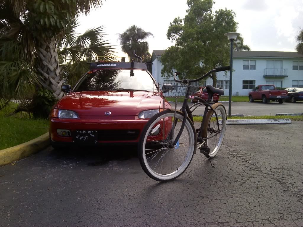

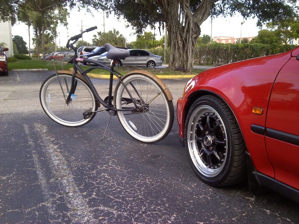

Nice dude!
If your leaving the fenders rusty and want it to rust more/better/faster use a spray bottle and spray it down with salt water, let it dry. Then spray it with peroxide. Use a heat gun if you have one or do it in the hot sun... you'll get a uniform rust layer and depending on the layers you spray and how hot you get it the color will change
