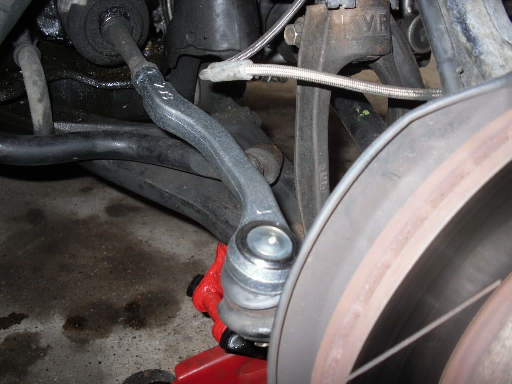

#219196 Replaced the tie rod ends. Still have a suspension knock that seems to be getting worse...and I can't pinpoint the location. I'm goign to jack the car up and check/tighten everything with a bolt on it.
Ordering the Energy Suspension bushing kit on Friday. Most of my bushings are shot to hell...I'll try to take pictures of the process.

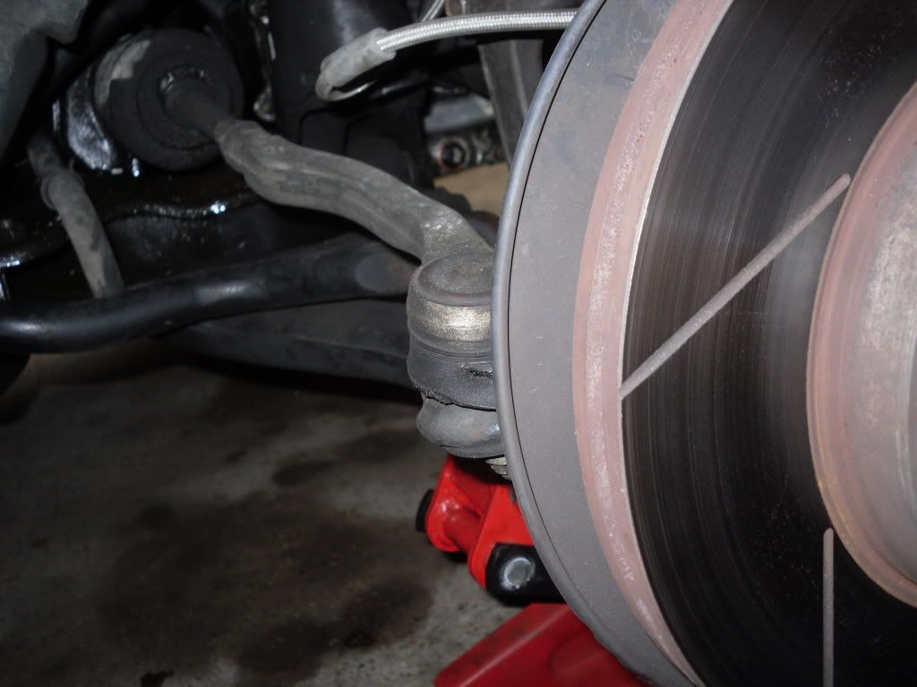

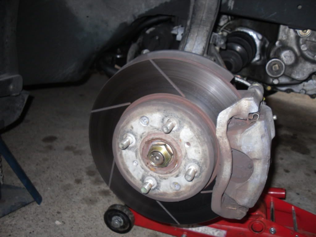

In the mean time, here's pictures of the tie rod end job. Only the right side, the left side was an identical process.
Clean car. For the first time in a LONG time.
Clean LS meshie. For the first time in quite some time.
Powerslot goodness...notice how blue the middle of the friction surface is. I heart late braking into turns...
Peekaboo!! I'm about to beat the shit out of you with a hammer! Oh, and you can see the Goodridge brake line here, too.

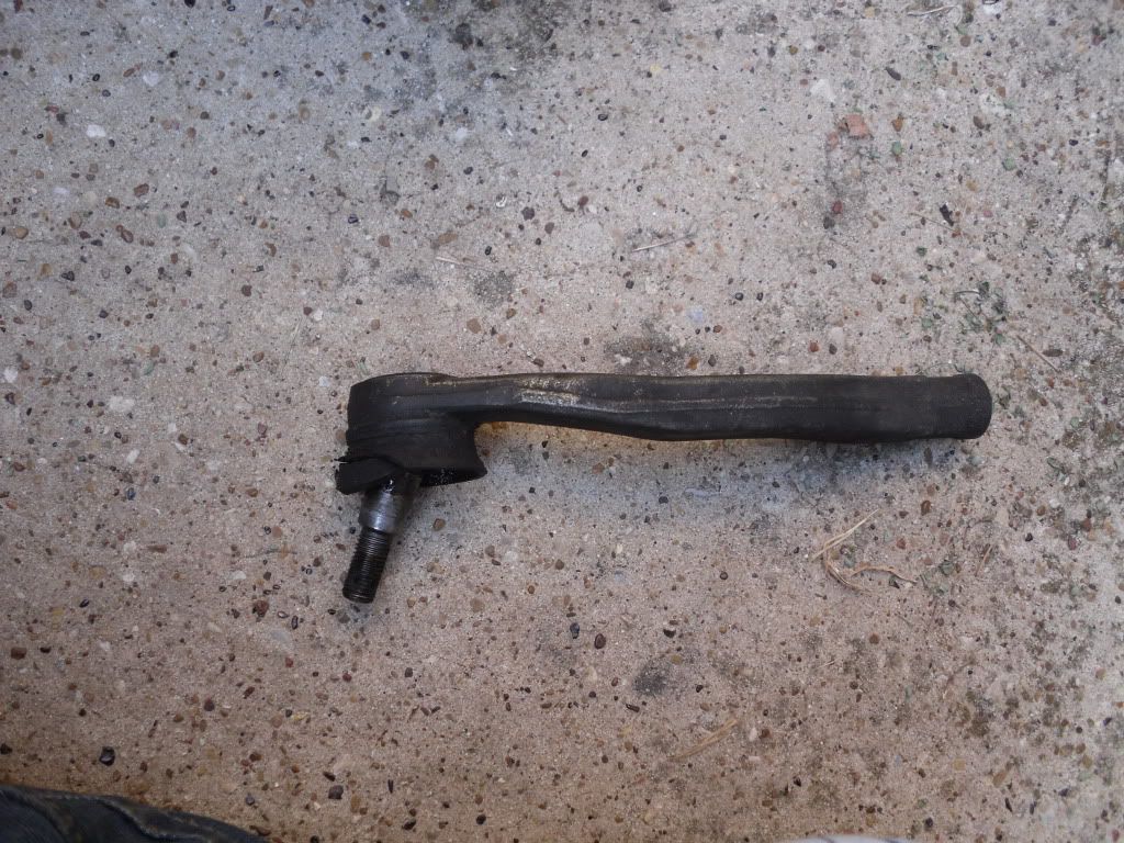

10minutes later, old one is out.

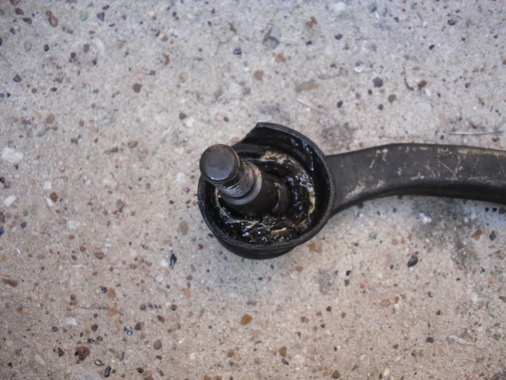

Nasty...
Yay HOP!

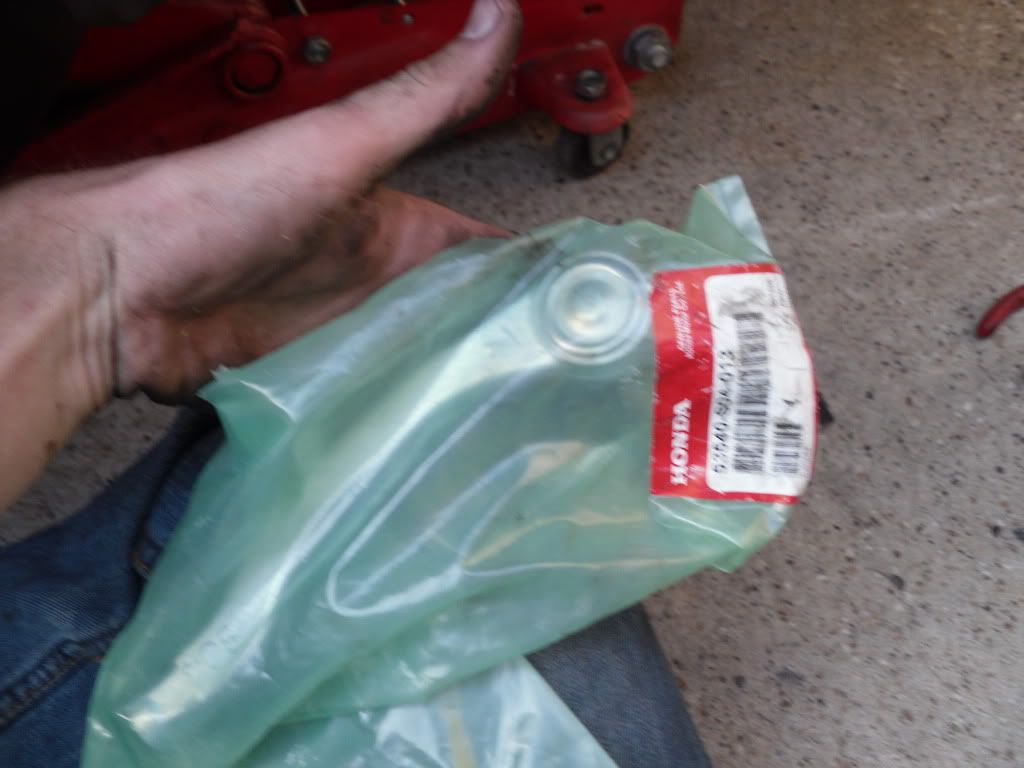

10 minutes after removal, new tie rod end installed.

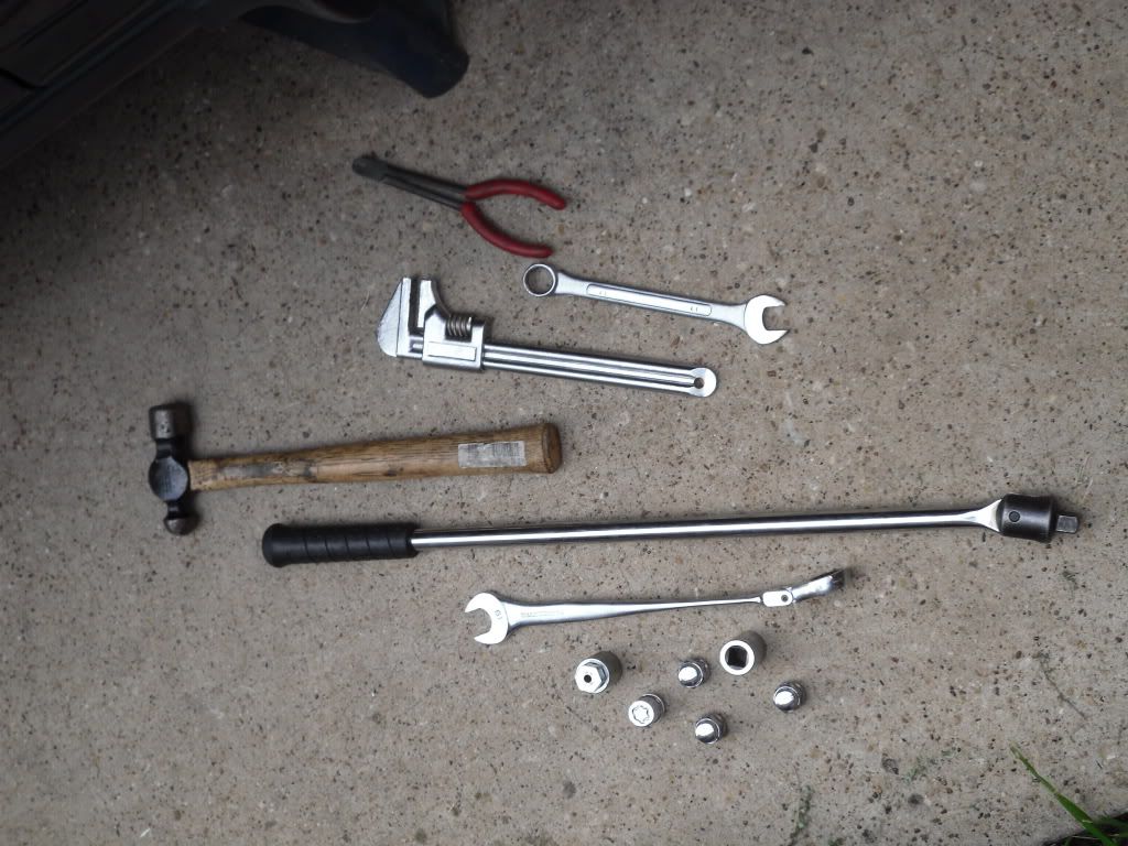

Tools I used. Spare for the jack and jackstand which were still underneath the car.

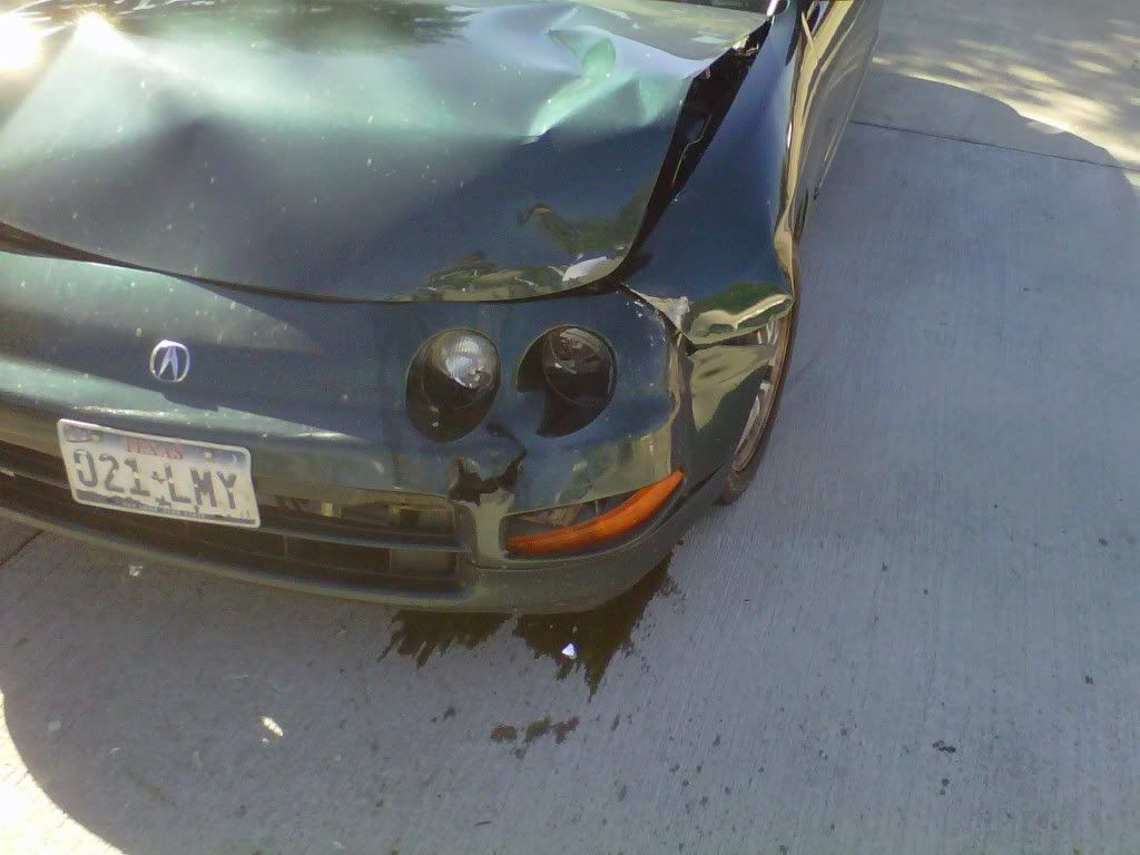

#222190 I installed the Energy Suspensoin bushings this past weekend. My car is totaled now. I was on my way to the alignment shop, and some douchebag turned into oncoming traffic and we collided. It's his fault, and I'm meeting up with the insurance adjuster tomorrow to figure out what I'm getting out of the deal, and to see how much it would cost to buy back the car for all my parts.
I'm probably getting a DelSol if the check is more than 2k. A close friend of mine wants to sell it to me. It's a B16A3. :D If they give me 3k, I'm definitely buying back the car and swapping parts. No doubt about that. I just have no idea where I'm going to keep the 'Teg...
By That One Dude

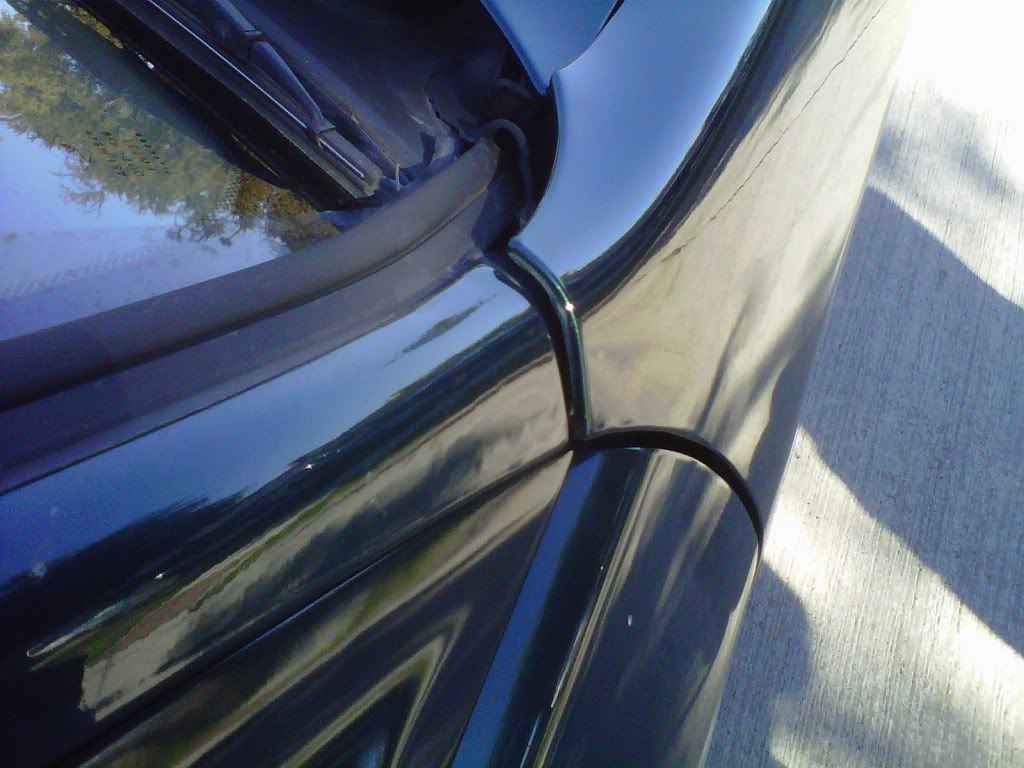

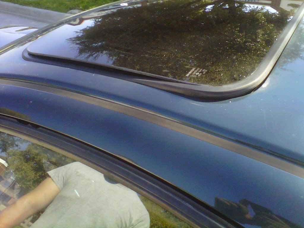

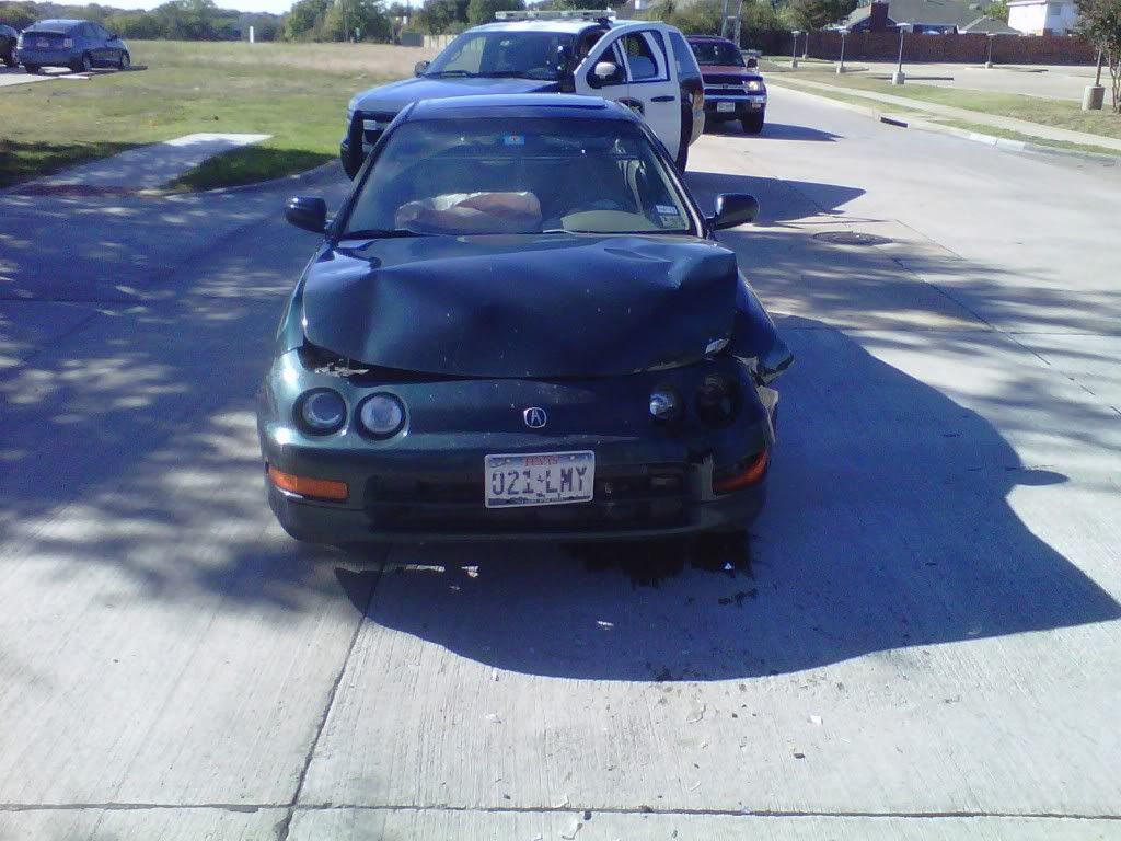

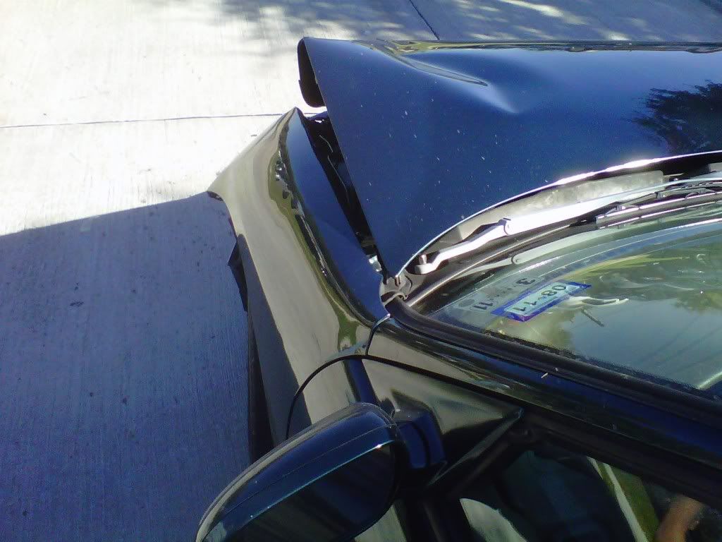

#222197 Image

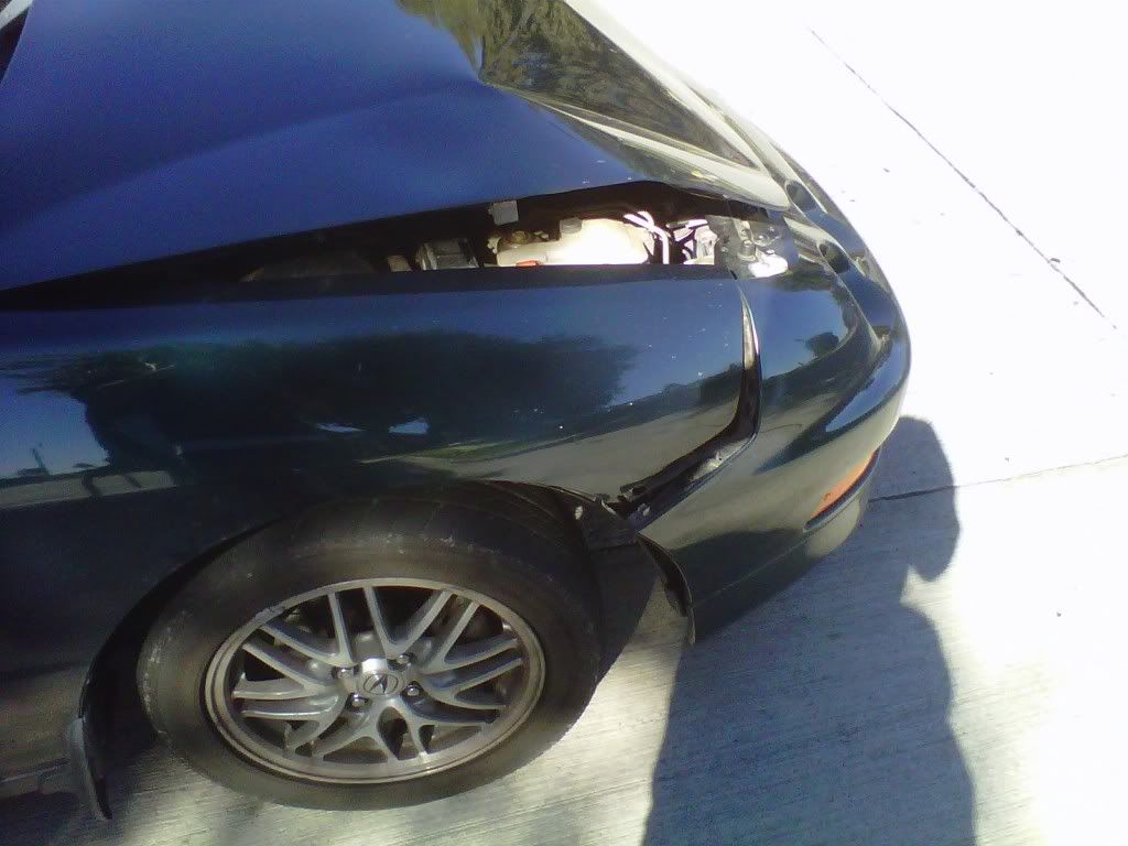

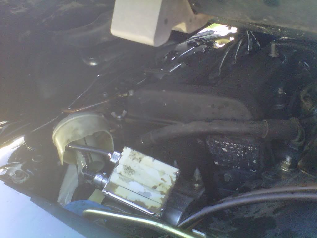

Looking under the hood with the hood still latched.

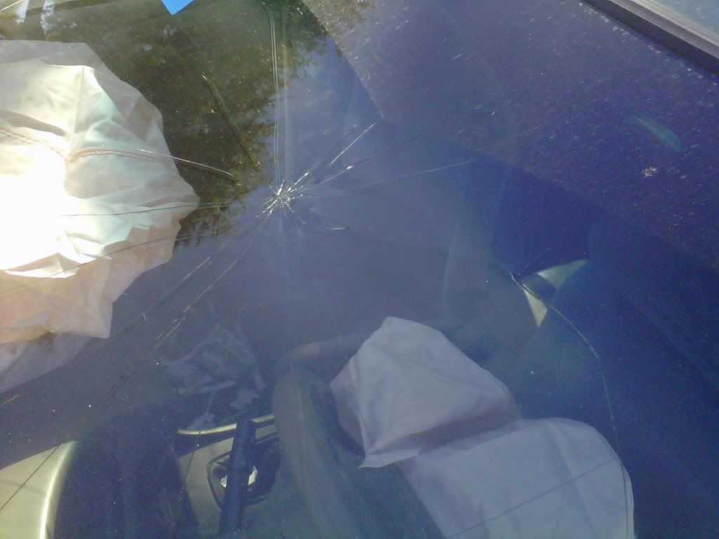

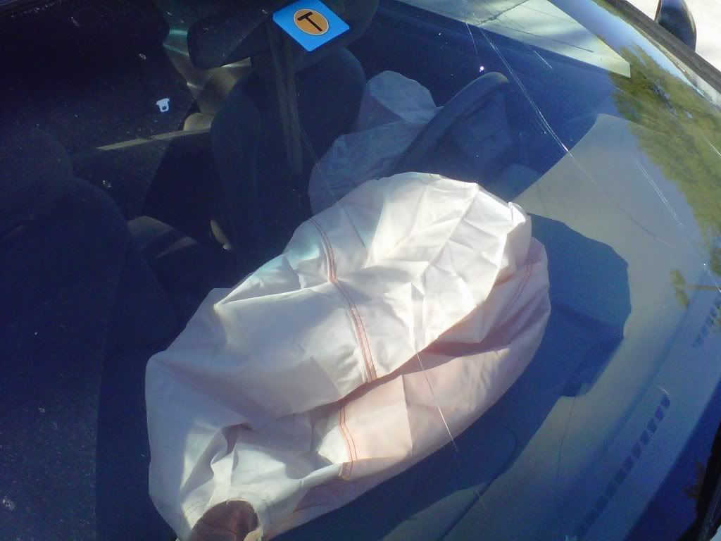

Cracked windshield from the airbag.

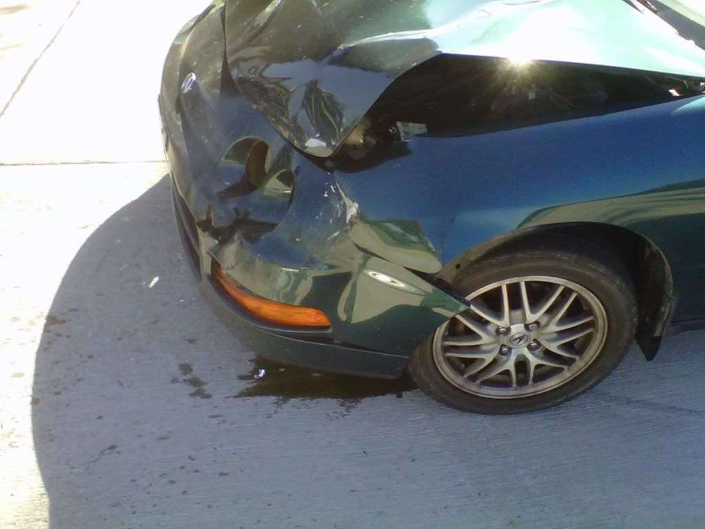

It was bad...
Showing how badly the frame is tweaked.
It's totaled, no doubt about it.
What I saw when I stepped out of the car.
Sunroof popped out.
Crunch...
Radiator, condensor, fender, hood, bumper, bumper support, radiator support, and frame. Fucked.
My baby is broken... And I didn't even get to name her...
