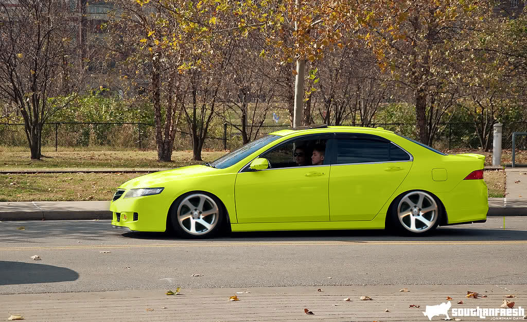

I've gone and picked up a sample today to test it out and make sure the color was mixed correctly because stealing Lamborghini color codes and converting them to other paint lines isn't the easiest task. The color I've chosen is called 'Verde Scandal' and it's a special option when ordering several newer Lamborghini models. Due to the amount of yellow pigment required this paint is silly expensive even in the paint line I've chosen. In Sherwin Dimensions the base coat alone is $471.00 per gallon [smilie=BangHead.gif] So here's to hoping I don't mess anything up and need more. I've also chosen this color because it is a solid color... NO pearl, metallic, flakes. Nothing fancy means touch up work in the future is fantastic and won't require repainting half the car to fix a rock chip or door ding.
So here is a picture of the car where I saw the color in person for the first time. I'm going to try to paint a mirror cap this weekend to see the color on a part in person, will be some motivation to keep working hard on this.

#361029 Thanks Teal_dx! I've been working on one too! Needed something to help me pick the new wheels. I'm eliminating all of the chrome/silver from the car. As I'm sure you know the pillars on the TSX have 3M vinyl on them for the matte black look between the windows. I got matching 3M vinyl to wrap the chrome around the windows. I've also purchased one Acura RDX door handle (They are all chrome and people put them on the TSX) I'm going to disassemble it and see if I can chemically strip the chrome using a technique model car builders use of soaking it in 'Super Clean' for a few minutes. Unfortunately paint doesn't stick to sanded chrome plating so this is my best chance at color matched handles. If this doesn't work I'll paint match the handles and wrap the chrome strip in the black vinyl.
I just took the Mugen catalog image and traced it and re colored it. I can't decide if I want the Mugen high wing or old style lip spoiler... And I've changed my mind from the Mugen kit and ordered the A-Spec lip kit already and a Mugen grill. I may piece order the Mugen kit in the future I just have better uses for that amount of money at the moment. I am shaving all the emblems from the car and tinting the tail lights as well, not going black like the render just wanna dull down the red a bit. I'm sure there is more I'm forgetting but as stuff shows up I'm sure I'll have pictures to post.
This is a 5 minute version. Really sloppy line work and coloring just wanted and idea of the color with the kit. I plan to go back and make a photo realistic render before actually spraying the car.
