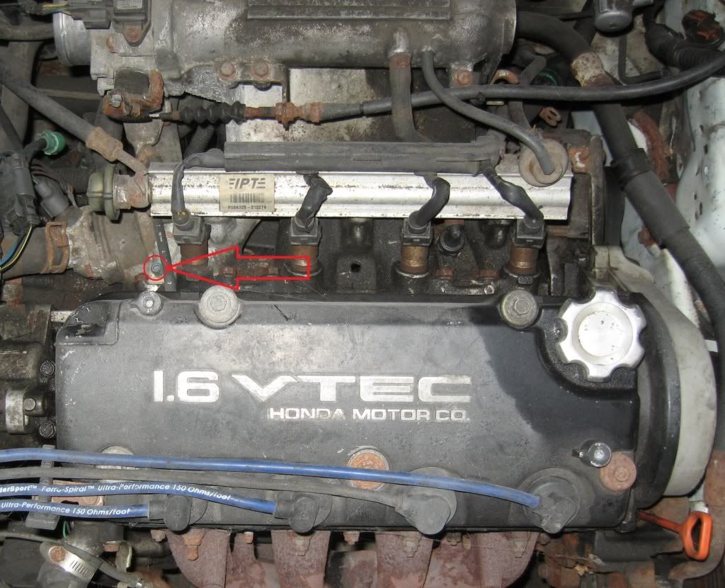

I have do a swap, a d16y7 into my 93 civic hb si, But i have a little probleme, i dont know where go the other side of the hose
(my english is not very good, sry i speak french i do my best ...)
I hope you can help me :D
#126777 holy rust :o
but is it a coolent hose or a vaccum hose?

#126804 I think prestone pass in this hose
When i start the engine i wait 1-2 min after prestone leak to this hole
I dont know where go this hose i have do the swap last summer i dont remember where go the hose
remember my english is not very good lol :D i do my best

#126811 I have a hose in the same place that isnt hooked up either, I dont know where is goes, it has a clamp so it did come off something.
By ThisEarl
#126816 Mine seems to be a vaccum line of some type, as in, its sucking air....
Its been like that since I bought the car 20k miles ago and doesnt seem to matter but I would like to fix it.

#126831 yeah u mite want to check that.. i looked at mine and it seems to hide behinda the intake manifold its either a coolant hose or vacumm hose..

#126866 it looks like the one that hooks to the intake tube an the valve cover :?

#126978 im not happy to said : last years i have try to put a bolt in the hose but after 10 min Powww the bolt explose out off the hose lol
Now i have to find where go the extrimity off the hose

#126989 it goes to the bottom of the throttle body.
but i can't see if yours has a nipple for it from that angle.

Anyhow look at the back of your block there should be a coolant tube black with some rust most likely unless painted....this should have 2 posts comming off with hoses going towards the intake manifold. 1 goes to the back Iac valve the other a bottom nub near where your arrow is....now from the Iac a line should run to your tb and a line from your tb should run to that nub where your arrow is pointing
hope that helps
