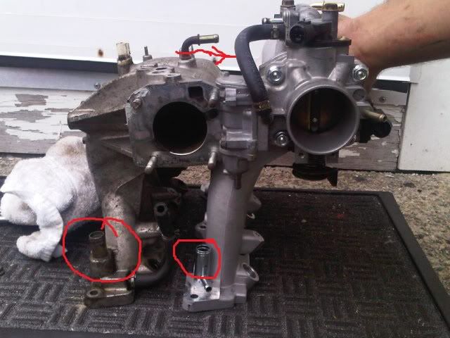

#281709
Check the Hose from the intake manifold on the left of it. it's about an inch thick..... if not your thermostat housing..
Look here.. the hoses attached here
