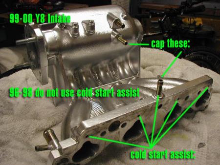

#44939 yep, mine is from a 99. 99-00 y8 IM's have cold start assist, so you have to plug the 4 tiny holes on the flange to use them on non cold start assist motors.
96-98 y8 IM's don't require that extra step.
