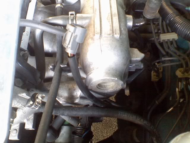

#71133 ok i found this sensor..an im trying to see where it goes
#71134 IAT sensor? standing in front of your car looking at your motor, reach around the lower back of the right side of your intake manifold.
edit- or does that have 3 wires? if so it's not your IAT. Is your TPS and MAP hooked up? Evap purge valve? have any check engine lights?
By Jadori
#71135 im trying to find it..ive been looking for about an hour..it has 2 wires..a red one and a yellow one with a black stripe no check engine light..well i got one once but it went out

#71165 yous missing apeice thats why there should be a lil black sorta vaccum thing hooked up to that sorta ledge in your pic there and thats where that plug plugs into heres a pic to look at
its the little black thing that looks like it has a cap on it. held in by one screw
By suspendedHatch
#71202 JDM motors don't have that. That's why he has that lip on his intake manifold but it isn't tapped for the screw that holds the evap purge solenoid. You'll need that for smog and it's also worth a few mpg. Get a vacuum t and t off the fuel pressure vacuum line to the manifold. That's the most common way. The cleanest route is to get a USDM D16Z6 intake manifold. It will have the vacuum port and mounting threads for that valve.

#71237
suspendedHatch wrote:JDM motors don't have that. That's why he has that lip on his intake manifold but it isn't tapped for the screw that holds the evap purge solenoid. You'll need that for smog and it's also worth a few mpg. Get a vacuum t and t off the fuel pressure vacuum line to the manifold. That's the most common way. The cleanest route is to get a USDM D16Z6 intake manifold. It will have the vacuum port and mounting threads for that valve.
woops did not notice that lol good catch though and thanks for the correction wondered why there was no hole tapped for the solenoid

#71253
Yup, that's what I am doing, got a Z6 manifold on Ebay for 8 bucks to put on my D15B
