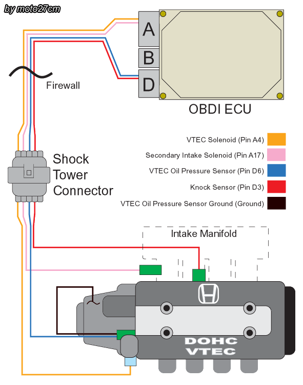

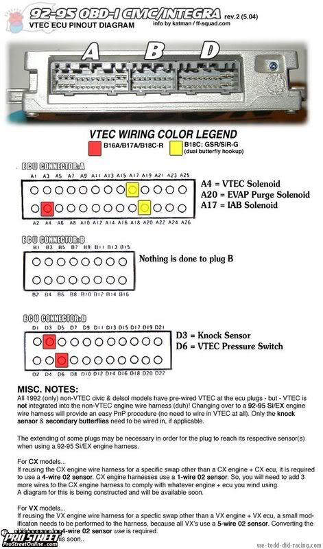

#71805 Ok i did some searching and found this.
Ok now which (on the solenoid itself) wire is the solenoid switch and which is the pressure switch? And i dont see a ground wire for the solenoid.
[EDIT] ok i found this also.
im guessing that it doesnt matter for sohc or dohc? i maybe wrong. Im going to check my car right now and see if i can find all of the wires and to which pinouts he ran the wires to. still need to know the colors of the wires themselves.
