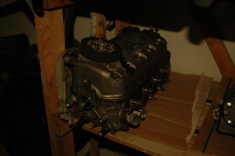

nah thanks but no thanks kinda made up my mind on this one i know the a6 head has great flow its just i really dont care lmao im going to be porting and polishing to give the y7 head better flow anyhow so i think that should work itself out in that aspect....but anyhow here are the pics i promised a day late but ohh well lol better late then never............
Y7 head with AEM trutime camgear that i got off of Dippin_EG

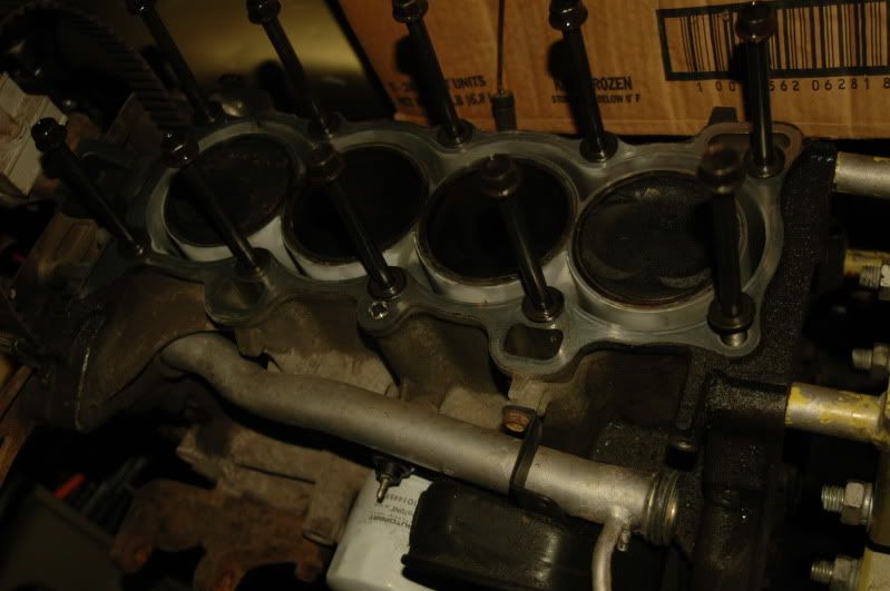

And the bottom end which will see a nice rebuild so as to make sure she will handle the powerr!

Are those OEM head bolts I see? *E-wrist slap* get some ARP head studs boy ... cheap turbo insurance ... cheaper than having to replace head gaskets anyway.
