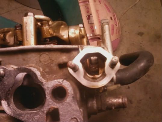

#175457 That d15b non vtec bottom end is what Im using and the head that was attached had that same hole with a block off plate. I was told it was for emmissions regulations for japans carbureted version . Heres a pic of mine .
