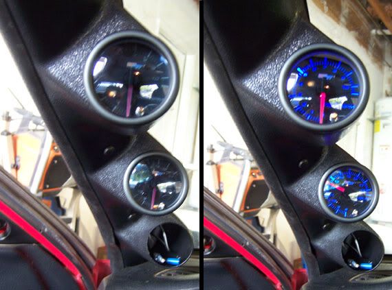

i put in a tripple gauge pillar and a couple gauges today. i put in a tach and a voltmeter. this car only came with a speedo, fuel, and temp cluster. so now i am able to see what im idling at. when its cold it idles around 1500, when its completely warm it idles at about 600. are these numbers ok? i was watching my rpms and it seams like i dont get any acceleration until i hit between 2000 and 2500 rpms.
here are pictures of my pillar and gauges. powerd off left, powerd on right.
im not sure what my 3rd gauge should be. i was thinking about putting a fuel pressure gauge in there. what do you guys think is an essential gauge to have?

#219201 Nice gauges!!1
Nope 600 too low. u want atleast 750-850. go to the throttle body and on the top part turn that flat head idle adjust srew to the left to raise the idle a bit.

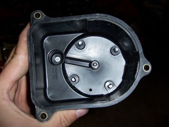

take your cap and rotor off and look at it if it looks fowled then change it
take pictures and show us what you find

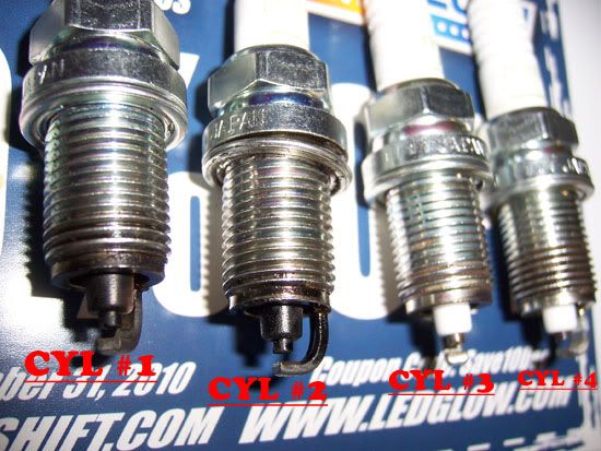

when taking the spark plugs out to do the compression test, i noticed something that seams a little odd to me. i just put brand new NGK spark plugs in. they probably only have about 10 miles on them right now. but when i pulled them out, this is how they looked....
cylinders 1 and 2 look like they have a lot of miles on them, but cylinders 3 and 4 still look brand new. i checked the spark on each plug and from each plug wire, they all sparked just fine.

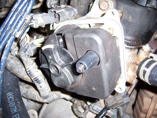

i took the distributer cap off and the first thing i noticed was that there was about a 1/16" thick bit of corrosion on each stud. so i cleaned them all off. other than that the distributer looked fine.

#219231 Damn definately soething is happening alot more in CYL 1&2. hmmmmm Did they smell like gas at all??.. :?

#219338 hmmm i didnt think to smell them when i had them out. they look like they have burnt oil on them. but i put all new gaskets on everything when i changed the head gasket, so it shouldnt be leaking any oil into the cylinders.

what are some symptoms of your timing being off? when i changed the headgasket i took the distributor off and forgot to mark its position, how do i check that its in the right position. i pretty much just had the car running and moved it around a little each direction until i found a spot that sounded like it was idling the best.

on your top dizzy mounting post you should see a small ingraved horizontal line ad a matchin one on he dizzy. those should match. to bring it to proper timing at th dizzy..
