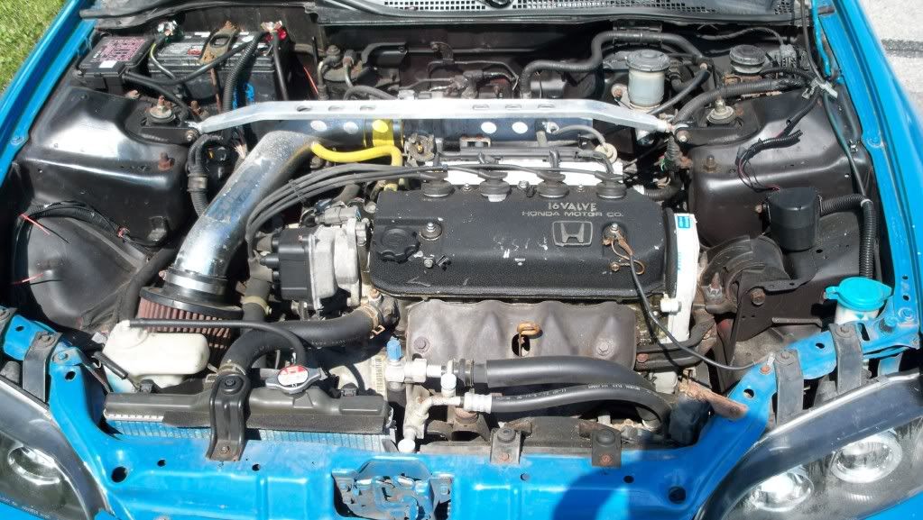

#173481 hey guys i was brushing the snow off my car today n open the hood to make sure nothing was living in there... i looked at the block to see what d motor was in there the stamp said D15b.. now i have looked around and there are so many differt types of d's.. my question is what one is this? :?
thanks guy's

#173551 Its a d15b non vtec . Where exactly is it leaking from ?
By {ikon}EM1
#173556
breez wrote:Its a d15b non vtec . Where exactly is it leaking from ?
d15b theres vtec and a non vtec. 3 kinds of usdm non vtec, and obd2 2stage vtec.obd1 is just like the z6 with a 3mm difference in piston clearence and has more aggressive cam.

By breez
#173560
d15b is the same as the usdm d16z6 it just has more agressive cams... so it has vtec
Yea it is but clearly in his pic the spark plugs are on the intake side of the valve cover soo.. that would make it non vtec. Not to mention there is a non vtec d15b found in 88-95 civics .

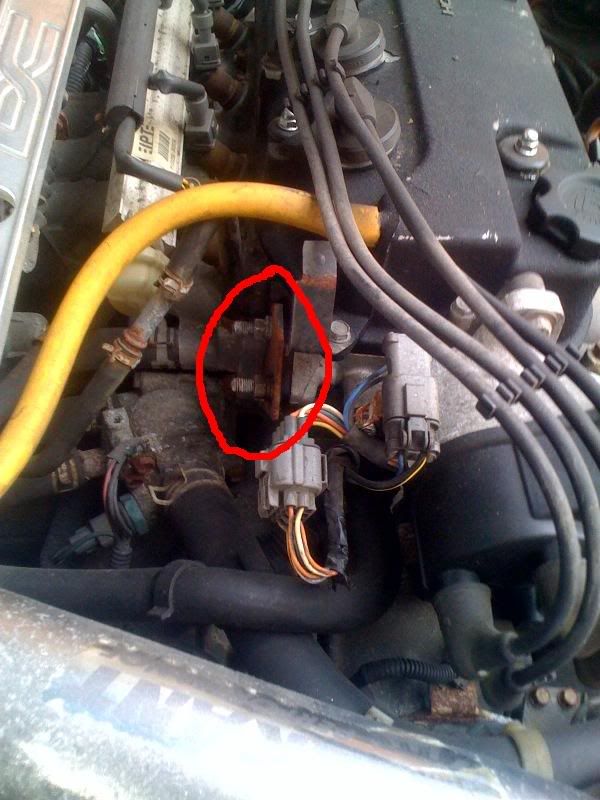

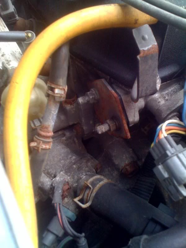

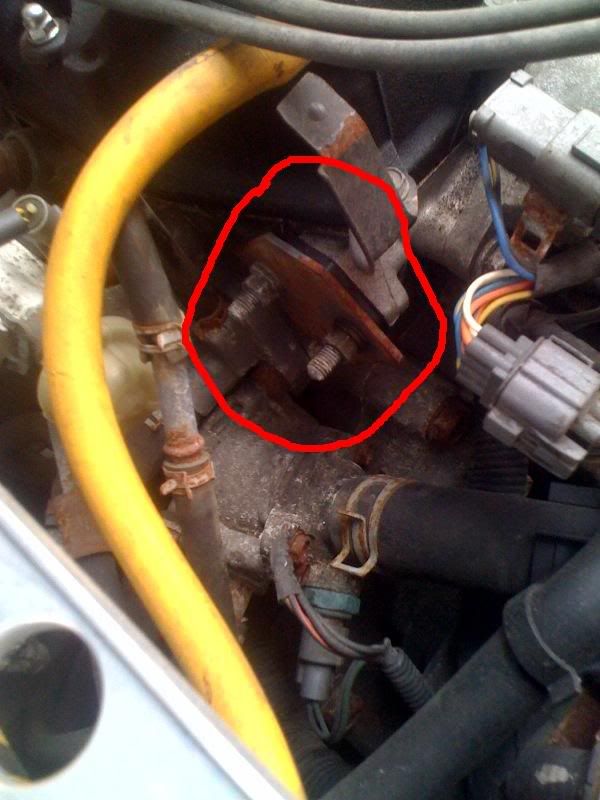

By nickplus4
#175287 whats is it plate?? what goes there
By MG6
#175356 it looks like the v-tec location?
By nickplus4
#175359 Ok why would anyone block it off? And what's gonna happen if I put one on?
