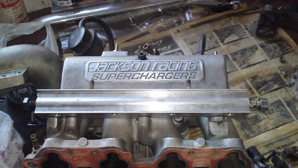

ok so you you looking at doing a engin bay tuck. and you want to move the fuel line from the left to the right. (you can go out and by an after market fuel rail - but here in SA the cheapest is R1500 plus, im not paying that)

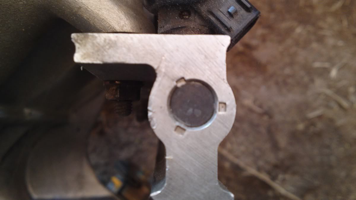

first remove the inlet from the rail(just unscrew it). you can use a screw driver or some thing else strong that will fit. i used a puntch as you can see below

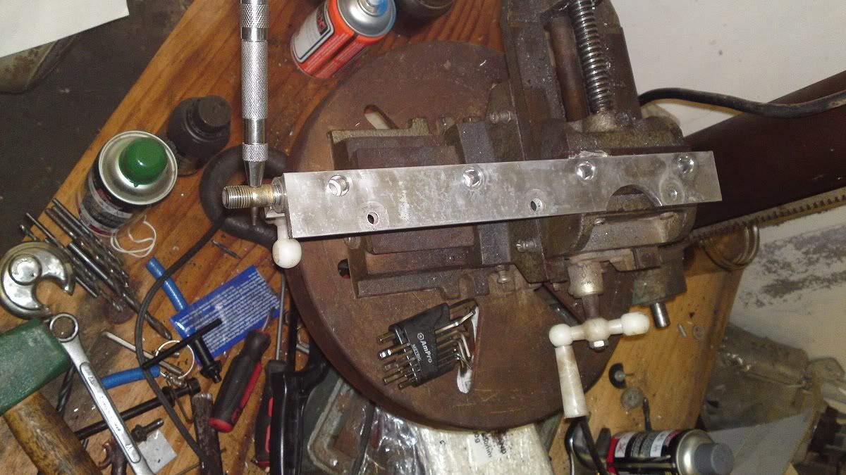

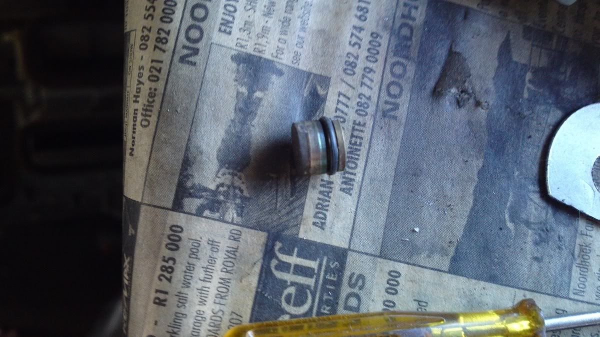

next is to remove the stopper on the other end.
I took a long rod about 10cm long then the fuel rail, and just gave it a tap with a 5pound hammer lol. it popped right out...

once the stopper is out drill the hole out to a 10.5mm diameter and and 5 -10mm deeper.
then tap it with a M12x1.25 tap. re-fit the inlet tighten it down. then just block off the other end with a bolt of the correct depth and thread.
then you done.
i have just finnished mine i still need to clean it and test that is does not leak.
