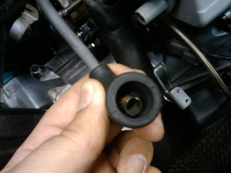

So before you do all that, adjust the crimp on the end of your plug wire :thumb:
whoops :lol:
The metal clip inside the spark plug wire boot is probably smashed. Or you're using cheap wires.

#244925 Yea might be cheap wires...

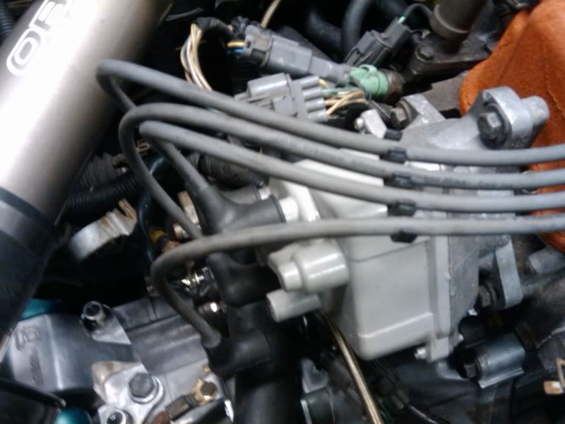

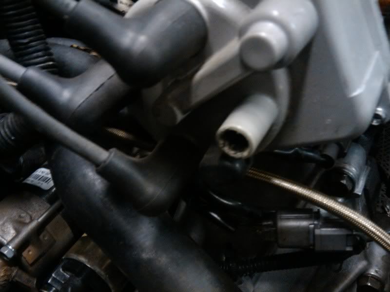

this is what things looked like wen i looked in the engine bay that night..
