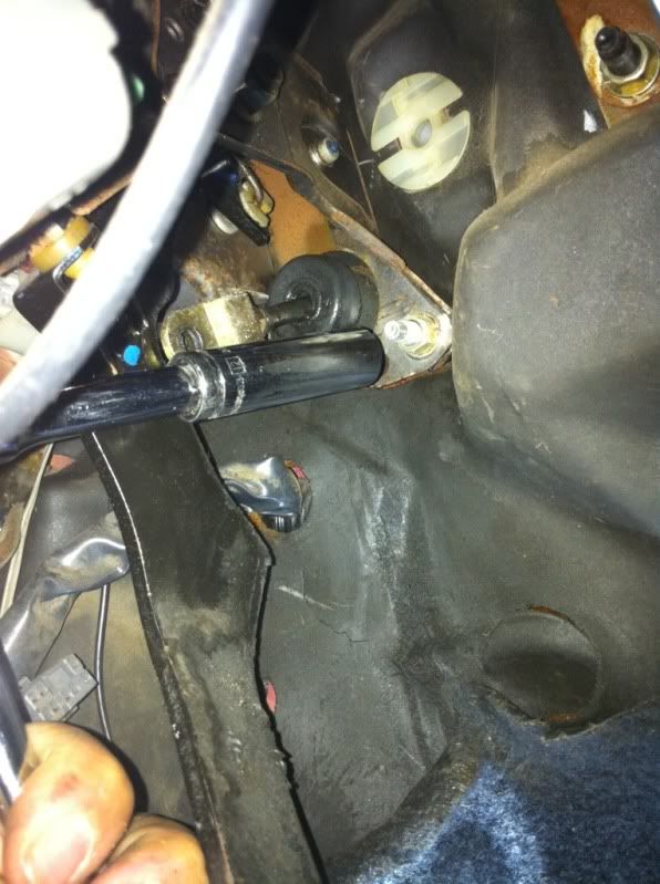

then unscrew the 2 bolts holding it to the firewall theyer 13mm and very uncomfortable to get to
I had trouble to get to the other side so I used on of these
