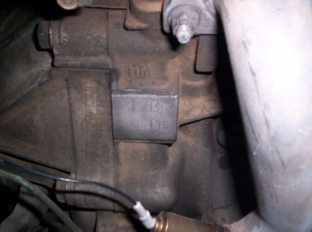

#248935 okay here are a few pics to help. one is to show engine overall, one shows D15B code on block, one shows the two bolts coming out of the block (where i think the egr valve MAY go??) -underneath the blue cables, and the other pic shohs the pcv valve and location.
is this a typical D15B engine? does it have a swapped head? let me know what you guys think.

#248959 The head is a non-vtec head (looks like a d15b7 head) on a JDM D15b block
THere are also non-vtec JDM D15B's so maybe that's what you have.
Swapping this motor into a EX model originally equipped with a D16z6 vtec engine is a step down. The previous owner must have wanted to get this car running as cheaply as possible.
EGR valves are always on the intake manifold (that I have seen) so that block off plate is not for the EGR valve. The area where that plate is attaches is normally where the vtec solenoid would go on a vtec head. Strange that it is there...

I'm not 100% sure about that bottom end... since there were both vtec and non-vtec versions of the jdm D15B, the non-vtec version may have slightly smaller bearing journals and thinner rods, similar to our non-vtec D15b7. So putting a JDM D15B vtec head on that block may not mean you would have a full JDM D15B Vtec motor.
The thing with the block off plate is that this head never had vtec, so there should be no reason to need a blockoff plate. Non vtec heads just have a blank area in the casting, there are no oil passages for the vtec solenoid.
If you bought a vtec head, it would come with the vtec solenoid attached in that spot where you have the block-off plate (unless someone removed it previously which usually doesn't happen when buying a used vtec head)
So you could put a vtec head on and have yourself a mini-me swap. Since your car is an EX, the wires should already be there.
I'm still interested to know why that block-off plate is there... :?
I see you have a 1-wire o2 sensor as well. Those only came on the civic CX I believe. Your engine is a true mutt! What ECU does the car have?

#249404 That's a non VTEC OBD1 head. The spark plugs are on the intake side. All OBD2s and all VTECs have them on the exhaust side.
On some of the import non VTEC D15Bs, there is a blocked off VTEC solenoid port for some reason. That one has been tampered with. Some idiot probably took it off and tried to put a VTEC solenoid there. That will not work. The solenoid is one small part of the system that makes up VTEC.
You need to get a P06 ECU and then check the ignition timing. Looks like you also need to fix your throttle cable and bracket.
