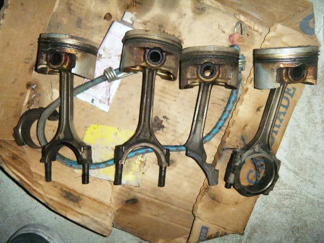

#275850 i bought a bare block for my cousin when his 96 civic ex motor blew. we were thinking of overhauling all parts into the used block but his rods where burnt and one was gone shreaded btw pistons r still good.

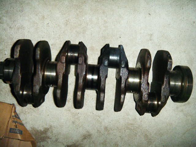

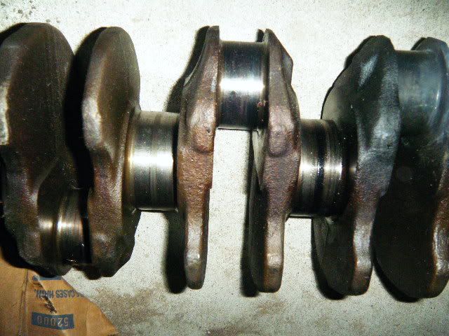

civic eg-k wrote:what about crank? is it the same from the z6? because the crank is fried from the piston where is was riding. ill try and post pics of the damage lol

#276173 another y8 with a spun bearing, why am i so not surprised?
you will want another crank and 4 new rods.
just curious, how many thousand miles was it driven with the rod knocking loud enough to wake the dead?

#276188 the cluster said 200,xxx but its his fault cu never checked the oil and never took the time to take czre of shit. mest up part is he lend to a friend to go up some national park and said motor had lost power got the car home and then my cousin drove it again and he said he heard a poping sound (rod) lol. end of story.
