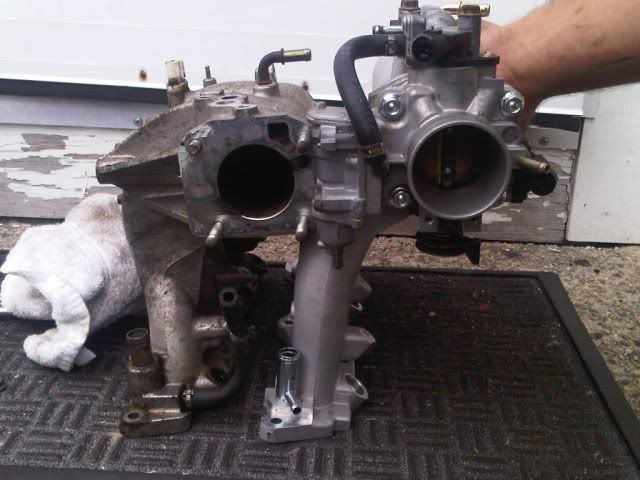

#279998 i think the most you can go on a Z6 manifold before you start cutting into the IACV entry port is about 60-62mm if i remember correctly.. it's like 56mm now. ill try and snap a picture.. actually look here .
compared 56m to 68mm

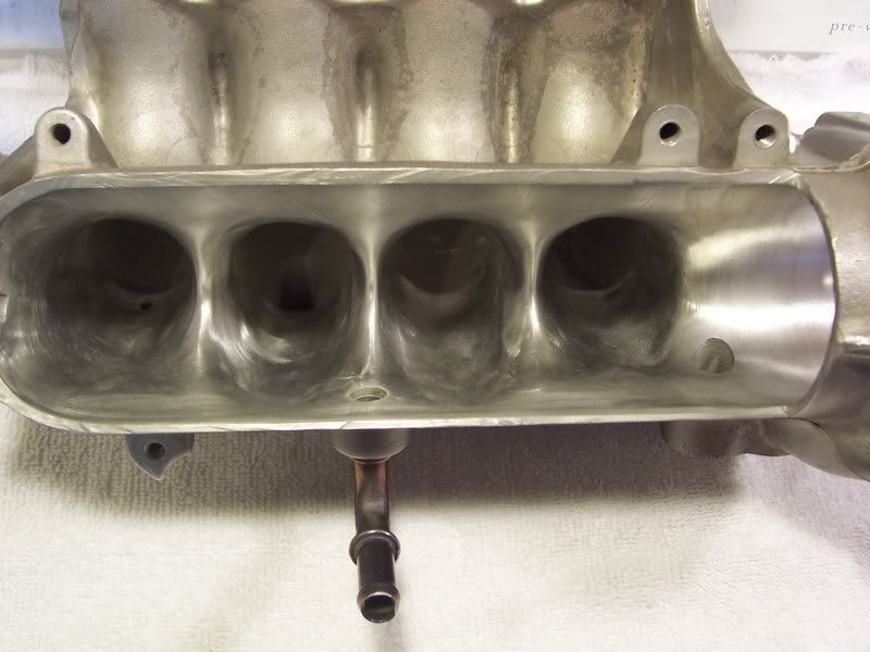

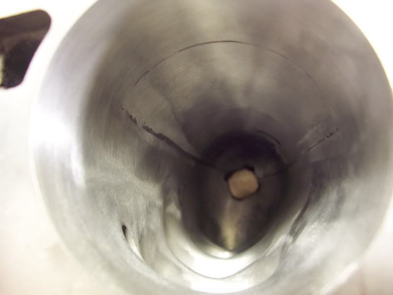

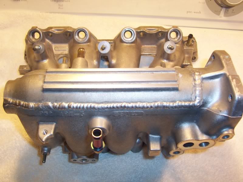

#280048 There is no need for a bigger throttel on D16z6 56mm is perfect. What you can do is open up the IM to 60mm so you have a anti reversion stepp of 2mm to the TB.
You dont whant to port match your runners to the head!!!!!!!!!
best thing is to leave a stepp of 1mm allaround to the head -> smaller runner transists to a bigger head port.
You can cut the plennum open and smove out the transistion to the runners to gain a better flow.
