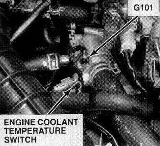

On the thermostat housing is a swtich (it says engine coolent temp. but that is incorrect)
Ok with the key on engine off.. unplug the harness from the switch and jump the harness like this
what this does is test the relay,fuse,fan and the fan swtich itself
so if you jump the harness and the fan kicks on then you need to replace the fan switch..(you will hear the relay click)
if the fan doesnt kick on check the fuse and the relay if both are good(fuse just pull and look.. you should hear the relay click when jumping the harness) then i believe your water pump maybe bad or bad wiring somewhere
i hope this help!

94_jdm_ferio wrote:On the thermostat housing is a swtich (it says engine coolent temp. but that is incorrect)
i hope this help!

i dont believe its your thermostat.. but you can always take it out and put it in boiling water.. when you do that you should see the pintel move, which means its good
but 1st check the fan switch.. its real esay like 5 mins max
keep us posted :thumb:

x2 the fan switch is cheaper to replace and its easier to check with a paper clip. if it was the thermo you would be over heating on the highway. so its more the fan or switch.

Probably both.. and u unclip the connector
