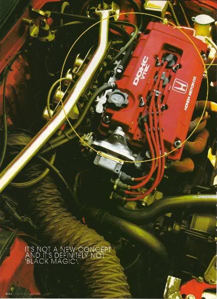

#51398 In SA a popular ITB swap is taking the 20V's(sold as the corolla RXi) ITB's and droping them on ur car as they are cheap(R2400/$375 vs Jenvey R8000/$1000) and all u need is an adapter plate/manifold, if its got the plenum some trumpets and EMS.
There is a guy Jakes(JDMtuning) that specialises in b-series and k-series swaps and rates these ITB's on the 1600's). I posted pics of a light metalic blue/green EG sedan with the EK cwest front and his first setup was 20V ITB's on his B16 and ran a 15.0s 1/4 mile.
the trumpets have a plate on them for the foam filter
Here u see lots of guys with out filters but the other half run either induvidual cone filters or put a foam filter on.
