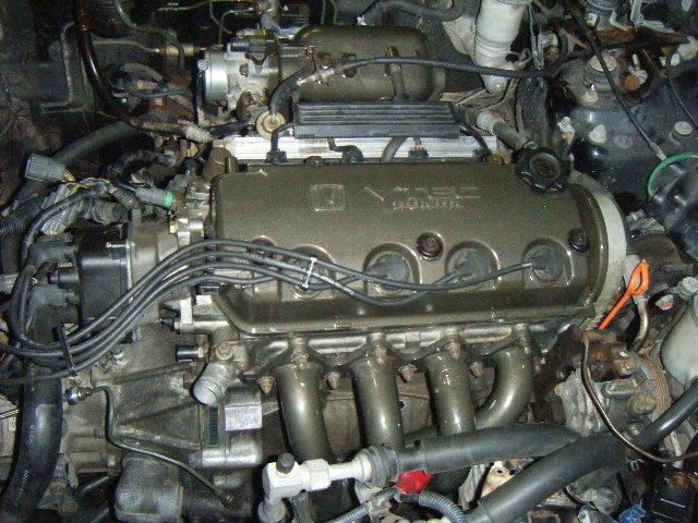

#99421 Here is the picture. Don't mind the mess..work in progress. Image
By suspendedHatch
#99481 I am ALWAYS a smart ass. SOMETIMES I even know what I'm talking about.
Well, that's a D16Y8 intake manifold and a D16Z6 valve cover. OBD2 injectors, OBD2 distributor plug, OBD2 oil dipstick. No EGR so it's not a Y5. What troubles me is that it has a VTEC pressure switch on the VTEC solenoid. That's not JDM. Looks like a normal USDM D16Y8.
What you need to do now since you know so much about cars is look at the engine stamp. Maybe pop the valve cover off and take a close up of the valve train for confirmation.
