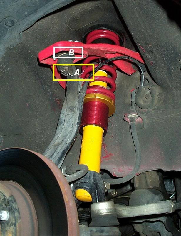

Pass axle went in with no problem at all. moved onto driver side installed it got it into hub and went to rebolt A and B (see pic below not my car but same setup) together and it wont even come close almost like the axle is to long its way off. the axle is all the way in the hub wont go anymore. do i need different axles? is it one of those just go back to it tomorrow and it will just pop in lol

The D.side axel is well not sure....id say go from the intermediate shaft first, then the axel should go into the hub and you should be able to get it on there....However if that still dosent work id suggest taking the axel to the auto parts store and compare the length it should fit if its from a 94 ...

The cv axle for the driver side, is short and mates to the half shaft. then the half shaft mates to the tranny. You got it in the Spindle, but is it in the half shaft? all the way? is the half shaft all the way in as welll?

#176353 well i figured out the axels lmao i was trying to use abs axels when my car is non abs. car is on the road now just needs exhuast work.

when i swapped my b in i had the same axle problem your gonna have to put the cv in the halfshaft first then the hub... further disassembly required, unfortunately.
