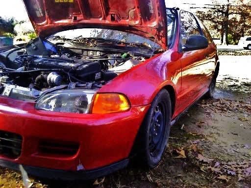

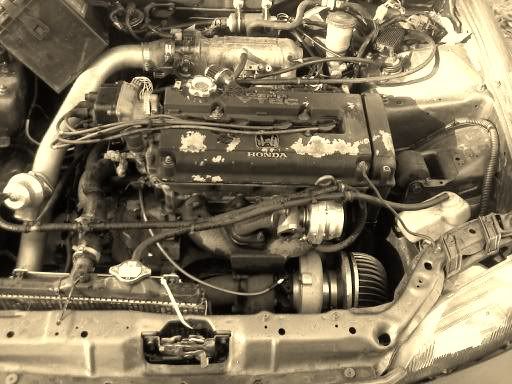

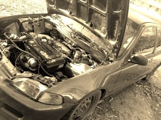

#229617 As the title say's, I have a 94 hatch with a b20 vtec turbo, I'm tired of throwing parts at it and ready for some help....
I can walk outside right now and crank the car, it will start and run for about 2 seconds, then die....NO CEL'S....Checked fuses, I can hear the fuel pump coming on and all of my plugs have a spark.
I've read alot of other forums with people having this problem but no real answers to why it doing this. Some say its the timing, some say its the main relay, others say its the dizzy.
I don't think it's the timing because the 2 seconds it IS running it sounds good.
If it were the main relay, it wouldn't start at all, right?
if it were the dizzy, I wouldn't have spark, right?
Please any help would be appreciated, I'm ready to drive this thing!!!
Here are some photo's to look at while you think!
