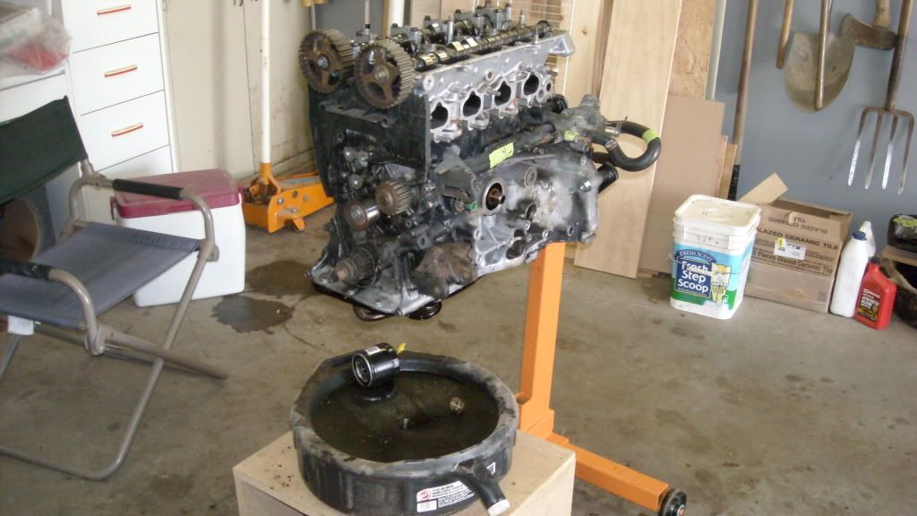

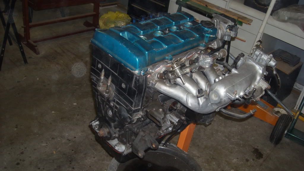

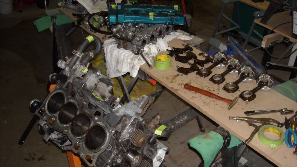

#72510 some info on it: engine was $200.00 the drive was 10 hrs (round trip) 120,000, from a 92' teg. may have a spun bearing, and the head has been milled .020",
Im going for skunk2 cams, valves, and springs, and if i can still afford it, TB and intake manifold. Forged Eagle rods, SRP pistons. The Boost will probably be a junkyard / Ebay setup while i figure out how to tune it and save more money if needed. I was gonna bore it out to a 2.0, but then I thought the pistons would've been more expensive and may have run into cooling problems... im keeping it simple.
thanks for the feedback guys, I'll keep this updated as it moves along

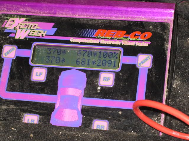

(ps anyone know why the weight is so far off from side to side?)

#130219 I would say the 670 and 680 are the front wheels not the right side.

#130427 ya i figured that out once I searched for cams that were for my head, i was thinking rocket motorsprots or crower's cams. as far as the weight, I "trusted" that the scales were put in the correct slots, but i cant say for sure because i never checked. it was really to just get a benchmark weight before i start gutting it
