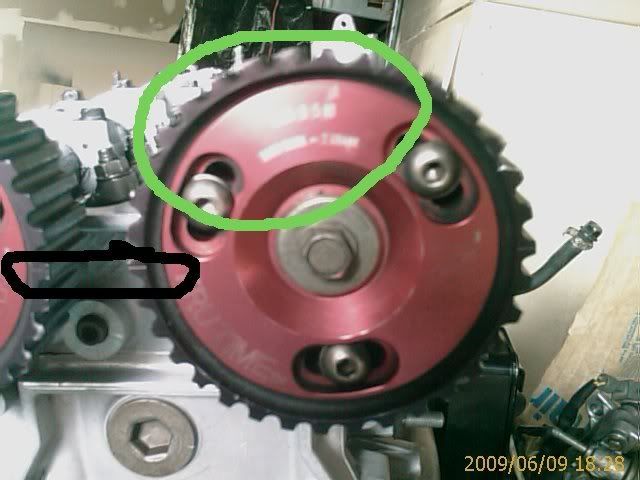

#122079 ok here is a pic. i think i got it right. i found a diagram on the instalation. there is a hole on each camshaft that will line up with the holes on the #1 cam caps. and that TDC. so the timing marks should have the 0 face up. :thumb:
#122104 Image
black circle:
those marks need to line up flat. that shows that both cams are set right. As long as both are at zero.
Green circle:
Set zero straight up, just like you would the "UP" on the stock gears.

#122129 ok so then im on the right track. the zero is up and the notches in the black circle need to line up toward eachother. ok sweet. well i just got a call from a guy that has all the remaining parts to get my swap done :woot:. well it almost done. i so cant wait to get it in and see if my hard work has payed off. :thumb:
