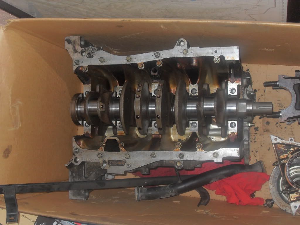

My engine block (B18A1) and crankshaft. The block came with the rear main, front main, water tube, main caps, and the crank pulley.

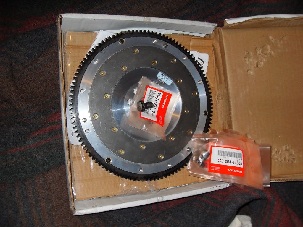

My Fidanza 7.5# flywheel. It is sexy. And the engine revs like a mofo.
